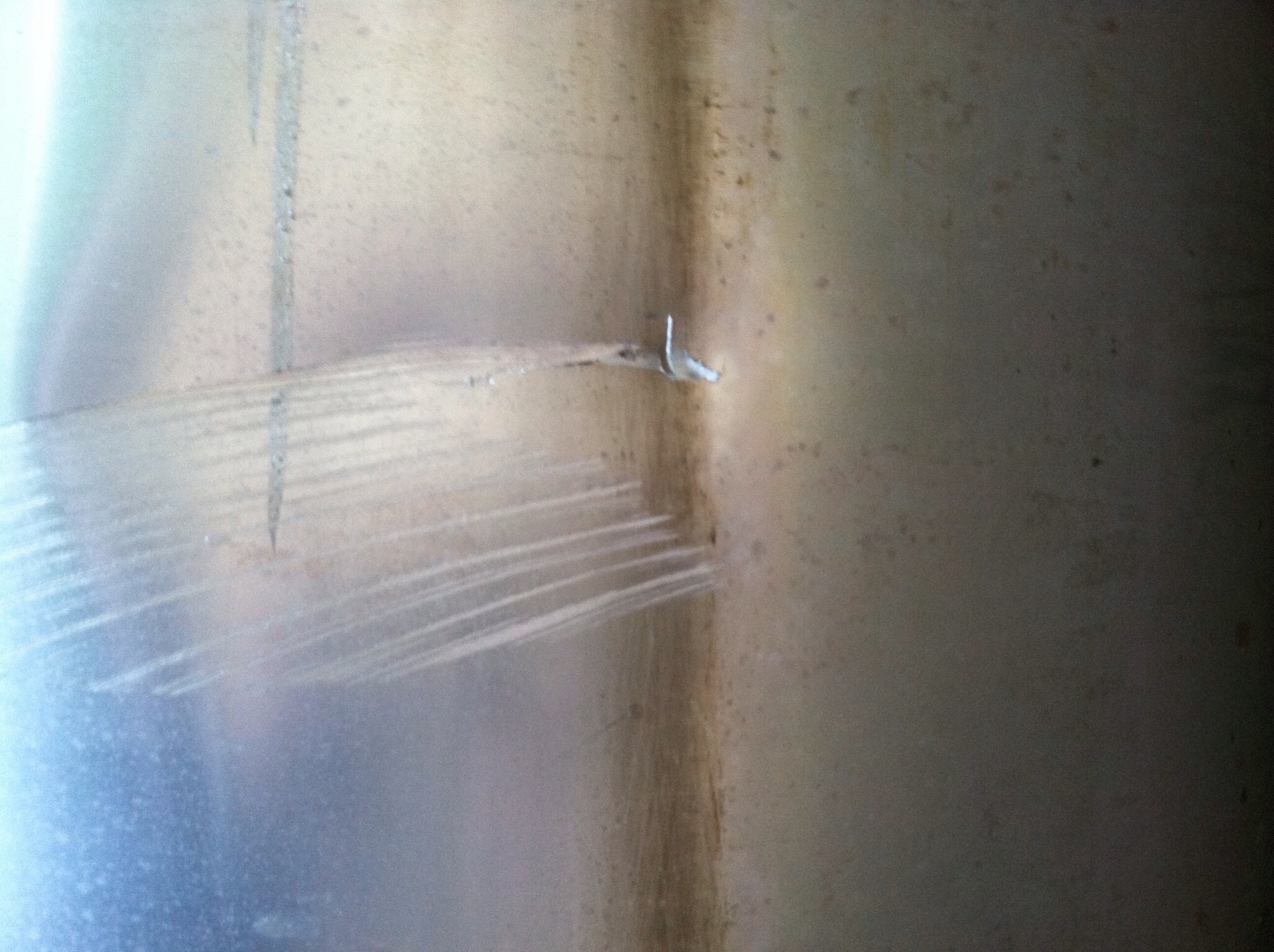

Ok, it'll be obvious quickly that I have no experience in welding, never mind welding aluminum.
I stored my new pontoon in my 24X36 garage (I know, never big enough) along with my tractor this winter. Two weeks ago when I was grabbing my rake sitting on the tractor to go down and work along the road, the rake slipped and pressed the outrigger lever, without me knowing and while it lowered, it scraped the tube on the pontoon store along the side:mur:
I thought it was a dent and a small scratch but when I finally got my buddy's scissor trailer to get the boat in the lake today, pulled it out in the light and noticed it was almost through the tube.
Not sure why it's loading horizontal.
So, although it looks like the line is a cut through the surface, it is a deep scratch.
Finally my question: Is there an easy way to fill in that gouge without bringing it to a welder? A simple weld and grind?
I was hoping to get in the water ASAP and bring back his trailer.

IMO It isn't a hole so you should be good to go. If you want to fill in the gouge to make it look good take it to a Pro who can weld aluminum to repair.
/ Aluminum boat weld question #3
use "marine" resin ... sand the surface to clean and give it a tooth , apply just enough resin to fill in the deepest part of the gouge ... put a piece of clear plastic wrap over the resin and smooth it out ... after it cures, remove the plastic ... go boating for the season
think about doing a full repair later, at the end of the season ....
/ Aluminum boat weld question #4
is there a hole ?? if not,, there you might try bondo or a similar product. you may have to build the area up by welding
/ Aluminum boat weld question #5
This is the perfect job for aluminum brazing rods.
You can fix a hole in a beer can with those, and a propane torch.
They sell them everywhere.
Here is one version: Aluminum Welding Rods - Pack of 8 Low Temperature Rods
There are lots of video's on how to use these on the internet, you should watch some of them before using.

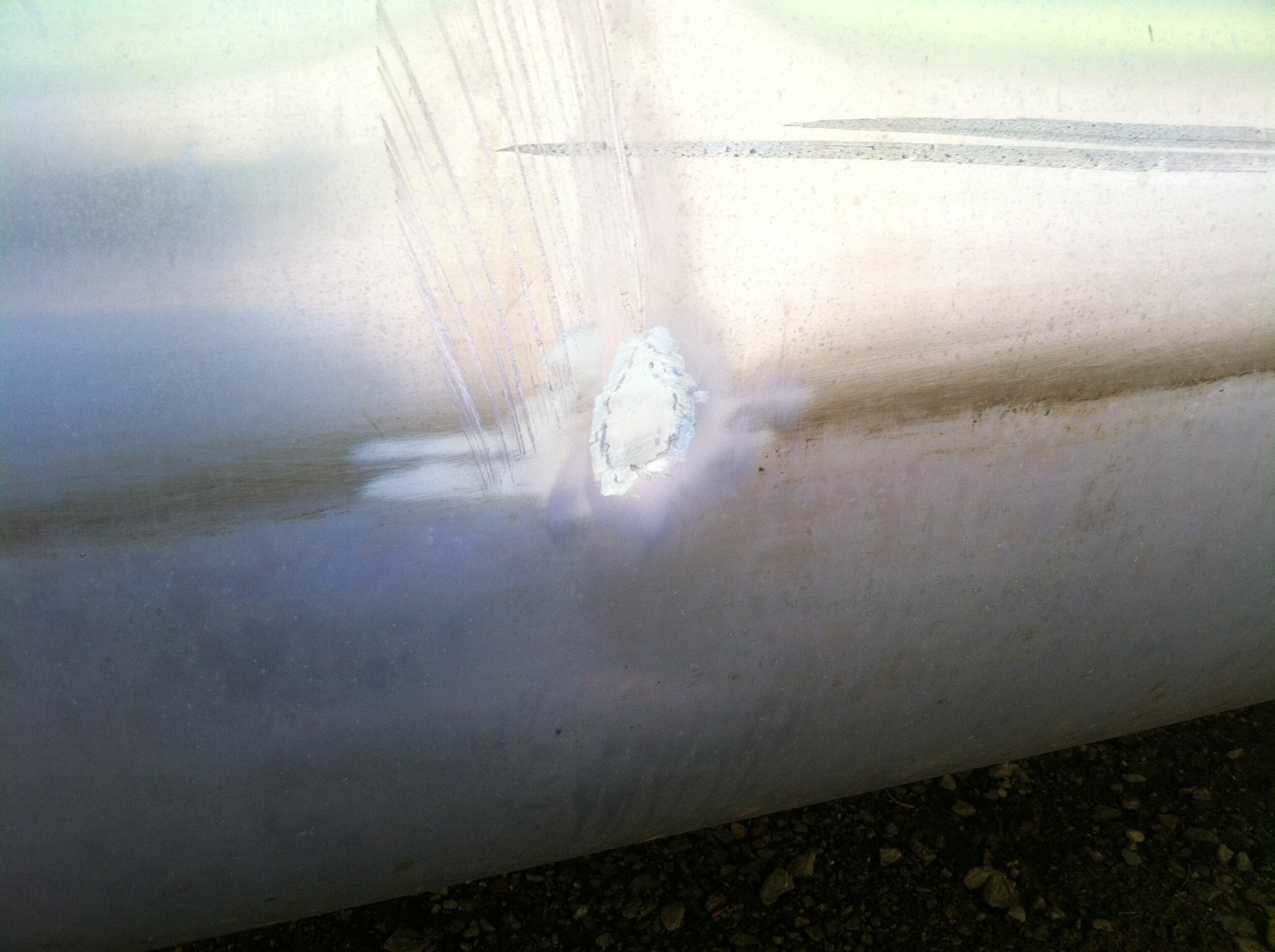

Hi guys, before I read any of the late sat night or today's posts, I ran to e Depot and bought the blazing rods Ray spoke of. You can see the photo below what it looked like before I started.

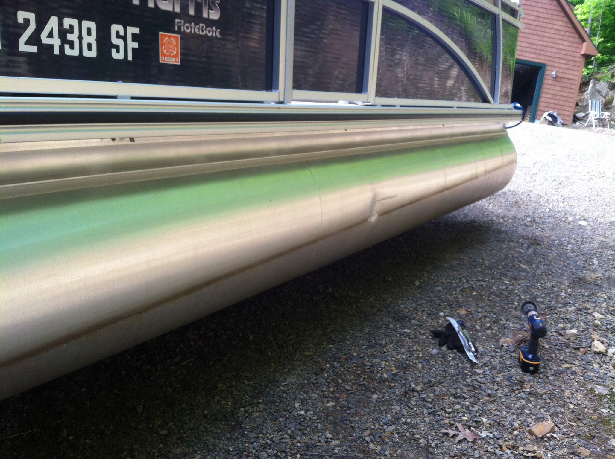

I brushed it clean an started to what it up using my plumbers torch. It was taking what seemed like 4-5 minutes to get the area hot enough to start to melt the rod and then because it was a vertical area, the material wanted to run down and puddling below the gouge. I used about 2/3s of the stick and then started grinding it down, see below. I got it fairly smooth and will reacess it in the fall when I pull it out for the winter.
Thanks for all your suggestions and if it looks like it needs a pro's touch, I'll hope that what I did will not make it tougher to repair.
I'm still ticked at myself for doing this to a less than a year old boat.
