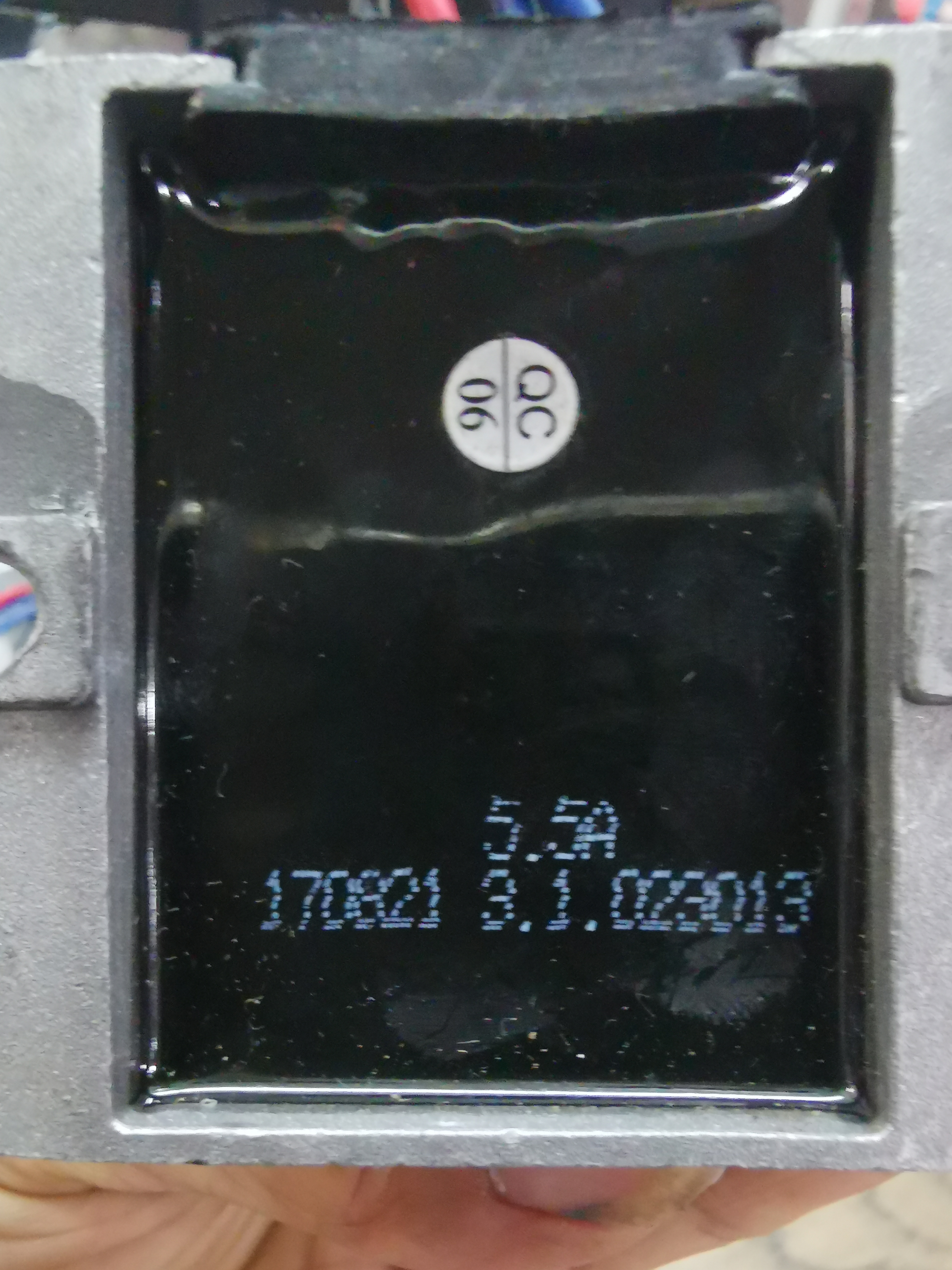

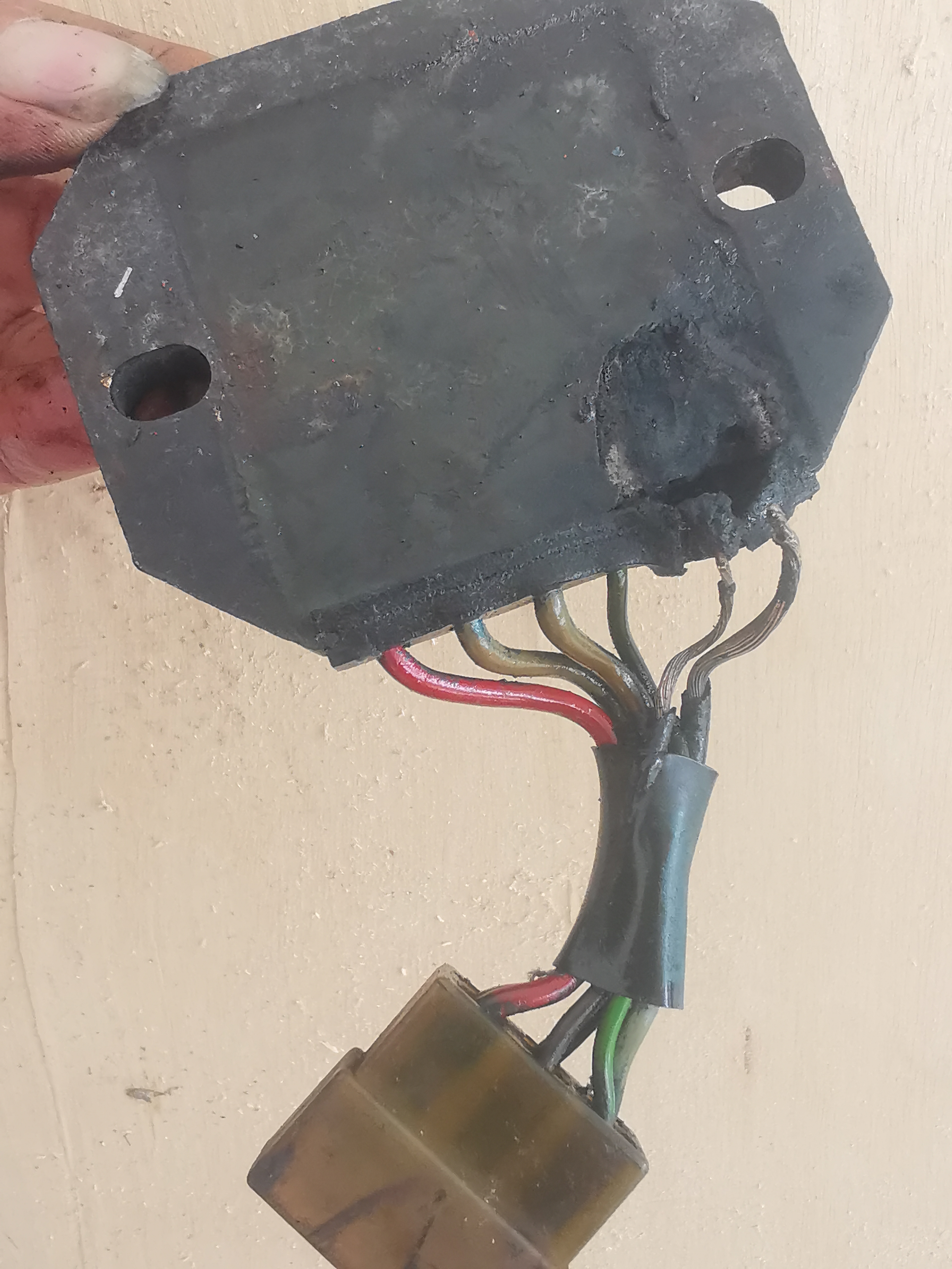

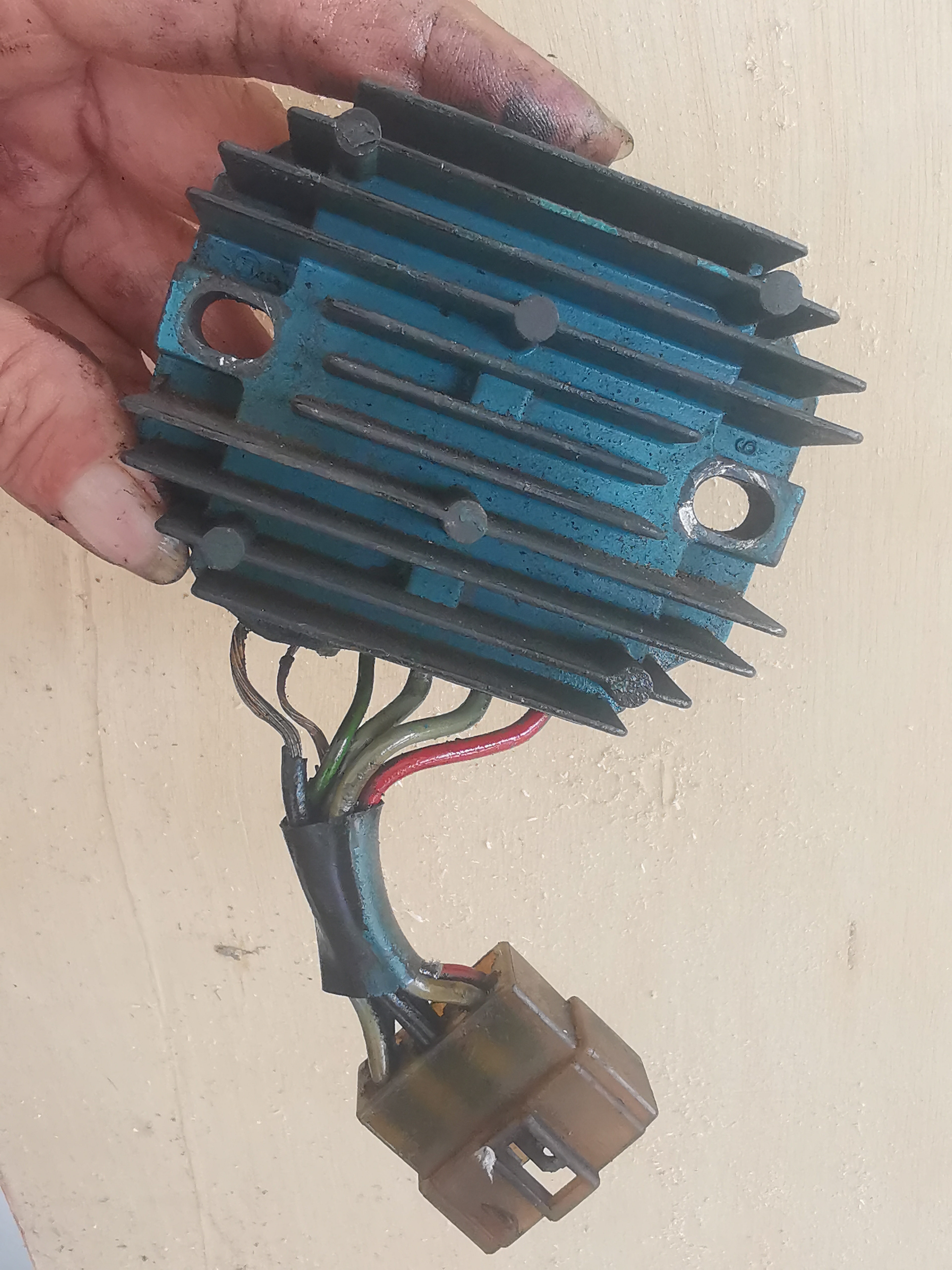

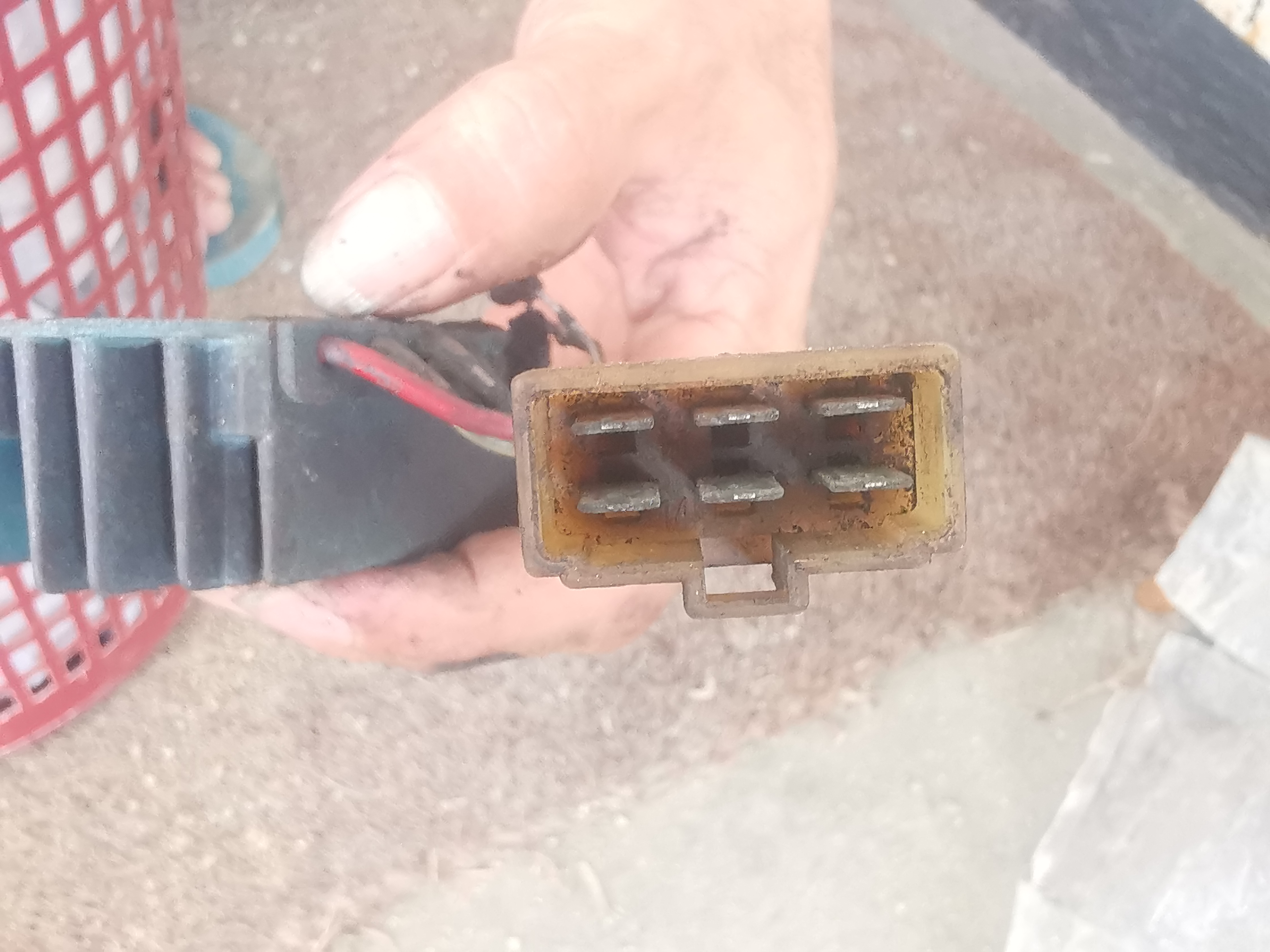

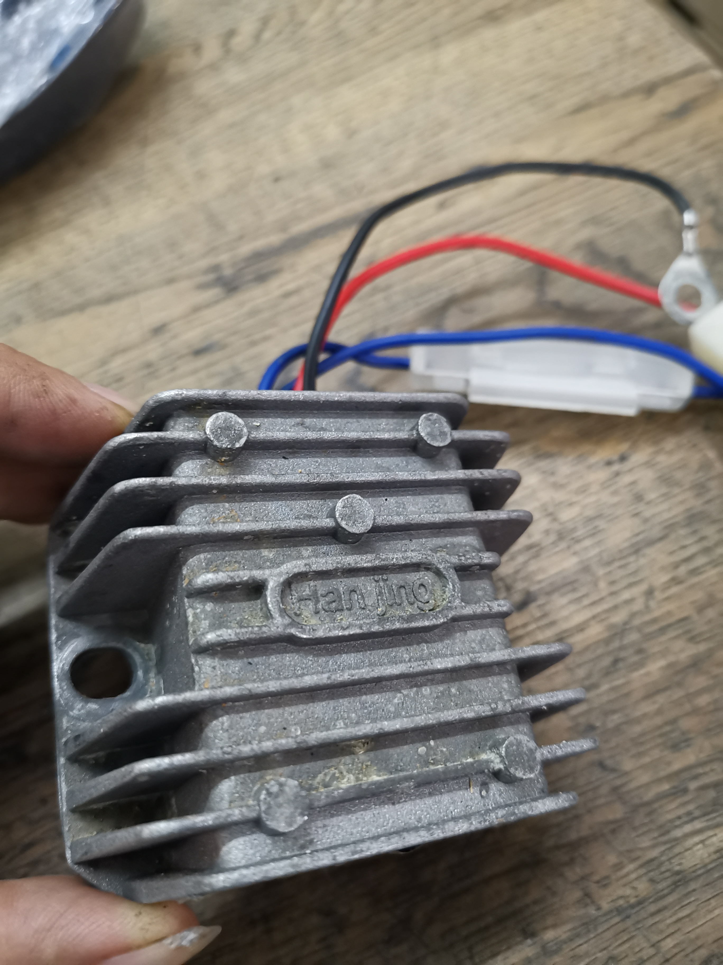

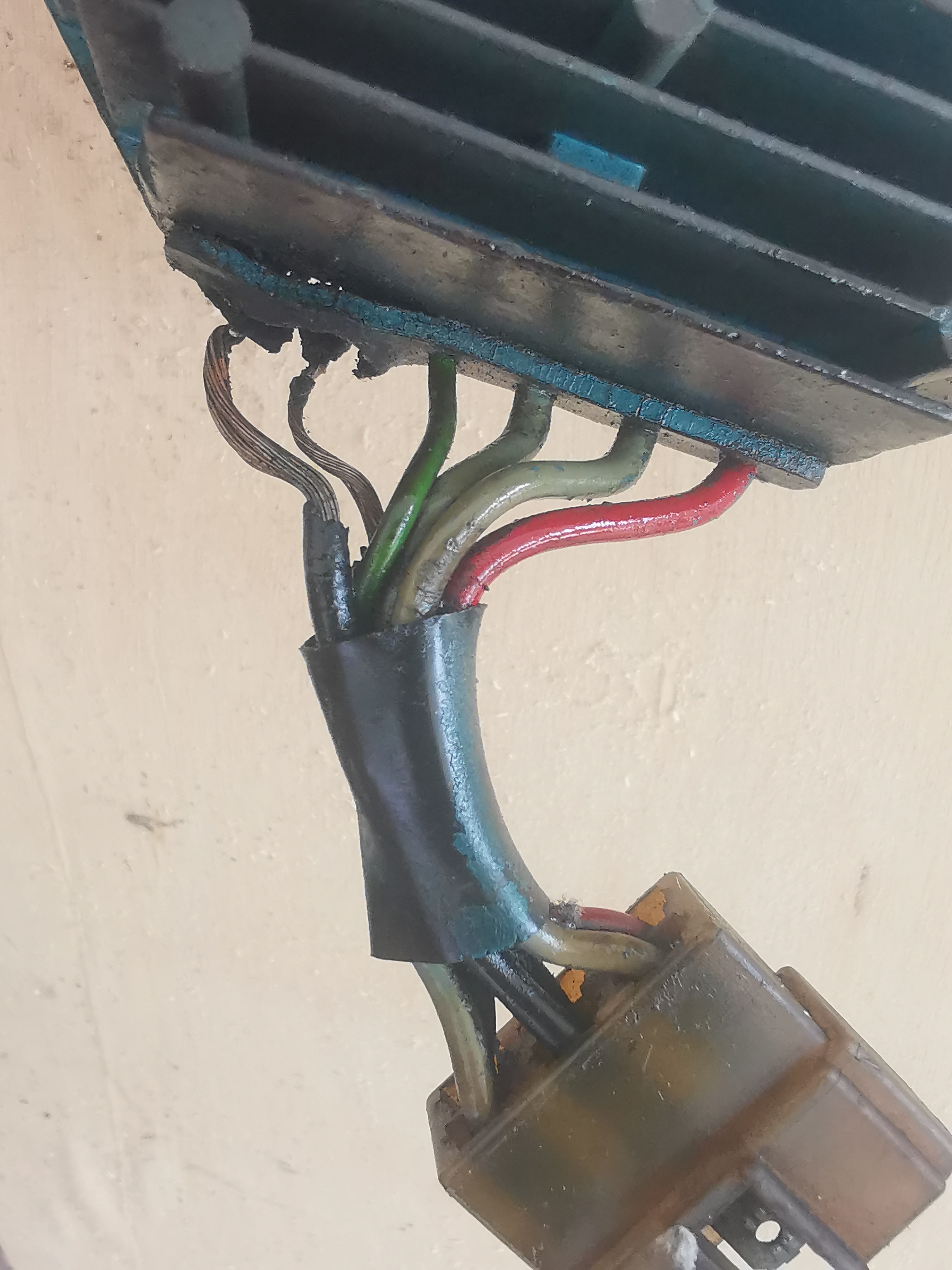

Hi folks,
I was using our ihi mini excavator and started smelling burnt rubber. Sure enough, saw smoke coming out of engine bay. Opened up and saw the CDI (i think that's what it is??) wires melted. The engine is a DY27 diesel engine, and I cannot find the same part anywhere in shops around me. The spare parts store showed me an alternative that he said I can possibly use with some reconfiguration but it only has 4 wires (the one that burnt up had 6 wires).
Is it possible to rig it using just 4 wires (last 2 pics)? Thanks very much in advance for any suggestions/ideas.

Charge regulator?
/ Alternative CDI for tractor using Robin DY27 diesel engine
Charge regulator?
hi Agvg, I'm actually not sure what it is called. Is that what it is? A charge regulator? If that's what it is, do you think I can use alternative?
Thanks for looking at my post, much appreciated.

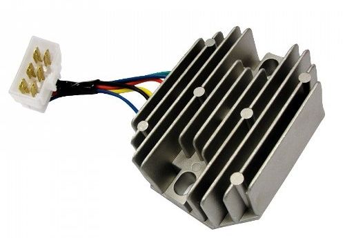

Charge regulator?
That's what I was thinking as well. Looking a the colors as much as you can tell they seem similar to this:

It was still running when smoke & burning smell came out ... and I quickly stopped the engine & check, that's when I saw the unit was burnt (actually smoke was also coming from the excavator control panel area).

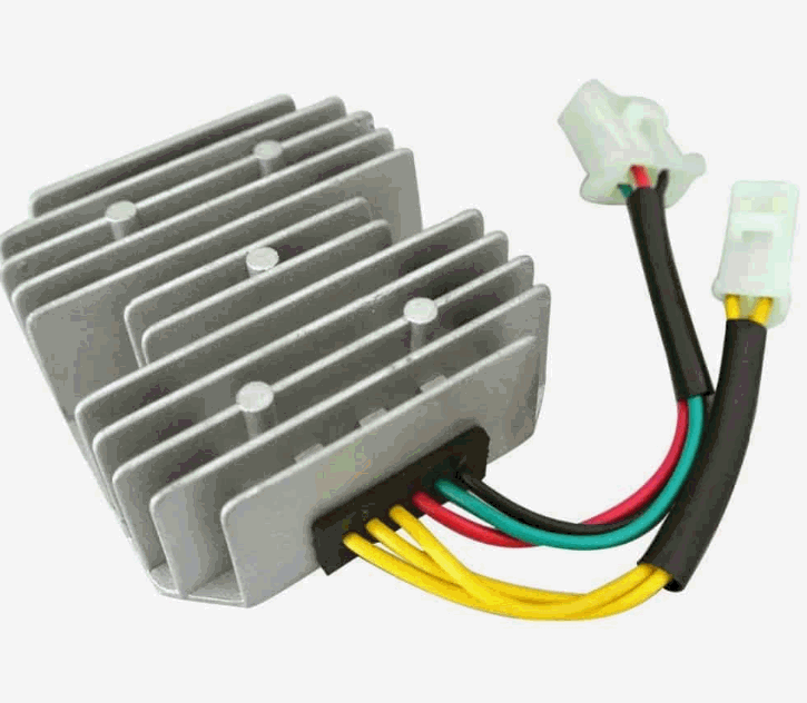

Thanks Mikey, it does look similar. I also found another one that looks almost identical but it says Ford & the wires are different colours. I'm wondering if they are interchangeable? Will the wires do different things on different machines?? :
Ford / New Holland Voltage Regulator 112, 1215, 122, CM224, CM 272, CM274, GFT14 - $55.95 :
The function is probably the same but without a schematic of your ex and one of the Ford you're going to have a hard time matching the connections. The specs would be good too so you're not putting too much juice thru the RR.....M

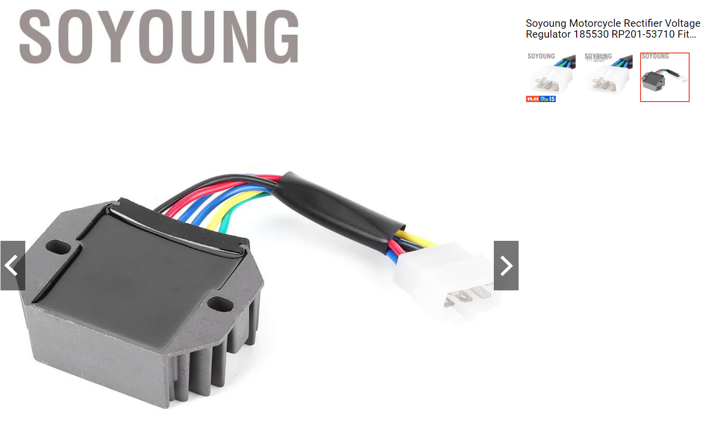

So, will voltage regulator from other non-subaru robin work? What if I swap & match up the wire colors even though they are configured differently like this one for motorcycle below ?
https://shopee.com.my/Nearbuy-Motor...710-Fit-for-Grasshopper-i.96759658.7861801922
Right, I see what you mean ... that's a headache ... I just posted a question whether I could safely match up the connections with a similar looking one for motorcycle :)

You "replace" what there now.....

Thanks Dale ... I'm going to investigate the idea of mounting a smallest possible single wire alternator.
And I'll continue to see if I can hunt down an identical 6-wire Rectifier Regulator for this ancient 1970s Subaru/Robin DY27-2 engine :)

Dear all, just to close the loop on this issue we had : We managed to find a 6-wire rectifier/voltage regulator but with different wire pin configurations.
Our solution was to identify the 2 stator and the ignition switch/light wires. The +ve and ground was easy to identify, it the rest that's a bit tricky.
We tried finding a way to mount an alternator but it was impossible due to the way the mini excavator's solid steel chassis was weld-wrapped around the little engine :)
