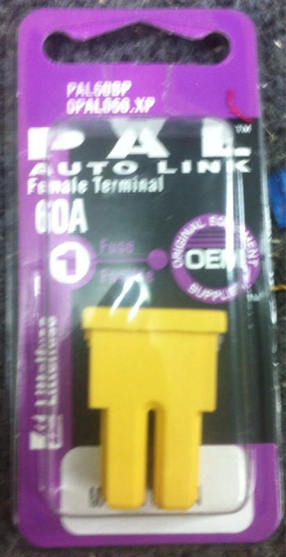

you know.....now that you mention it, i guess having a few extra main 60 amp (or whatever) FUSES in the shop wouldnt be a bad idea. probably not the easiest things to find in a pinch. i think ill line up a few
   / Alright. I screwd it up good now.
#46
For $4, you bet I got extra. :)

Here it is:
