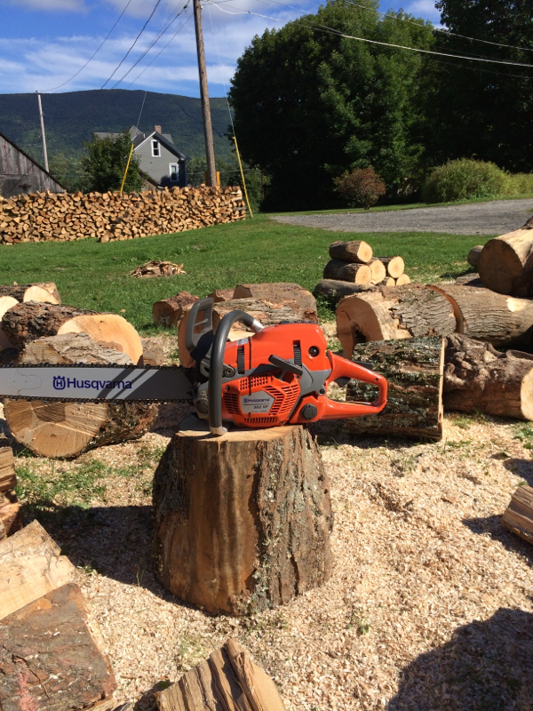

I did a lot of research in the power to weight dept and ended up buying a husky 562xp. If you can swing the $$ i highly reccomend it as i cut mostly in 20" oak msple area & it seems perfect for this:)
Good luck w your purchase.
