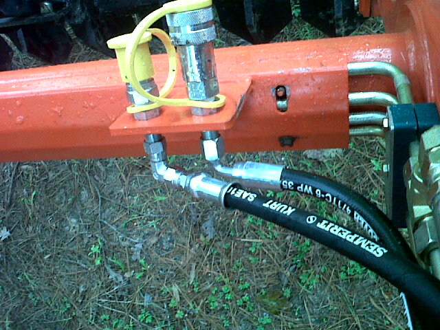

When I come over to get the filters etc. I need that little nut that came off my FEL when that cedar broke the hyd line. See pic, last time you were out you had the wrong one in your toolbox.
Be well,
David

   / Almost time for my 1st service! #13
Hydrostat filter was a REAL bugger to get off. Apparently it was installed, glued and welded on before painting. Also, don't skip tightening bolts, including lug nuts........especially lug nuts (experience talking here). Also, a pump to fill the hydraulic fluid is helpful. Good luck.
My dealer includes the 50 hr service when you buy the tractor. They came and did the service at my place so I got to watch, ask questions and get advice for the next time. Watching them take the hydraulic filter off made me very happy I wasn't doing it. He said some are normal, but a lot of them are "glued and welded before painting" as steve0413 says. Mine was crushed into a square before it finally agreed to part ways with the tractor. Nothing else seemed that difficult, just have the means available to persuade the hydraulic filter to come off. Must be a bunch of Koreans with arms like Popeye out there.
