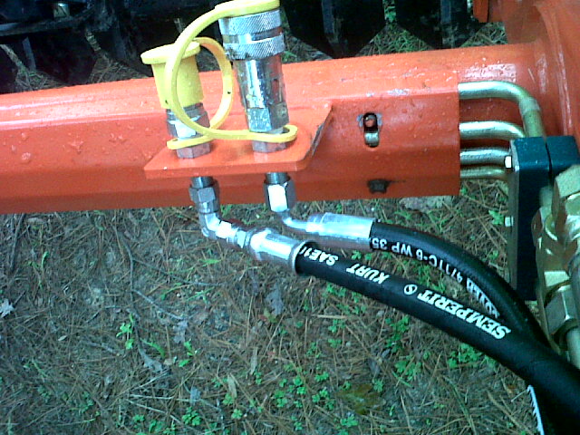

When I come over to get the filters etc. I need that little nut that came off my FEL when that cedar broke the hyd line. See pic, last time you were out you had the wrong one in your toolbox.
