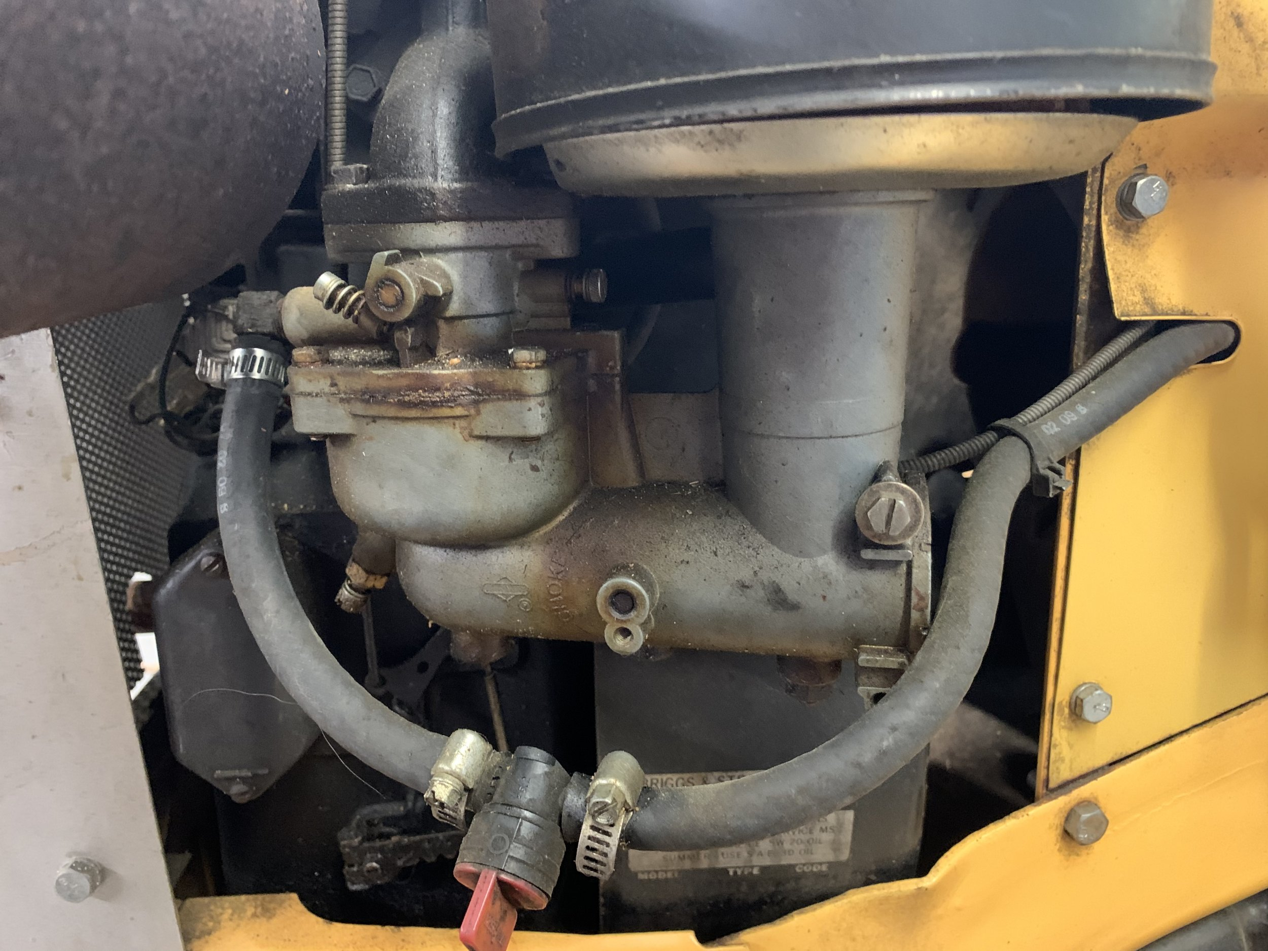

Good morning, I recently picked this up with the intention of a back up mower.
Came to find out it has at least carb issues I.E trouble starting, idling and powering up the mower
I ordered a parts book thinking I would possibly get a usable part number for a carburetor but the book seems to have everything but the carb displayed for some odd reason
Can anyone here tell me why this might be and provide me with a number good or bad….. even an un superseded part number might still give me access to a breakdown of the carb and it’s internal parts.
Also does anyone have recommendations of someone to rebuild correctly without taking advantage

I'm guessing all the carb needs is a good cleaning. Super easy to work on. Not much to it. I would take the carb off and soak in it gas for a few hours to hopefully keep the gaskets from sticking. Open it up. clean it out and reset the the fuel/air mixture screw at about 1 - 1 1/2 turns out
Good little tractors. My dad had one when I was a kid and used it for year.
