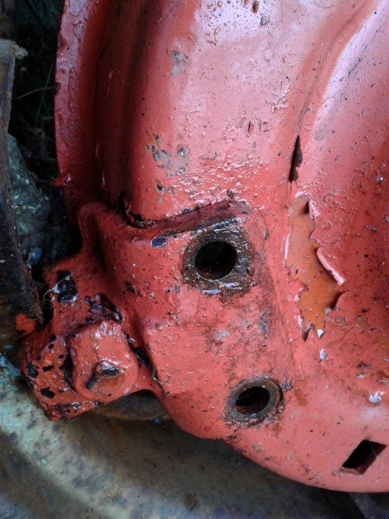

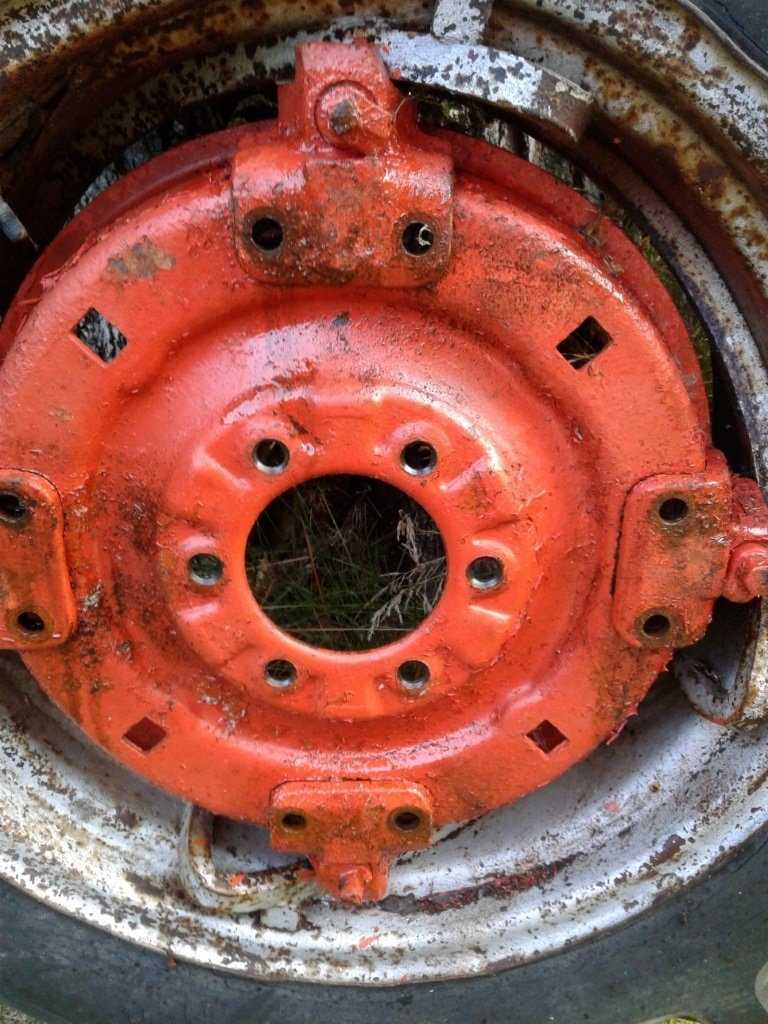

I want to ask some advice as maybe someone will have better ideas. I need to get these apart as I have brand new power adjust rims for it. I got everything lose, except the locks.
I currently have them soaked in Shop Stufff (a canola based penetrating fluid) and Krown penetrating fluid.
I don't have the tool for them and as you can see, one of the square nubs was broke off when I got the tractor.
Should I use heat with the torch? And can I just weld a nut on where that nub is broke off so I can get a socket on it?

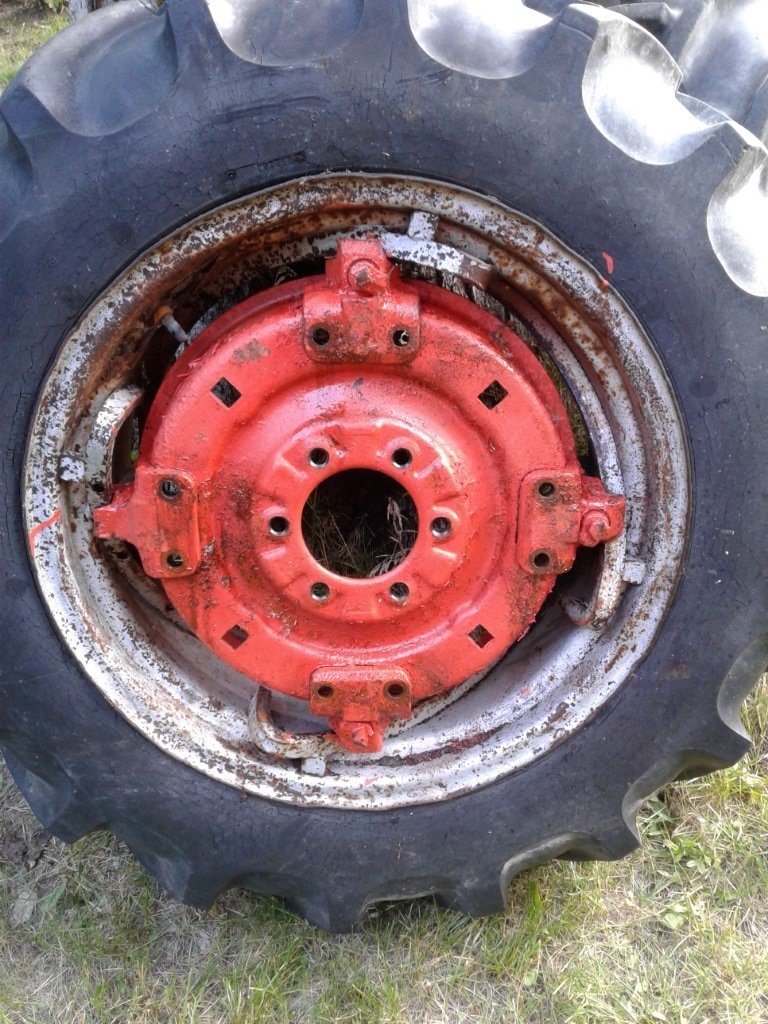

This is the worst part of my CA. The calcium just killed those rims. I have been using it like that ever since I got it, just because I knew it wasn't going to be a fun job, but they finally started to crumble a couple weeks ago while I was driving it, LOL

Mine "looked" the same, just rotted around the stems. But then a couple weeks ago the one rim just fell apart and crushed while driving it, LOL Tires are still full of calcium though, must be tubed.
I did find all my answers thanks to some members on the Allis Chalmers Forum. Even linked me to a video of the whole process of getting everything apart.
Looks like I just need to put a block of wood on the center and get a little more aggressive with a sledge hammer and the center should fall out. Then you can deal with the seized Eccentrics by soaking or putting in a wood stove overnight.
