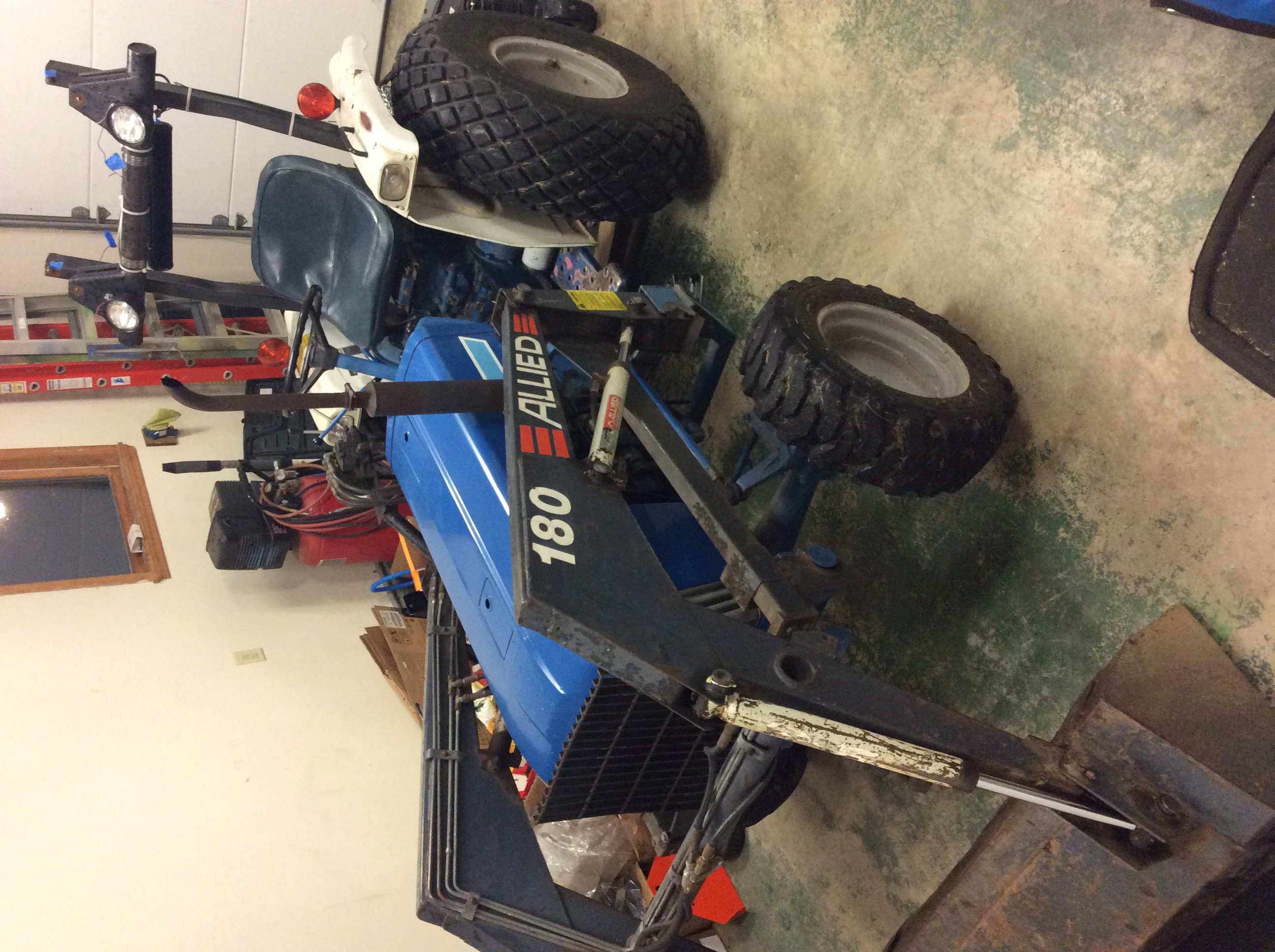

The pin you see is for the lower side of the boom actuator. You can see it in this pic.
You can see in this pic from the internet that there is just the one bolt on the back. I believe it engages some kind of locking lug inside the tower. I don't think it just screws into the tower steel, judging from what I've seen on google.
Your plan about cutting the head off is what I was thinking too. I did pull the tractor out and raise the loader all the way up to see what kind of room that afforded me to work on the engine. I think that is a better idea, as I don't actually "Really" need the loader off at this time.
I do need advice on blocking the loader up so I don't get crushed. I know there are locks they make that fit over the cylinder piston, has anyone fabricated something like this before?

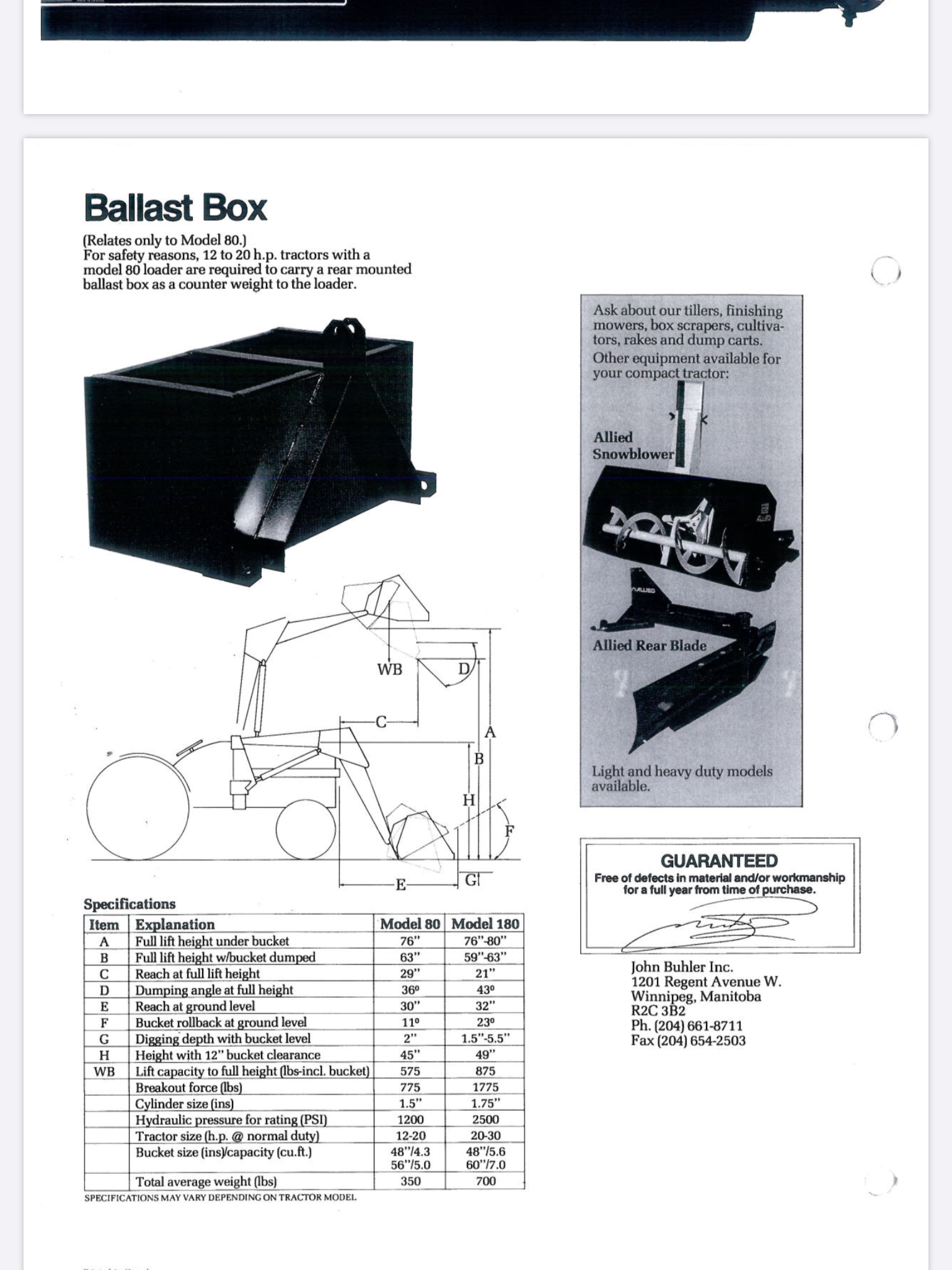

I know this thread is 3 years old, but I just acquired an Allied 180 loader to put on my John Deere 755 tractor. I contacted Allied via a Farm King dealer, and I got a prompt response and an emailed copy of the old 180 sales brochure. It’s got the specs, and I thought posting it here might someday help someone else out. I have to say I am impressed by the customer service of the farm king/allied network. -Chris
