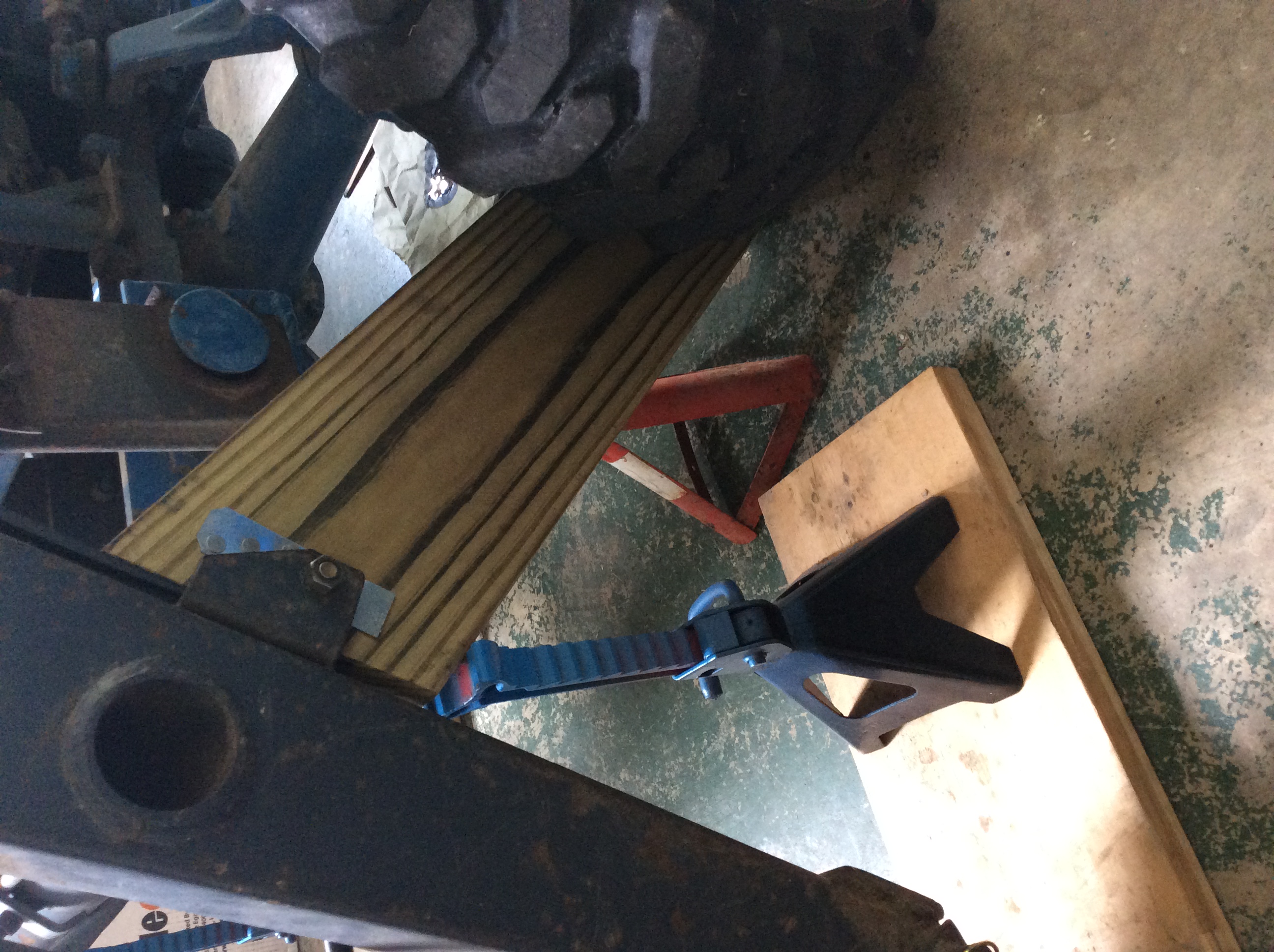

I finally got around to fabbing up a storage stand for the loader out of 2x8s and plywood.
My problem now is I can't get the loader arm retention bolts out so I can remove the loader. Is there a certain position the loader should be in before removing the bolts? Do the bolts even come out? I can get them to turn about a 1/4 turn and then they stop. I have the loader down with weight resting on the parking stands, and they won't budge with a 1/2" impact on them. I've had it soaking in penetrating oil for days and even put a big cheater bar on it until I heard things starting to make "Bad" noises.

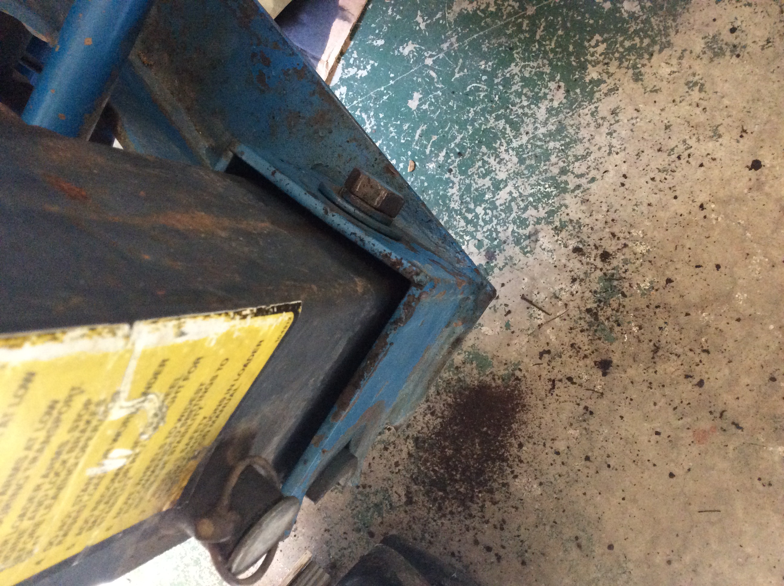

I'm thinking now things may be rusted up tight in there. I took a dental pick and pulled out a bunch of junk from between the loader saddle and loader upright. There is about a 1/4" - 1/8" gap between there and years of dirt, sticks and water have taken their toll on the locking lug and bolt.
Question is now what to do? Wondering if sawing the bolt head off will allow the loader to slip out of the saddle, then I could heat the lucking lug up and get the bolt out. I'm open to any suggestions at this point, this thing is trying my patience.

Asymair
What is the pin just under the yellow label for? Could it be securing the loader upright to the loader frame?
Does that bolt you cannot move actually screw into the loader upright or does it just press against it to stop rattles.
If it does screw into the loader upright, and you are certain of this because to me it looks small to handle a big load, then use a mini grinder with a cut off disk and cut the bolt shank just where the lock washer is beneath the bolt head.
This will leave you with a stub of the bolt shank once the loader is off. Place a larger nut over the bolt stub and weld the two together welding inside the nut. The welding heat will likely enable you to unscrew the bolt stub.
More pictures from different angles would be a big help in understanding just what you have.

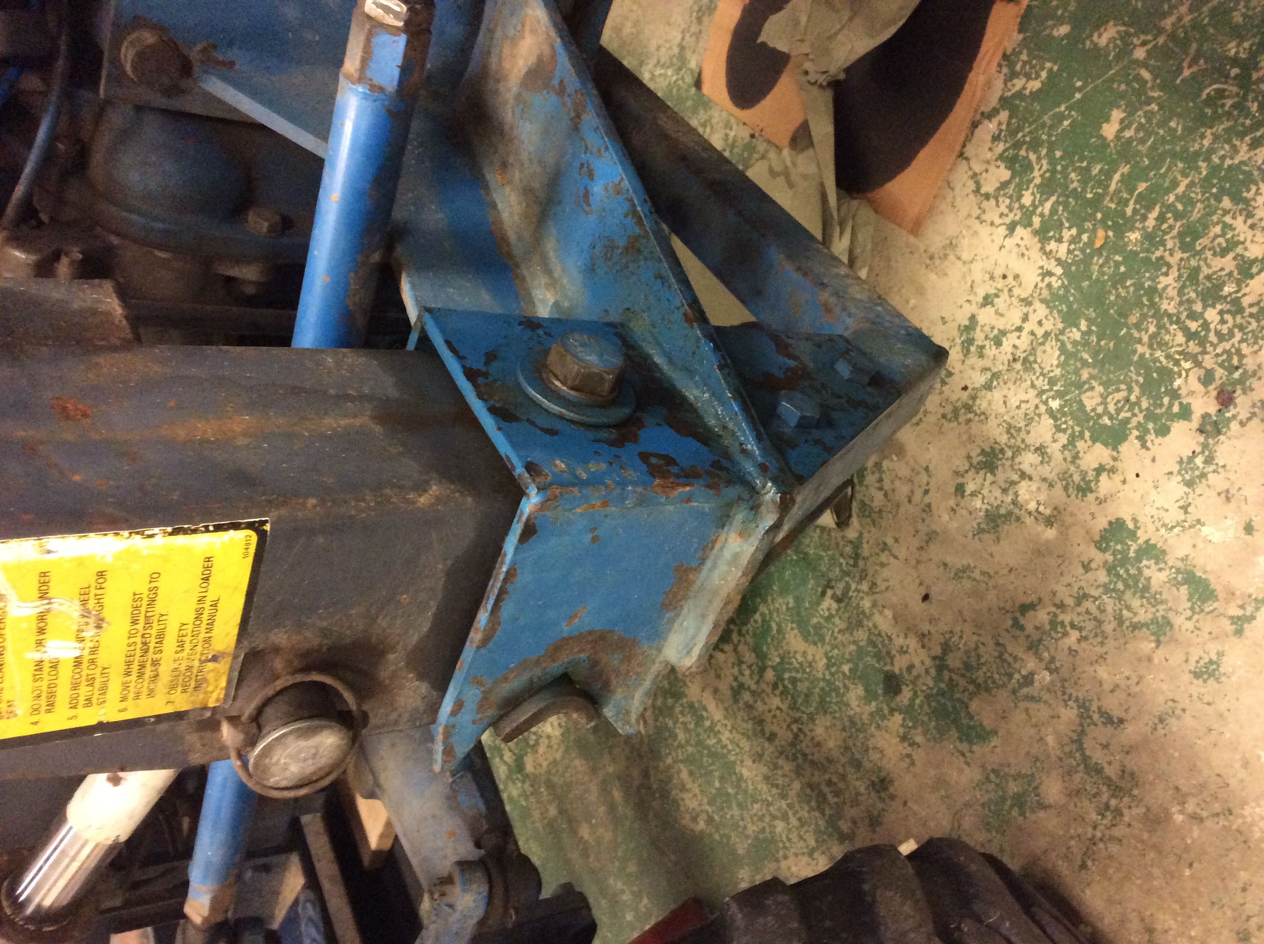

The pin you see is for the lower side of the boom actuator. You can see it in this pic.
You can see in this pic from the internet that there is just the one bolt on the back. I believe it engages some kind of locking lug inside the tower. I don't think it just screws into the tower steel, judging from what I've seen on google.
Your plan about cutting the head off is what I was thinking too. I did pull the tractor out and raise the loader all the way up to see what kind of room that afforded me to work on the engine. I think that is a better idea, as I don't actually "Really" need the loader off at this time.
