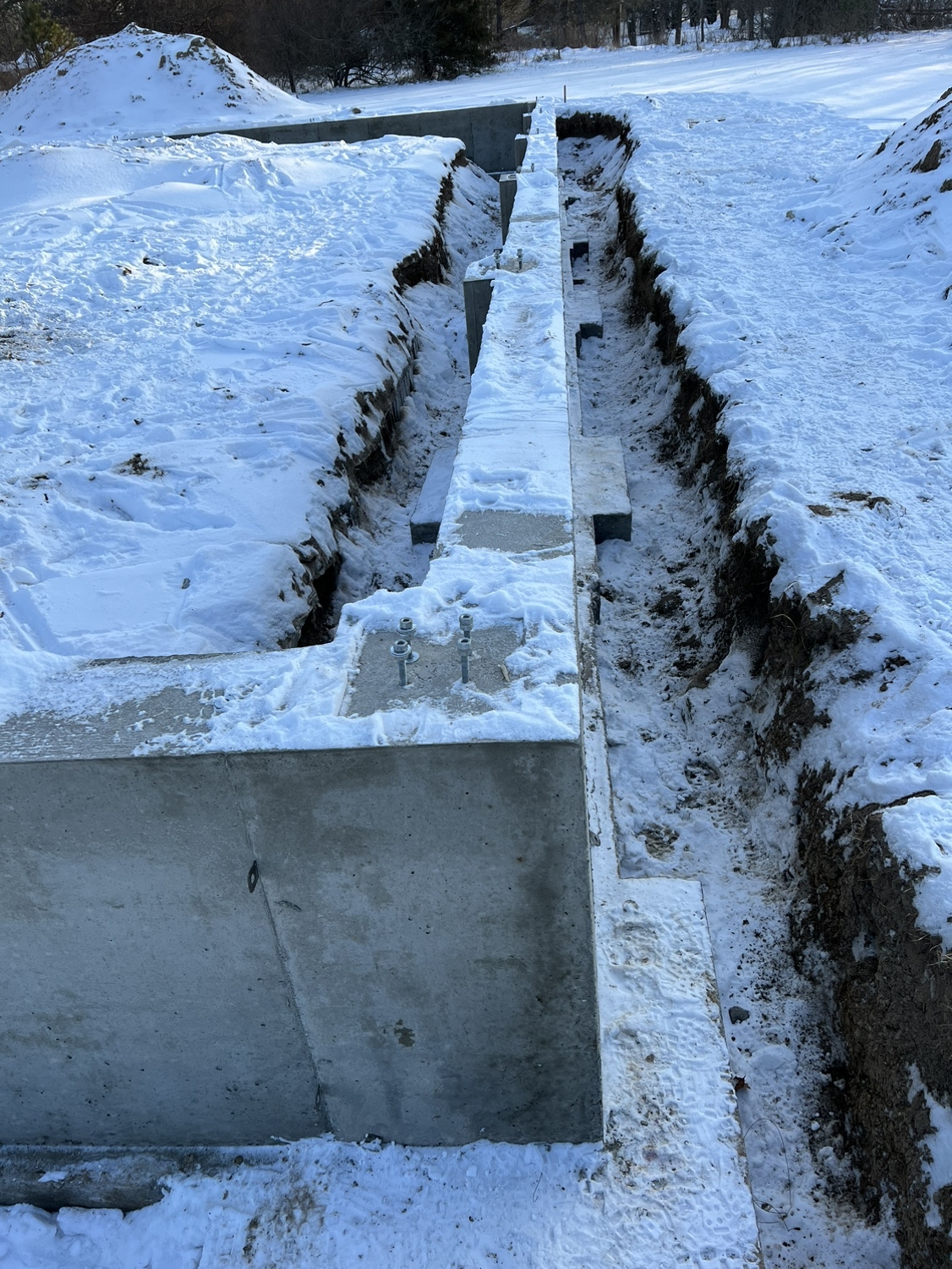

   / All thread rod as rebar #59
I built a steel frame building on poured walls about 18 months ago. The anchor bolts specified on the engineered drawings for each column were basically 12” long pieces of 1/2” threaded rod with a plate washer sandwiched between to heavy hex nuts imbedded 8” down into the foundation wall. A grand total of 60 galvanized threaded rods are holding the 40x60x12 building to the foundation. If the 24 in the picture below can take the shear of a 60’x12’ west facing wall and resist the uplift of the building, I think they are strong enough to reinforce a floor as well. But I’d probably want them galvanized or plated, or research an appropriate primer, and make sure I had the rod solidly embedded and not laying in the bottom of the slab.
