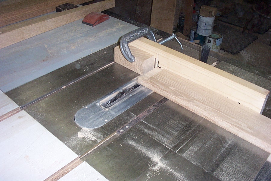

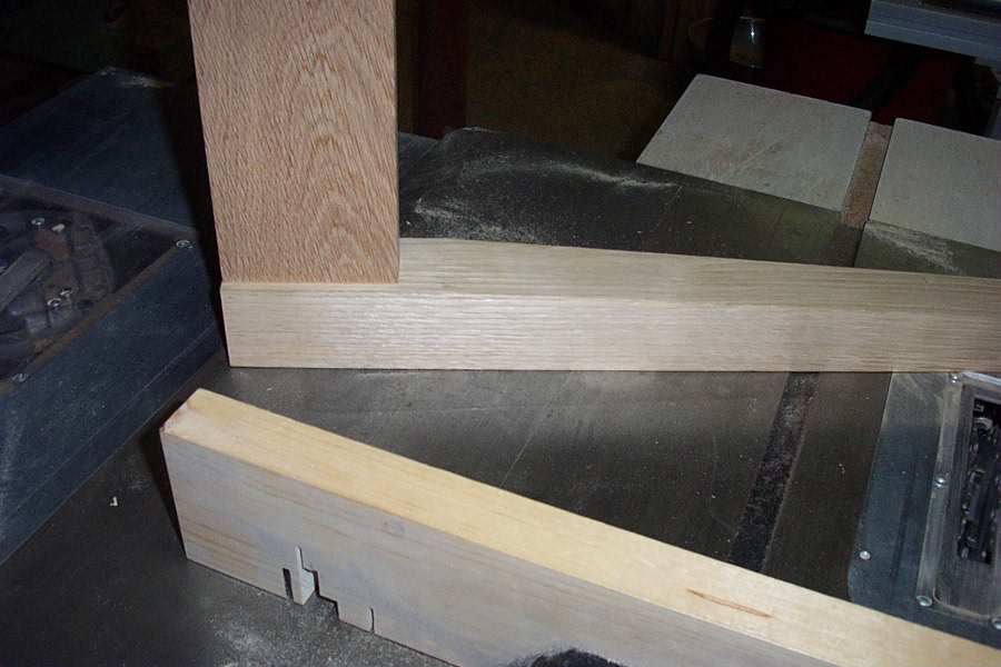

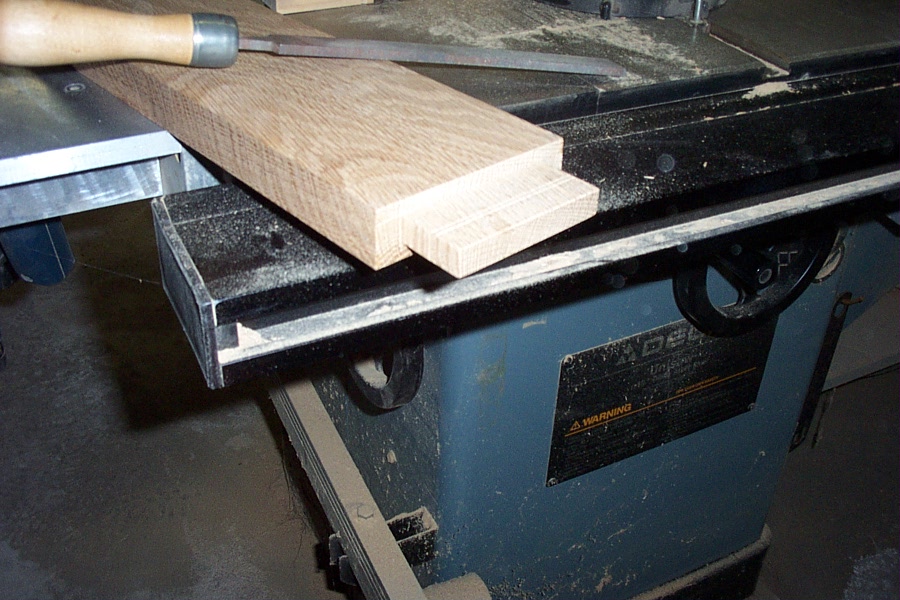

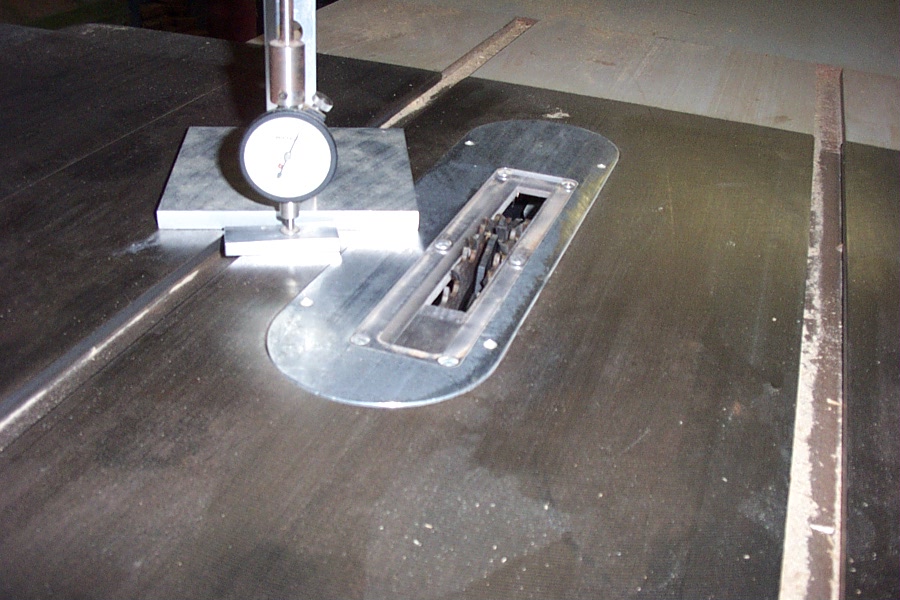

I got a little shop time this evening. I milled the side and end aprons for the table. I set up the dado cutter and started milling tenons. Actually got the first one fitted.
The 1st pic is setting the dado height to start cutting the tenons, Im a toolmaker by trade and like using indicators and calipers when I can ;)
2nd pic is setting the stop so all the tenons are the same length and square, thats important to get a gap free fit between the apron and leg.
3rd pic is the finished tenon, I leave a small bit of stock on the tenon and hand fit with a mill file.
4th pic is the first tenon fitted.
This is the way I do it, there are other ways but I like this method and it works well for me !
BTW, the throat plate in the table saw top is one I made, you can see where I can interchange the lexan plates for different widths of the dado cutter.

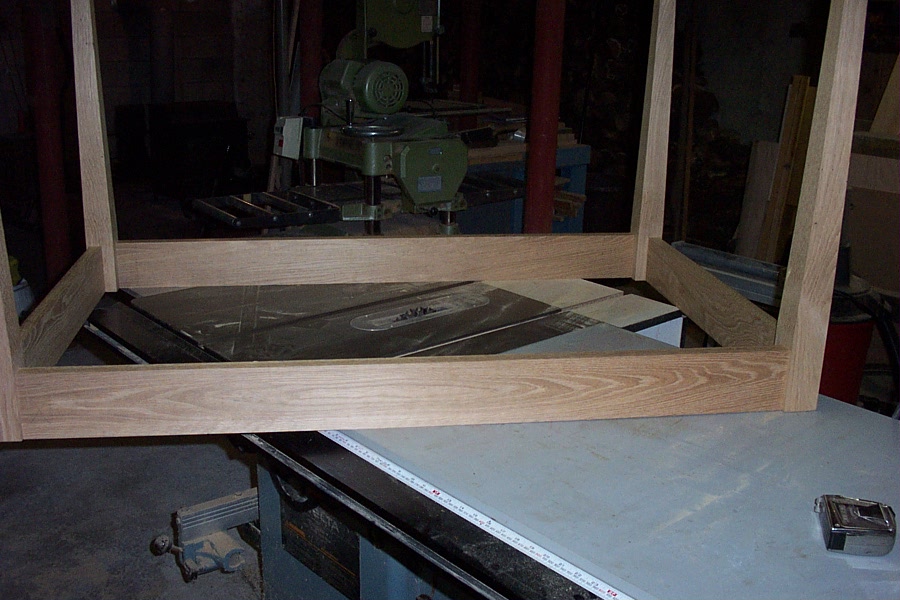

Good Evenin Guys,
I spent a little time in the shop tonite and got the aprons and legs dry fitted.
I will be making a template to relieve the bottom the aprons next.
Im also planning on using some rosewood that I have stashed to make 1/4" square pegs, and I will be pinning each tenon twice and leaving the square pegs just proud of the leg surface. This was done quite frequently in mission style furniture.
For those interested, there is a 1/4" reveal between the apron and the outside leg surface.

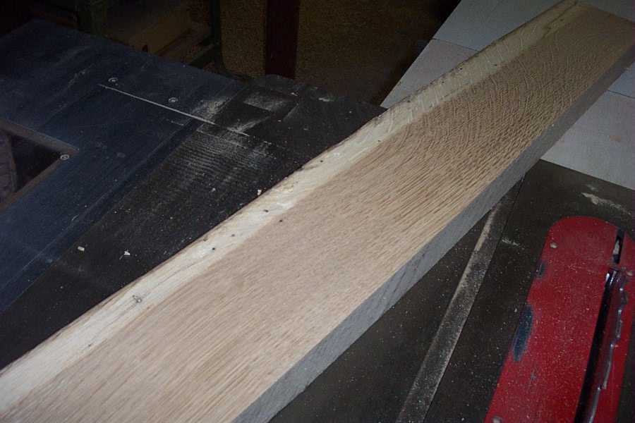

Good Evening Guys,
I started milling up the stock for the t-slot runners that will go inbetween the end aprons tonite. I thought I would post a pic of the amazing ray pattern on this white oak. I certainly didnt plan it that way, since these pieces will be underneath the table and out of sight :(
When your dealing with rough sawn lumber you really cant tell what it will look like when finished milled. Anyway I hope the pic is clear enough for you to see the grain, it is very nice.
