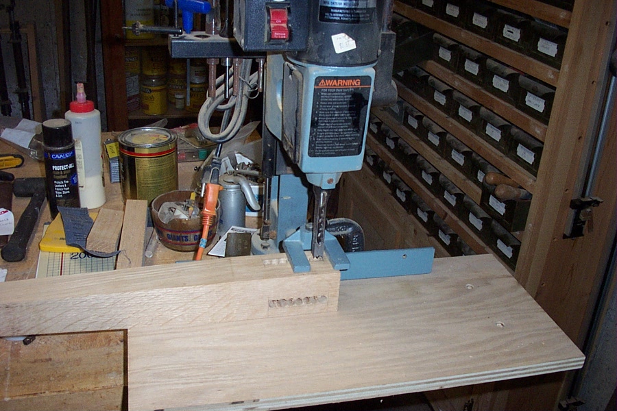

khd said:
Did I miss it somewhere or how did you do the frames for the cabinet?
Mortise and tenon. I have a mortiser which makes these joints a bit easier.
No pegs in these, though. It wouldn't look right in this situation, and there isn't any structural need for it in a built in anyway. Biscuits, dowels or even pocket screws would work just as well.
Cliff

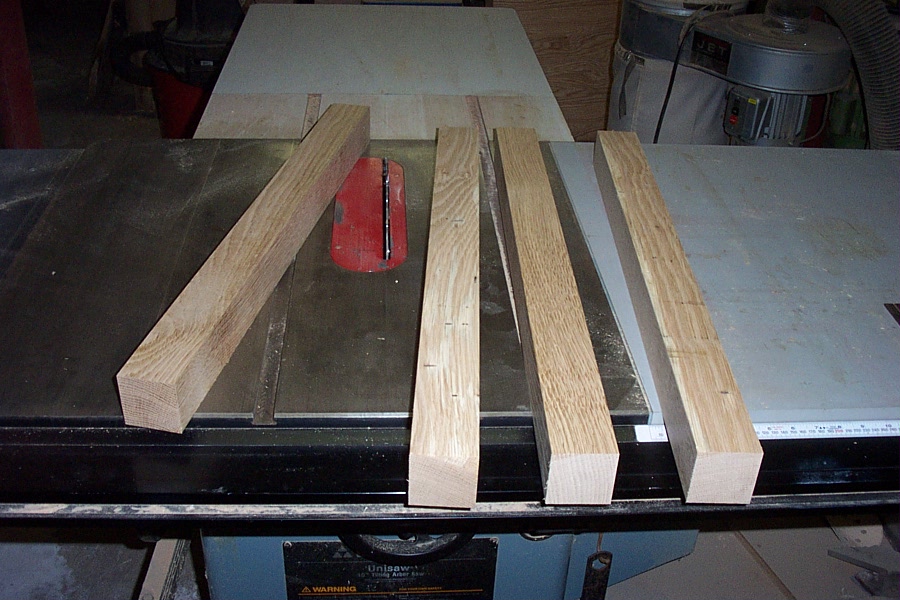

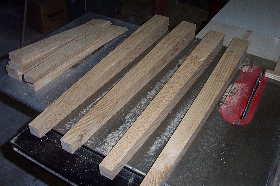

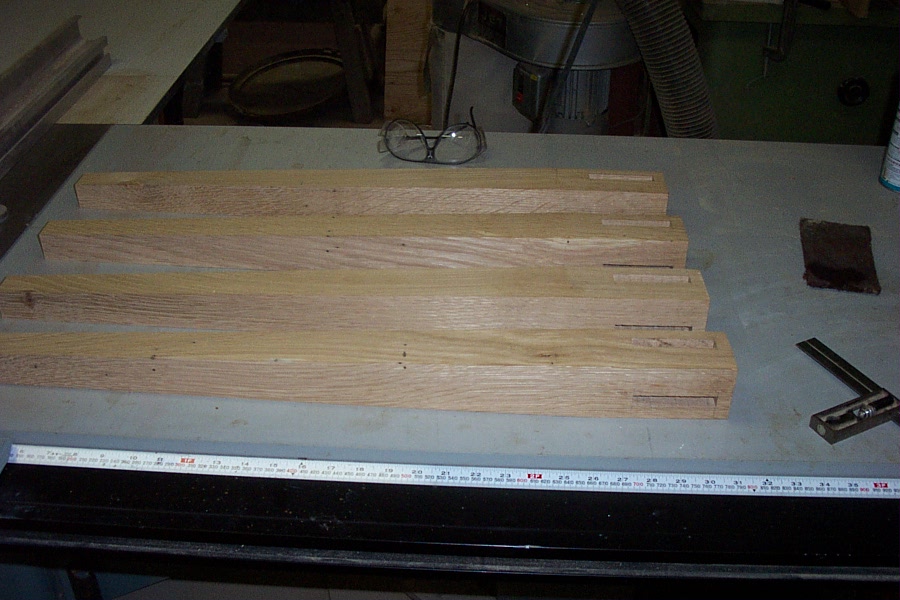

Good Evening Cliff,
Well you have inspired me to get started on my kitchen extension table ! Well done.:)
1st pic rough oak plank
2nd pic legs milled and squared
3rd pic tapering legs
4th pic 4 legs
Next I will mortise the legs for the side aprons.

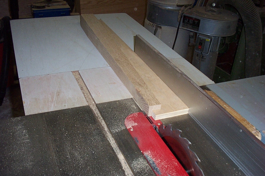

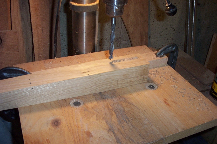

Mornin Cliff,
Do you like the way I have hijacked your thread ? :) I forgot to mention for those interested. The legs are 2 1/4" x 2 1/4 " square 28 1/2" long. With a 1" top the table height is 29 1/2". The mortises are 1/2" x 3" long by 1 1/4" deep. The side aprons will be 1" x 4". Without any leaves in the top the dimensions will be 42" x 70". Im planning on having two leaves 16" which when installed the table would be 42" x 102". All these calculations just so Kathleen can use a 60" x 120" table cloth !:confused: :)
Three pics today.
1st pic drilling waste with a 7/16" brad point
2nd pic mortising 1/2" x 3"
3rd pic finish mortises

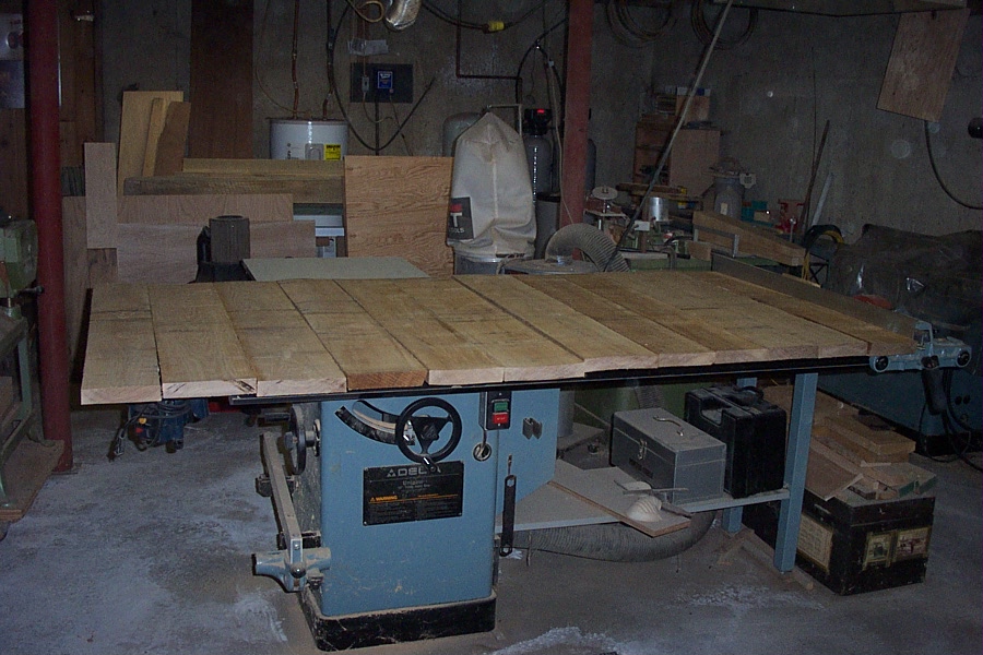

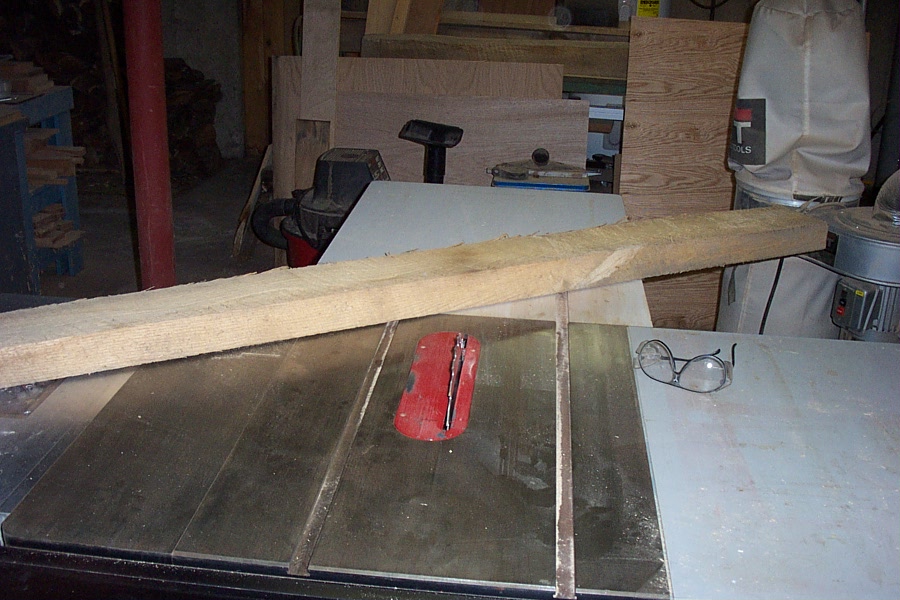

Good Evening Guys,
I went to the sawmill and got a bunch of 5/4 rough sawn oak today. I rough cut the planks to give me enough stock for the top, and allowing for milling waste to finish to size. What I did forget, was to get enough stock for two leaves :confused: I will have to take another run over there.
I just had to snap a shot of all these rough boards lined up on the tablesaw, its a lot of milling, Im feeling a bit overwhelmed right now.
Im kinda thinkin Im going to let these boards acclimate to my shop a bit before I start milling them. I still have to mill the table aprons, and create the tenons and fit them to the leg mortises. This table is gonna weigh a few pounds, Kathleen wont be moving it by herself ;) :)
