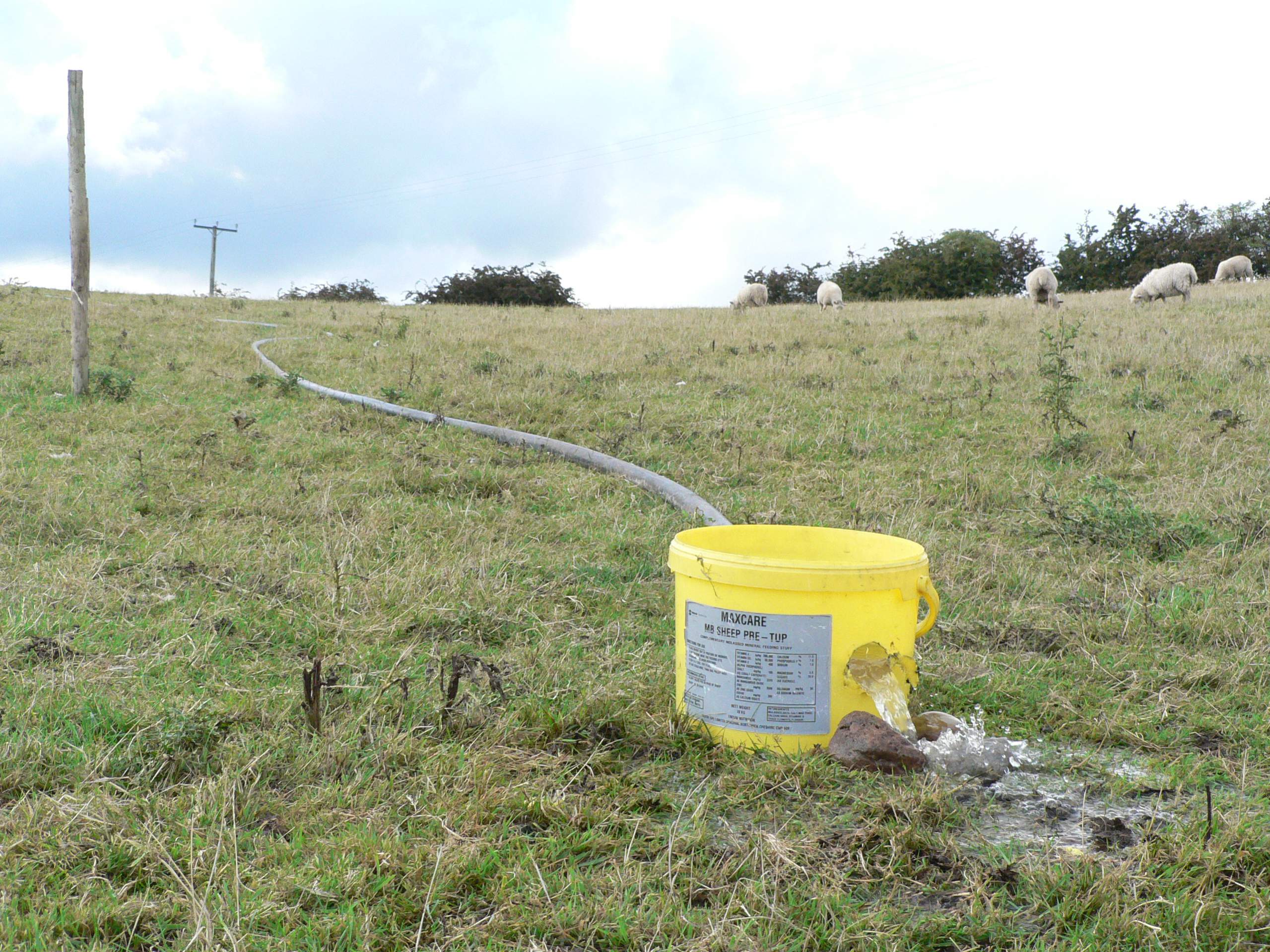

At last the week at work was finally over and I could get back to the pond and play.
The drive over the moors from Yorkshire was always enjoyable, but never filled with so much anticipation as while trying to clear out this pond. After the M62 multi lane highway leaves the busy outskirts of Manchester, the much quieter A49 starts to wind it's way through Cheshire and a landscape dominated by dairy farming. As the twisting road gently rises and falls on it's way to Shropshire, time seems to slow down, the hectic pace of the last few days is soon forgotten and thoughts return to how the siphon had got on. I could have increased my speed a little to arrive a few minutes earlier, but that wouldn't make any difference to the water level in the pond. The siphon had either worked or it hadn't, simple as that. If it hadn't worked, well there was still plenty of time for another try if need be.
I need eye glasses to drive, but I certainly did not need glasses to see that the pond had changed. The excess water over the normal summer level had gone and bare ground was starting to appear part way down the bankside. Shallows to the side of the sump looked more like an estuary at the turn of the tide than a farm pond.
attachment.php
Various wildlife had been to visit the emerging shoreline and see what was going on. All had left little prints behind in the mud, with the badgers sinking in the deepest.
Before I left the previous week I had pushed in a measuring stick, intending to take before and after pictures. This is how it looked after just over a week of draining.
attachment.php
The original level is not easy to see on the white and orange stick. If you look to the far bank, you can see how far the level had dropped by the weed left hanging on the bushes that were previously skimming the surface of the water.
Over the next couple of days, I had nothing much do, apart from cleaning the filters. The chicken netting filter on the sump had done a great job.
I had another length of pipe ready go further down the hill and so increase the flow rate, then the "If it ain't broke don't fix it" mentality kicked in. This time I wasn't quite so apprehensive as I left it to continue at it's steady pace for another week.

So you're saying a 10' long downhill pipe with an outlet 1" below the inlet of a 100' long uphill pipe will work?
Until a bubble collects at the apex.
It depends. The total lift can't be more than what atmospheric pressure at the location can push up (about 10 m or 32.8 ft max). The flow at 1" head will be very low.

Neither leg carries the full weight of water unless that leg is vertical. (pressure determined by distance below the surface) It doesn't matter where the high point in a siphon is, or comparative horizontal length(s) of the legs. (A vector issue?) Pressure at the low end of a 100' pipe with 1' total rise will be the same as at the low end of a 1' vertical one. (btw, diameter 'don't mean squat')
Once air is removed from a siphon water will flow to the lower source's level until they equalize, hunches and pipe length(s) aside. Bubbles/entrained air, pipe dia/friction, and mass of the water in the siphon will affect flow rate only. It's easy to be confused by vertical vs horizontal (TDH) displacement and water weight, but mechanical devices rely on science vs superstition. tog
I once saw a 2nd floor waterbed drained via garden hose with its outlet a good 10' below the bag. ~ 10lb of 'suction'. Man did that baby drain fast and pucker up at the end of the job. :eek:

The added flow situation is that in low flow siphons, air sucked out of the water slowly collects at the hi point and will finally stop the siphon.

Agreed, it's the difference in level that exists between the high and low end of the siphon that moves the water. While a higher high point in the middle will make filling the tube more of a challenge, once accomplished the flow rate depends only on the height difference between the two ends of the tube and not on the distance or gradient between them. As the weather warms, all that's needed to verify this for yourself is a length of clear vinyl tubing, a bucket of water, and something on which to perch it. Put the tube into the bucket until if fills with water, then put a thumb over one end and move it to a level below that of the water in the bucket. Experiment with the height of the middle high point and the gradient of the tube and verify that as long as the end is lower when the thumb is released, the siphon will start. Experiment with the height difference between the tube ends and verify that the greater the difference, the higher the flow rate. Use different diameter tubes and observe the increased flow rate. Make a video of all this on YouTube and become the latest Internet fad!
Oh yes, BTDT on some long runs. (~75', high point 3' or so above source, net fall <3', 1 1/2" corrugated hose.) :mur:.
How many times I wish I'd had a bucket/barrel like the OP's at the outlet when slow flow wouldn't flush out the bubbles. Pretty sure OP drew down a lot more water in a lot less time than the last swimming pool we drained. :eek:
