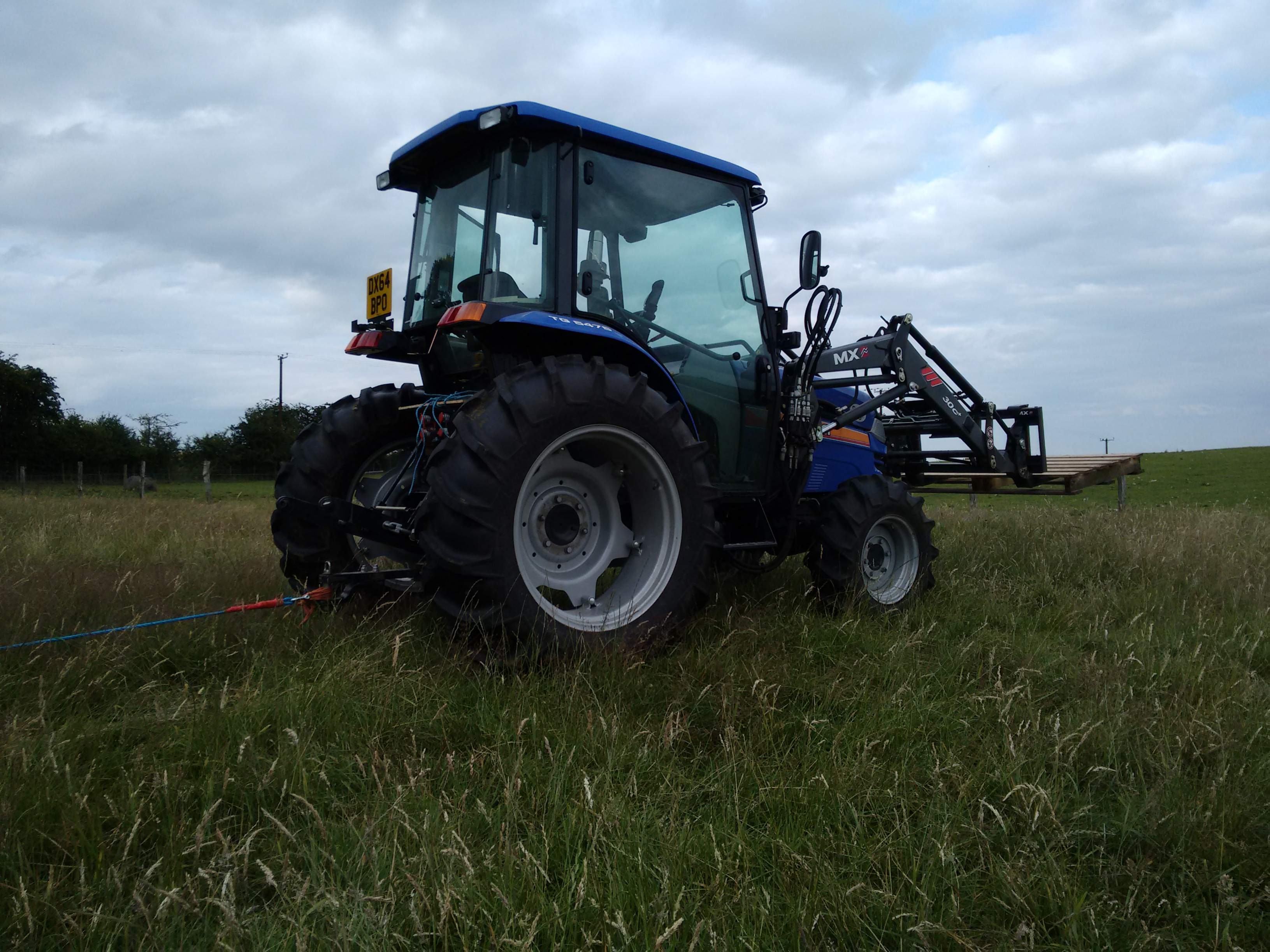

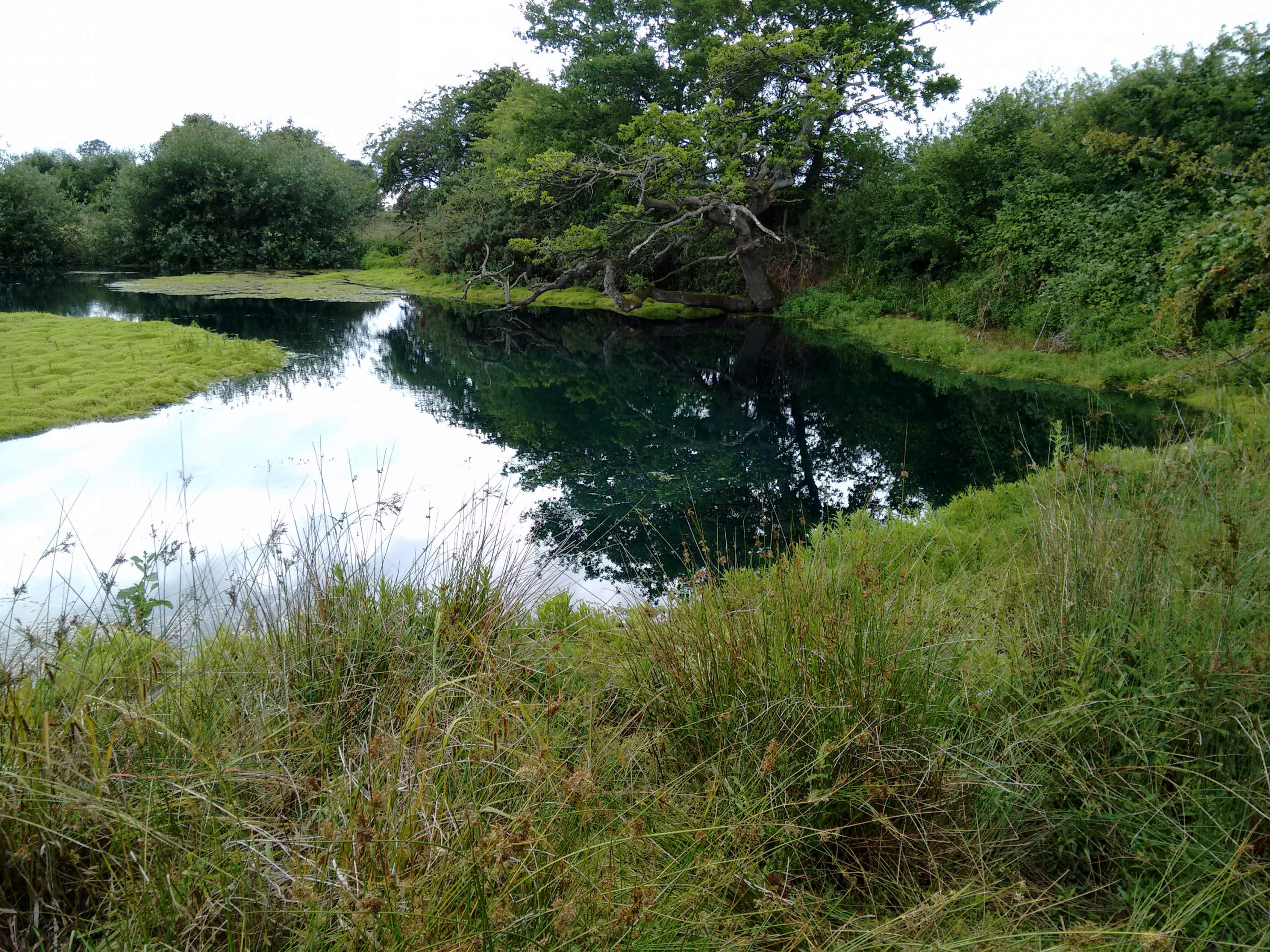

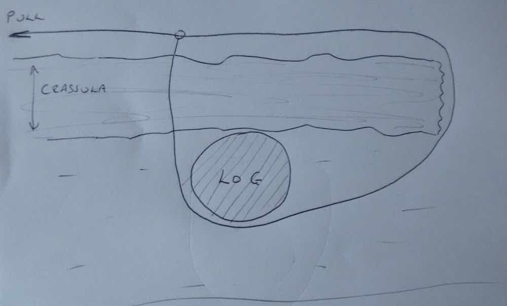

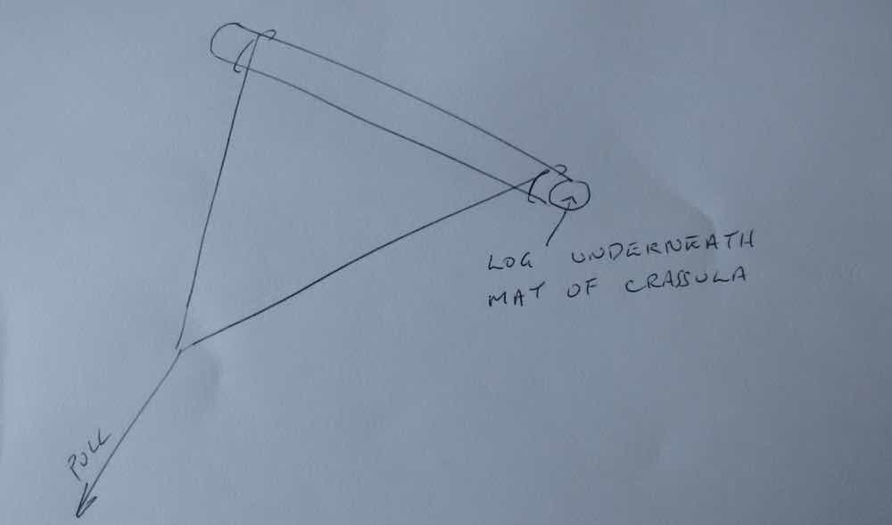

Alien on Tow
For a week or two I have been thinking of how to get a good grip on the Crassula to tow it away from the far bank and out of the deep water. When I tried using a grapple hook, it tore through the plant before it would move. Too much force concentrated in one small spot.
That got me thinking, the plant itself is very tough (I can stand on the surface without falling through), so if I could spread the force over a large enough area, I could use that to my advantage. So this was the plan ...
First take an 8' log to the far side of the pond and poke it underneath the Crassula. Easier said than done, but I managed to get it under eventually. Then use a pointed post to punch a hole through the weed and pass a length of rope around. Repeat again so that both ends of the timber have rope wrapped around.
attachment.php
attachment.php
Next, rope back to tractor and steadily pull.
attachment.php
Hydrostatic drive certainly makes pulling a lot more controlled, however after what I thought was some initial movement, things came to a standstill, with me not daring to pull any harder for fear of my weak link breaking. I stood on the brakes, keeping tension for another minute or so before the rope sagged again, then I eased forward an inch or two at a time, before climbing out to have a better look.
attachment.php
It was working !
attachment.php
attachment.php
It was a great feeling to see clear water open up again under the oak tree. Now all I have to do is work out the best way to get it all out of the water.

/ Alien Invasion - I want my pond back ! #323
Alien on Tow

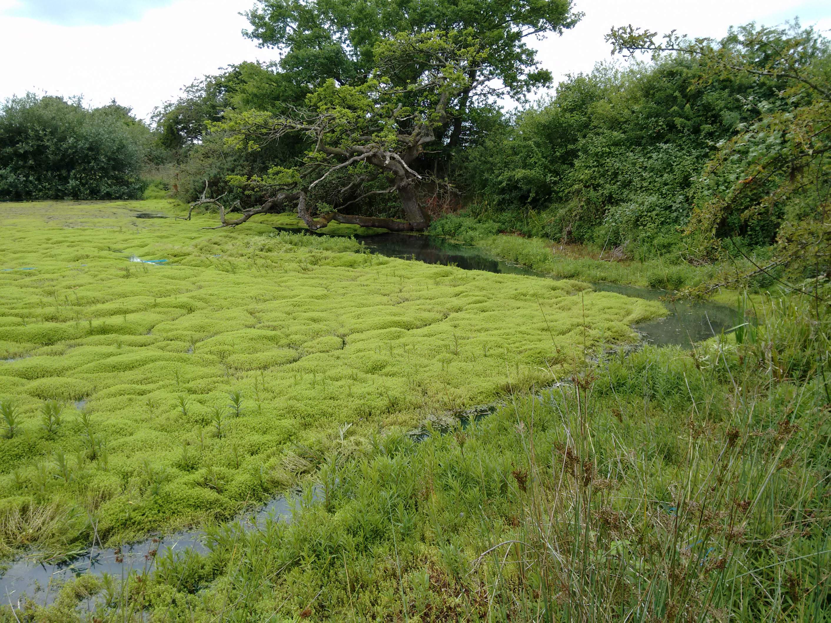

Extracting the Alien
My son came over for the weekend and we spent a few hours together dragging the Alien out of the pond. He went to pick up a piece by hand and was surprised that it was so heavy. Not a problem with the tractor loader, only issue is getting it up on the edge of the bank to be able to then grab it out. When you get lucky, it sometimes comes out in a big sheet.
attachment.php
We shifted a fair amount with a tow rope and grapple - him on the tractor and me in the water. Not the most efficient technique, but at least it gave him chance to get used to the new tractor.
Once he went home, I thought I would try and move the rest in bigger chunks by cutting in slits, poking an 8' length of 2 by 6 timber underneath and then heaving it out. Crassula won that one as the wood broke on the first pull.
attachment.php
So today I scaled up and spent a couple of hours with a big old 8" diameter post on the drag line. Takes more effort in the pond to sink the post under the surface, however the results can be quite satisfying.
attachment.php
Good job I don't pay myself by the hour, this is taking quite some time, but I'm definitely getting there.
433785-alien-invasion-i-want-my-pull-1-jpg
433786-alien-invasion-i-want-my-broke-plank-jpg
So today I scaled up and spent a couple of hours with a big old 8" diameter post on the drag line. Takes more effort in the pond to sink the post under the surface, however the results are quite satisfying.
433787-alien-invasion-i-want-my-big-tow-jpg
433788-alien-invasion-i-want-my-almost-there-jpg
