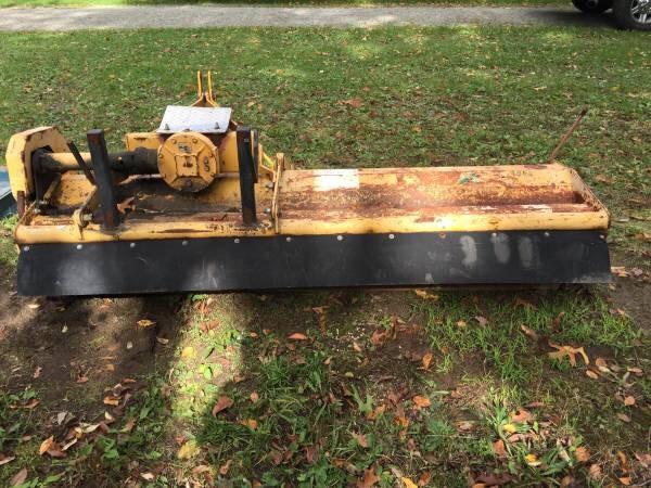

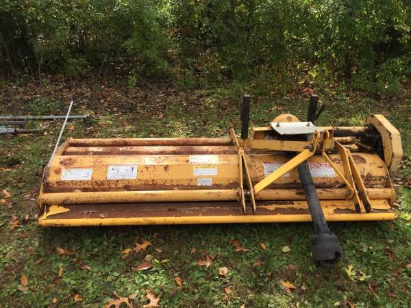

Going to go look at a 7' Alamo Flail mower tomorrow. I had a 5' brush hog but recently got rid of it with plans to replace with a 6' unit. I had thought about a flail mower in the past but the price of them along with the cost of repairing / replacing the many blades steered me away. This one came up and price looks good. Is the Alamo brand good? Is it easy to get parts for? I will be using it to keep about two acres of field tamed back along with hitting the trails in the woods. I'm concerned about the branches that fall along the trail that the brush hog has no issue with. How will a flail mower handle them? I have rocks as well that I am trying to remove but seam to reappear out of nowhere. I like the offset for getting the sides of the trail but seems excessive to me? Guy says the blades are in good shape and mows well...what do I look for in the blades? He is asking $575

Alamo is a GOOD make and a solid machine. Yes, parts can be found fairly easy as there are TONS of them around and are a "popular" make. If it is in decent shape that is a good price.

If only a couple of acres and with trail cleaning I'd think it better to stick with a rotary, go with the 6' one (as long as you aren't looking to do heavy brush work your tractor should handle 6' fine). Not sure if that Alamo is fixed offset or if you can reset it: some flails allow changing the three-point mounting, shifting the mower over (best, though $$s, is hydraulic side-shift).

Alamo/Mott are top-of-the-line mowers. FlailMaster will have all the parts you need.
Is this a finish flail or a rough cut flail? Make sure it's a rough cut if you plan on doing tall grass/etc., I had a 5' Mott and it cut lawn grass like a boss, but wouldn't do well with tall grass, branches, rocks, etc.

The Alamo will be better quality than my ancient Ford 719 flail. I have no qualms with light brush or occasional moderate sticks & branches. I wouldnt use it for heavy brush or small trees though.
Blades are cheap & readily avalible from Flailmaster. A full set isnt that cheap though. If they arent square or mangled they need to be replaced, if not they are probably fine.
Is the hood straight & unbent? Are all knives there? Is the gearbox full & not leaking? Are the bearings smooth? Most importantly is it smoothwhen spun up to speed?
Everything but an unballanced rotor or mangled hood is easily fixable for a couple hundred bucks.
I paid $100 for mine, then $400ish in parts & a few weekends working on it & patching a dented hood. Recently blew a bearing, not terbly suprising on a 30 year old machine. Still love it more than my nearly new rotary cutter.

Well I ended up buying it. Was in pretty good shape but will need new blades. Even with worn blades it does cut nice. Ran pretty good until I hit a rock and broke a couple blades resulting in vibration issues. Probably going to sell it and get a brush hog. For the areas that I will be mowing I think I need something a little more robust and less maintenance.
