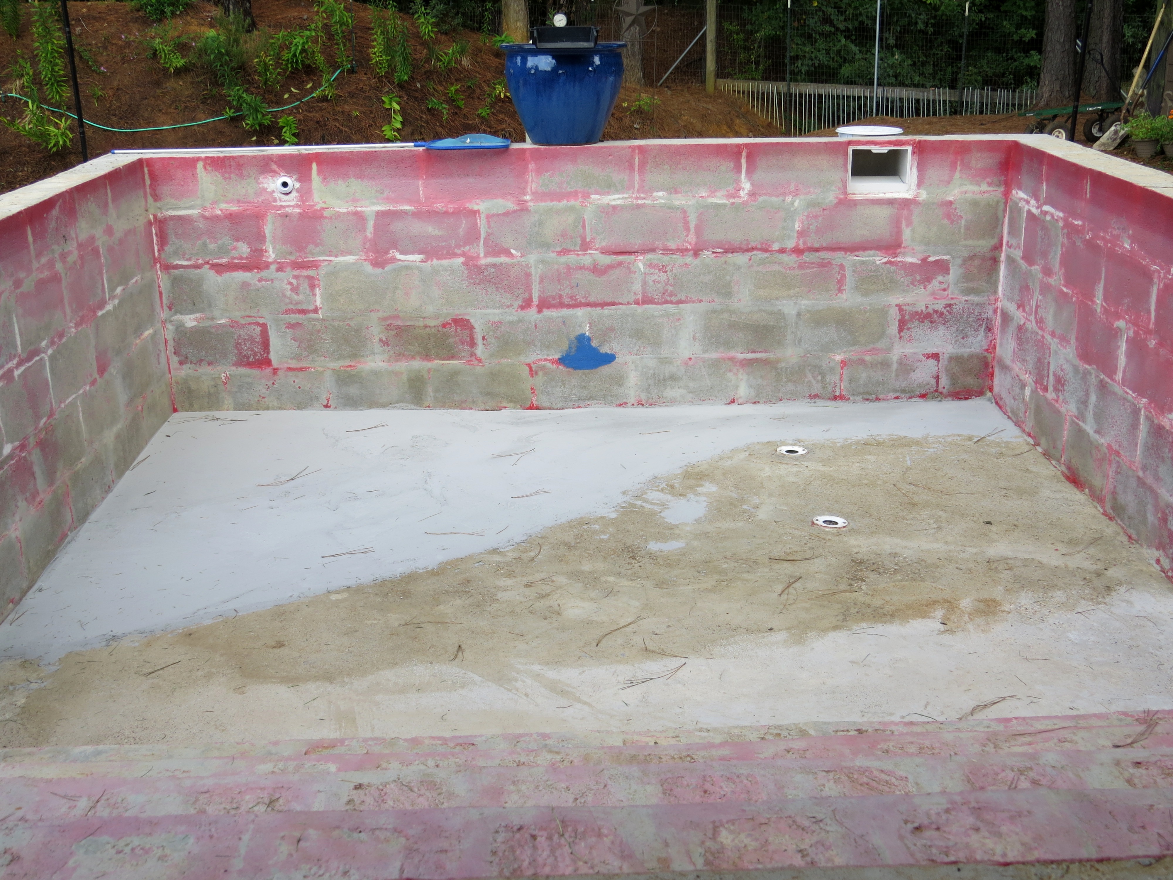

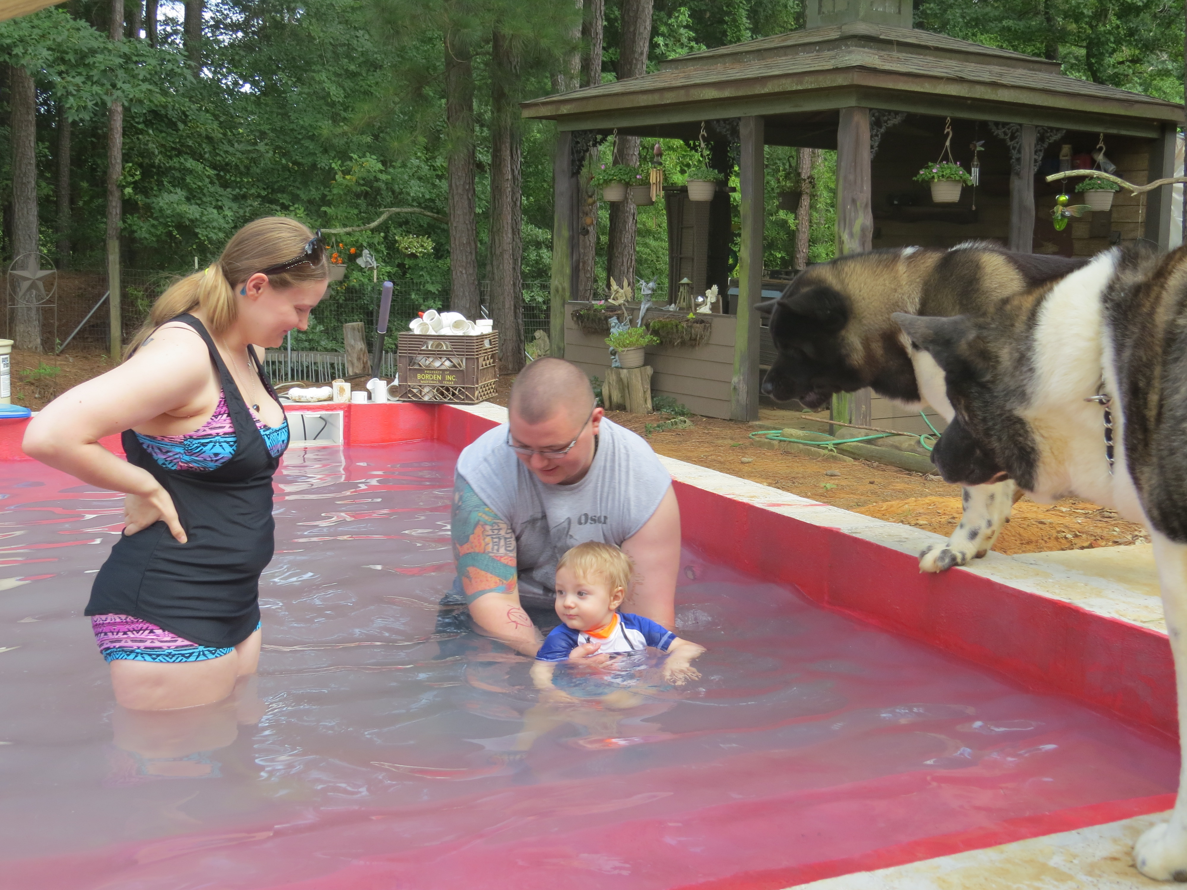

I filled up the pool for the 4th to see if there where any leaks, and of course, to get in it and see how it is.
There is a leak. It's a pin hole that is shooting out water between the blocks. Every seam got two coats of RedGard, so I'll have to see what's going on there when I drain it. I'll probably put on another coat after sealing that leak, and then go to plaster for the next layer of water proofing.
I was unsure how small it would feel when building it. The goal was to have a place for my wife and I to relax and cool off, but also for grand kids to play and have fun, and maybe even get the dogs to come in and cool off too. The dogs are using it as a water bowl. Only one has put his feet in it, and seems unsure of it. I think that will change with time, but either way, it's always an option for them if they want to go in it.
I put out two blow up rafts to lay on, and we had five adults and one 2 year old in it with plenty of room. The stairs have proven to be the best part of the pool. Warren, my grandson, just loves to run along them, and splash in the water, then go down another step where it's a little deeper, and the climb back up again. Over and over again!!!
We'll enjoy it this weekend, and then Sunday night, I'll drain it to work on the leak and get ready for plaster and then tile.

Update on the Redgard. It faded quite a bit when under water, but it's still on there. I found a couple of leaks that I plugged with some blue gasket sealer because that's what I had on the shelf, and it worked great!!! I also added a couple sacks of leveler to get it to drain better. That far left corner was holding water after emptying the pool, and I wanted to fix that before the tile went on.
I'm using a special thinset mortar made by Ardex that is called X-77. I think that I need 3 1/2 sacks, so I ordered five. They are $50 each and they are coming from Europe. I guess England from what I saw on their website, but I'm not sure. It's taking a very long time for it to get here. Because of the blocks being used for the walls, I wanted the very best thinset that there is. I believe this is it.

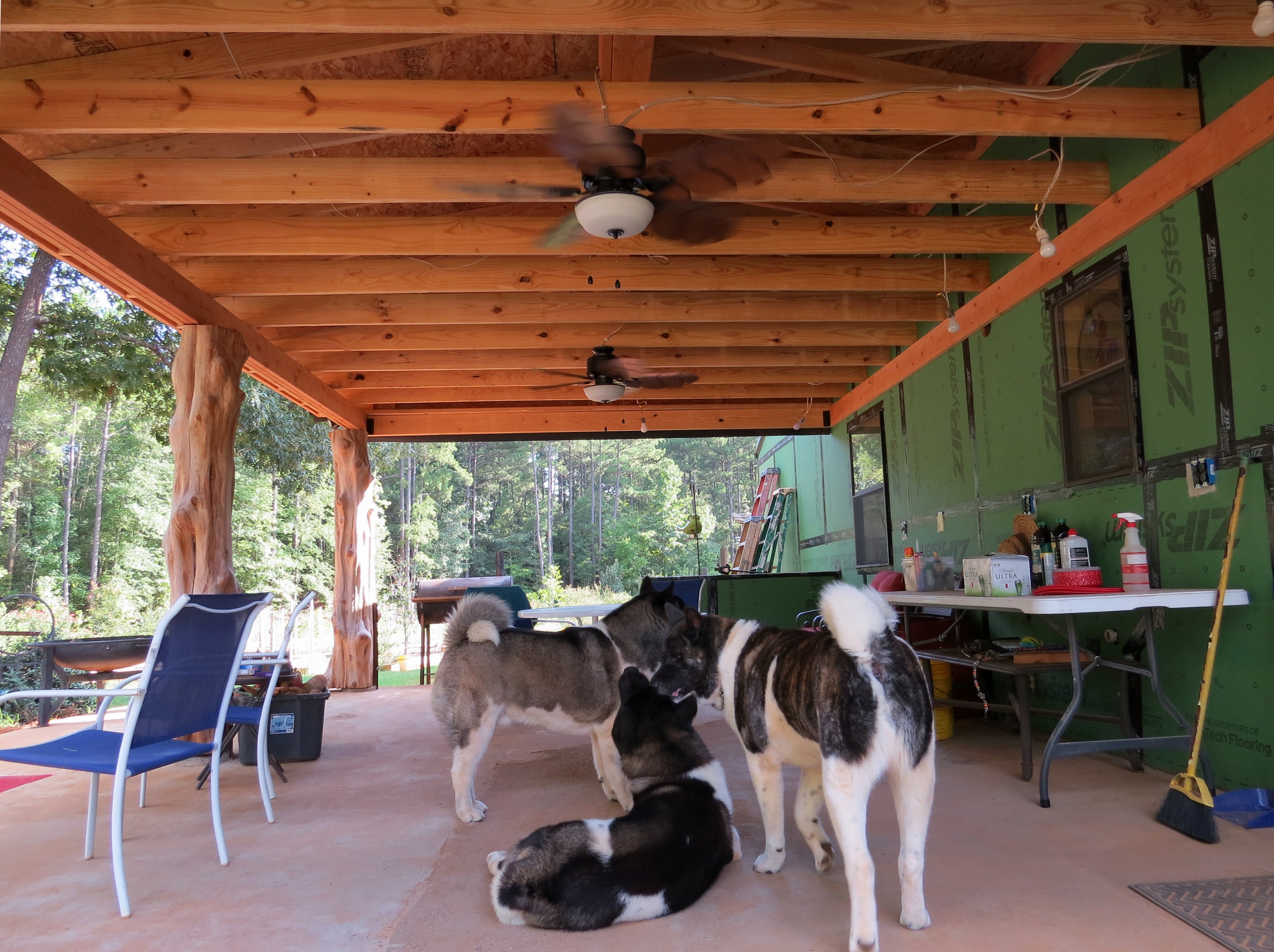

While waiting for the thinset to get here, I've been working on building the new porch. Originally it was 9x12, which was fine for protecting the door, but terrible as a place to hang out. The new porch is 16x24, which is as big as I could make it and have it all fit together. Over my posts, I ran three 2x8x24 to creat a beam. Then I ran 2x8x16 from the house to the top of the beam for my joists. My rafters are 2x6's cut to fit, and there is a L beam at the center of the span made from a 2x6x24 on the flat and a 2x8x24 on the edge. I then added 2x4's to truss it all together. My inside corners overlap, and there is a heavy metal bracket on the inside of each corner with 8 3 inch long lag bolts to keep it all together. I decked in in OSB and will install the metal R panels when they get here. I ordered them last week.
We have really enjoyed it so far. The roof has allowed us to sit out there during a storm and not get wet.
The two ceiling fans put out enough air to really make a difference. It's just very nice being out there even during the heat of the day!!! Even out Akita's like it. A lot of the time, the two boys will be spread out, laying under one of the fans, sound asleep.

Nicely done as always Eddie would you mind sharing brand of outdoor fans you like to use ours lasted 12yrs and have now quit. Thanks in advance
   / Akita Pool
#198
Thank you. They where at Home Depot. Lowes had pretty much the same thing, but the Home Depot ones came with LED light bulbs. I didn't recognize the brand, and I can't say how long they will last, but so far, they have been very nice and both where perfectly balanced!!!
   / Akita Pool #199
Nice patio Eddie. are you going to put a ceiling under the joists, or any type of insulation under the metal or decking?
   / Akita Pool
#200
The ceiling will be tongue and groove. On top of the OSB decking is 30lb roofing paper, and on top of that will be the R panels. Insulation crossed my mind, but I didn't think it would accomplish anything out on a porch. Should I rethink that?
