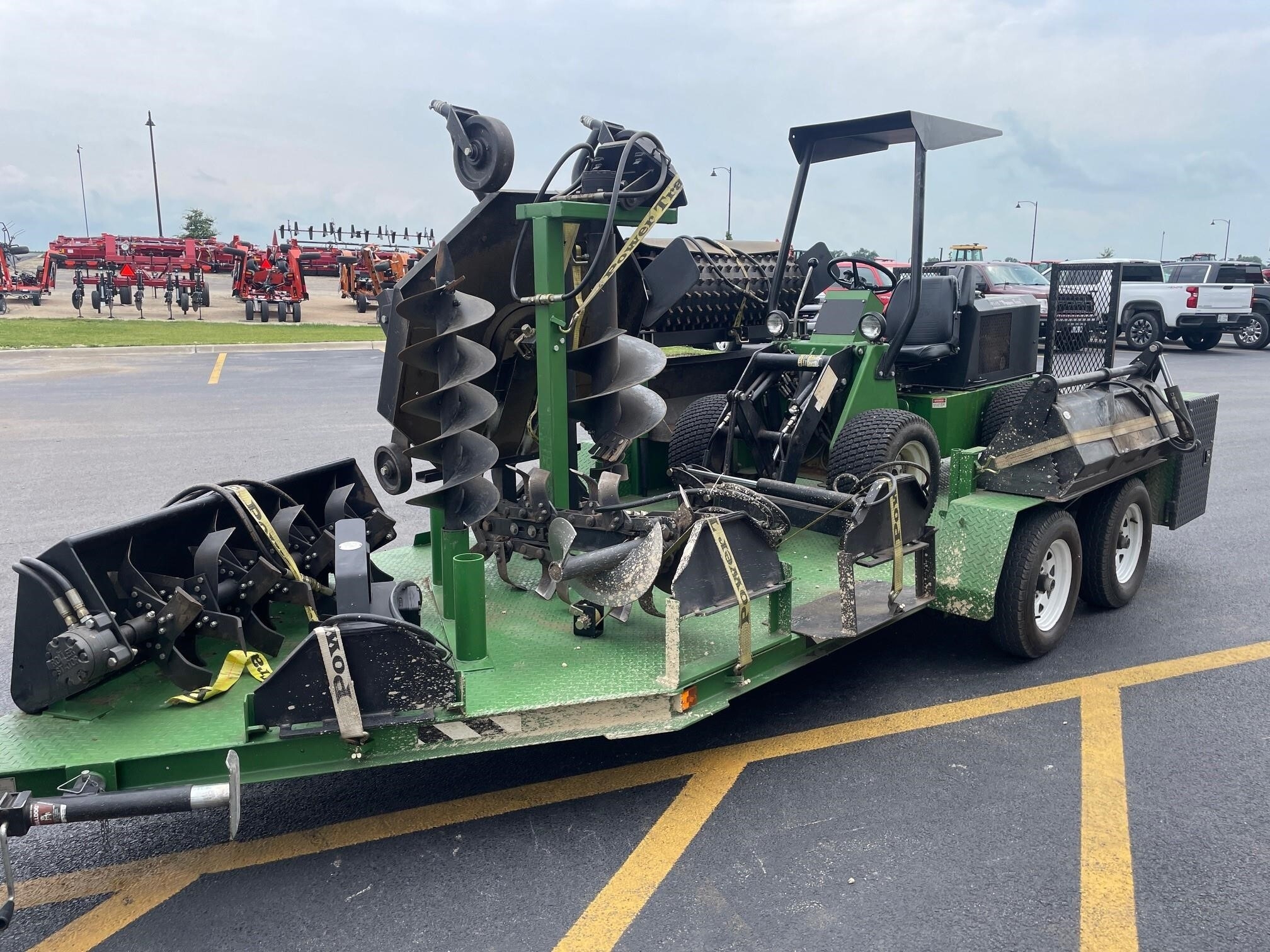

I am not sure how much the power trac trailer with attachments weigh but i move mine in my yard all the time, it is heavy enough that i cant turn all the way without lifting my rear end of my 2425, but it will move it all over the yard even with gentle the slopes i have. On the trailer is the auger unit 12,19 and 24 inch auger bits , power rake, 4 foot tiller , smooth bucket, grappler bucket, ditch wich and stump grinder. It lets me know its there but moves it ok. I dont have a ball mount to hook into the trailer so i utilize the safety chains and hook them on the Quick attach and away i go. If the trailer trys to get away from me i can tilt the quick attach and drop the chains as a last resort putting tounge on the ground or just dropping the trailer toungue to the ground to controll the situation .

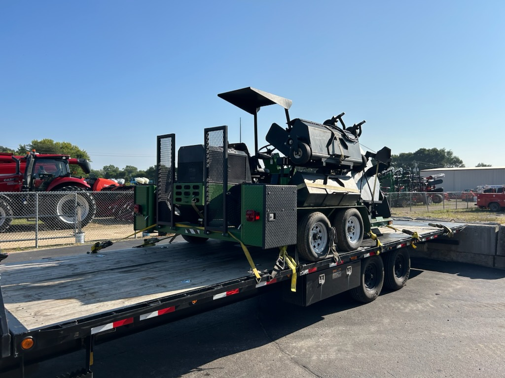

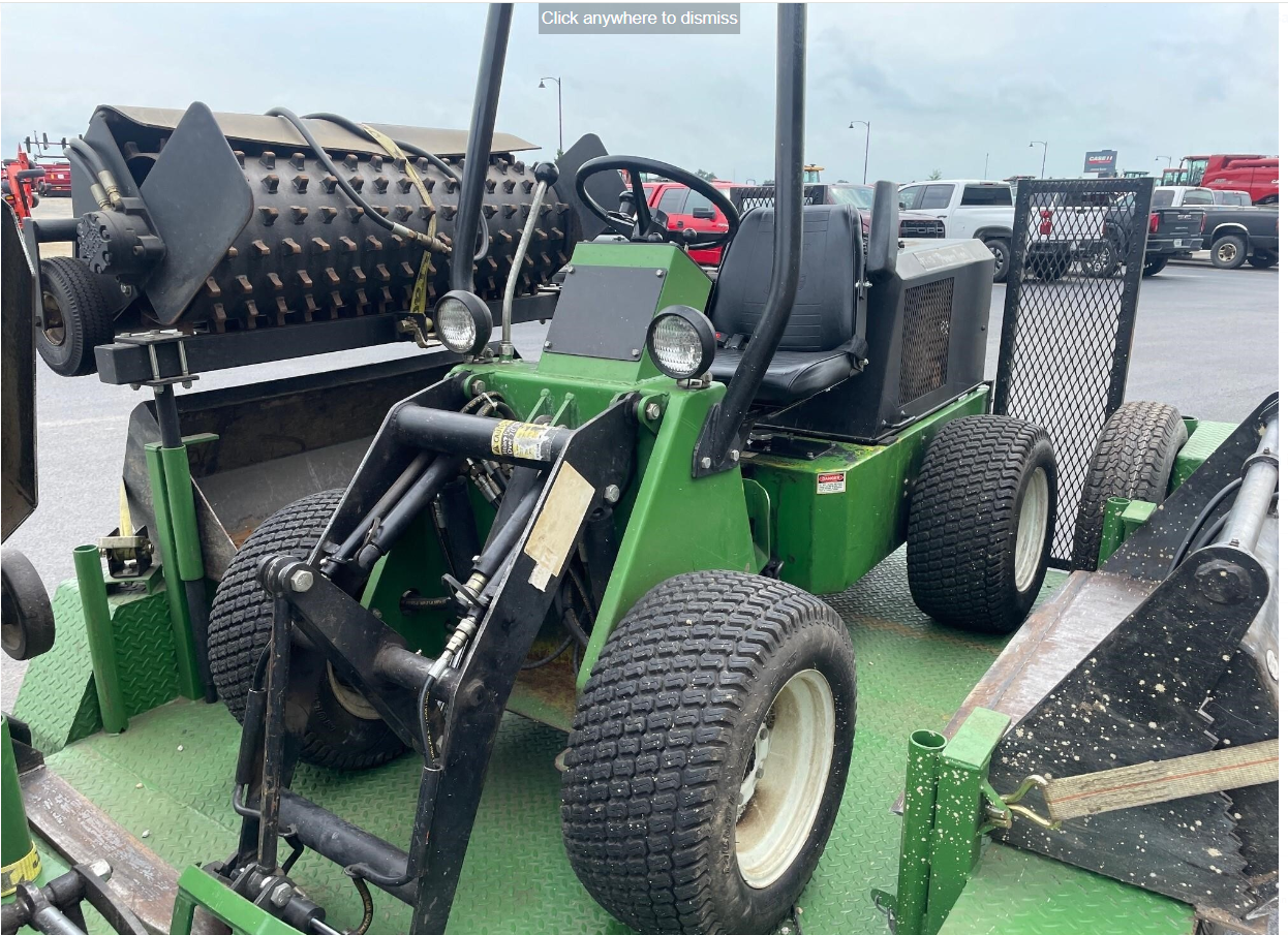

Very useful information! I just bought this site unseen and it is on it's way to Tazewell to be checked out today. Hope it turns out well. It's 2003 with 650 hrs.
