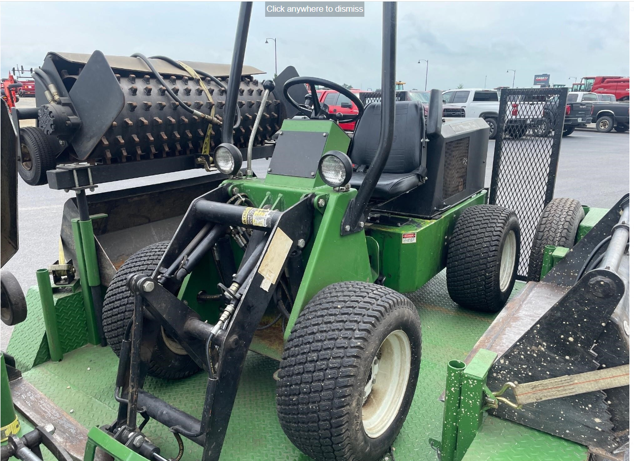

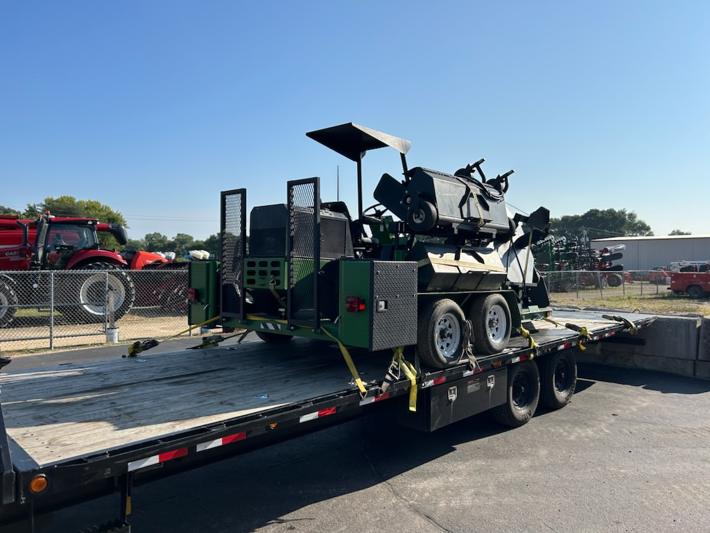

Very useful information! I just bought this site unseen and it is on it's way to Tazewell to be checked out today. Hope it turns out well. It's 2003 with 650 hrs.
