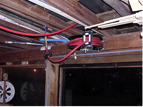

SPYDERLK said:
That reminds me - get a 50' hosereel that you can hang. Keeps the hose just the right length.
Larry
got that - only for the space the reel has to be mounted flat, but it works reasonably well.
