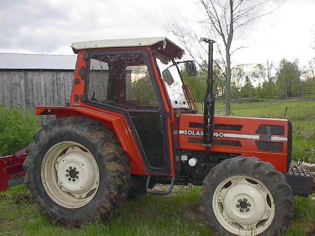

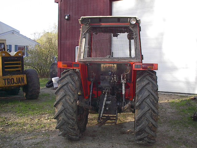

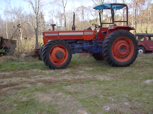

I never heard of Oliver using SAME, I know they used UTB that was a Romanian tractor sold as a 1250 Oliver 5040 Allis and 445 Long.
Some of the AGCO were SAME I don't remember the numbers that they were rebadged to.
Oliver 854 - Page 1 [#777401 / 777401]
Here is a link to the Oliver SAME. I think White Motor Company, who owned Oliver at the time, was trying to find a cheap supplier of low HP heavy utilty tractors. Allis did the same thing. I have seen the Romanian built Olivers and Allis Chalmers. This SAME Oliver caught me by surprise.
