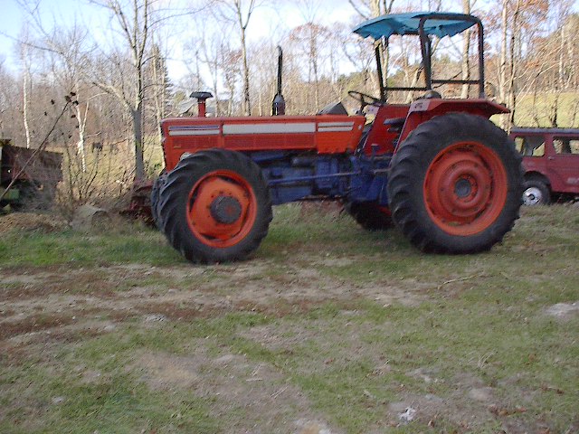

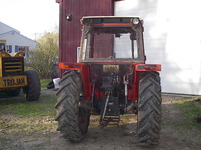

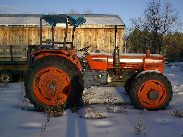

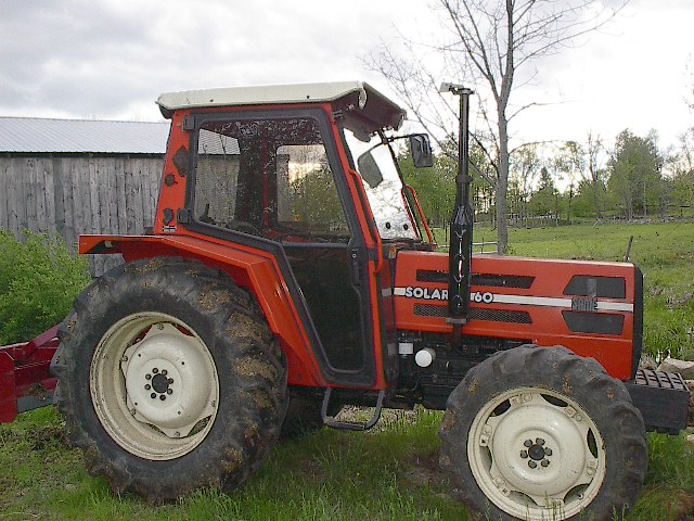

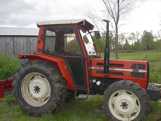

I had a 120HP SAME Drago and a 60 HP SAME Solar The Drago was open station and the Solar had a cab The heat in the cab was electric,and had its own alternator.
The tractor ran on the cool side,running it hard I shot it with my infrared thermometer and the max temp on the engine on a 98deg day was 140 in the winter if I ran it with the vent closed I would have to push it hard to not make it smoke.
The tractors were not noisy as someone said in the previous post.
Fuel economy on both was excellent for those size tractors,The only negative was if you did not use the tractors all the time you have to check the air path and jugs for mice nest,I was made aware of this when I bought the first SAME if you don't you can over heat the jugs.I bought them both used and beat the snot out of them,No repairs were done on either just oil and filters.

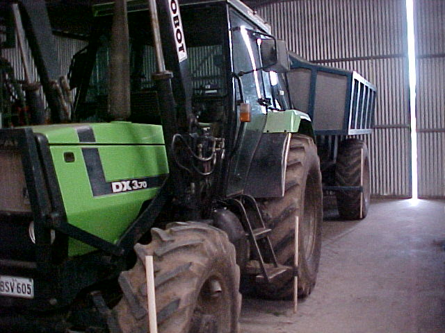

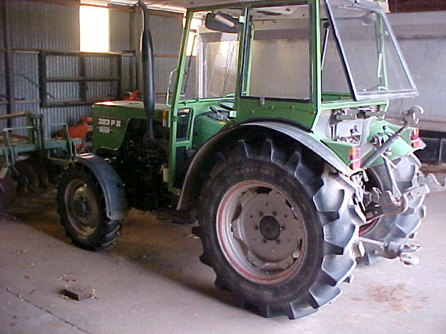

Two of my three air-cooled tractors
MVC-020F.JPG Fendt 203P, 3 cyl Deutz of a little over 3 litres, 57 eng hp.
MVC-012F.JPG Deutz DX 3.70, 4 cyl Deutz of a little under 4L, 70 eng hp.
Both simple, reliable tractors - no cooling problems.
