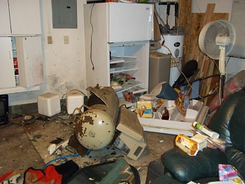

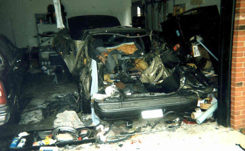

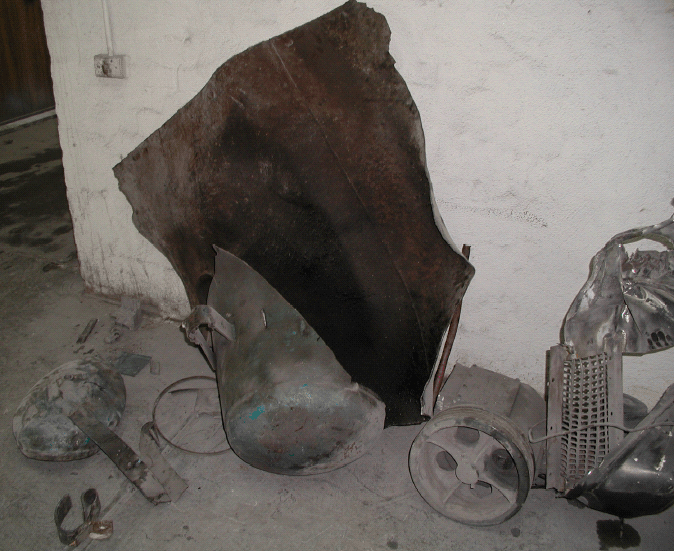

Once again it is better to look for a replacement tank from a shot compressor due to unseen metal fatigue/cracks.
this is the outcome when one releases. it is not always a small leak.
best to look for a newer tank, and solve the vibration problem.

I've added a few more pics
Tom
