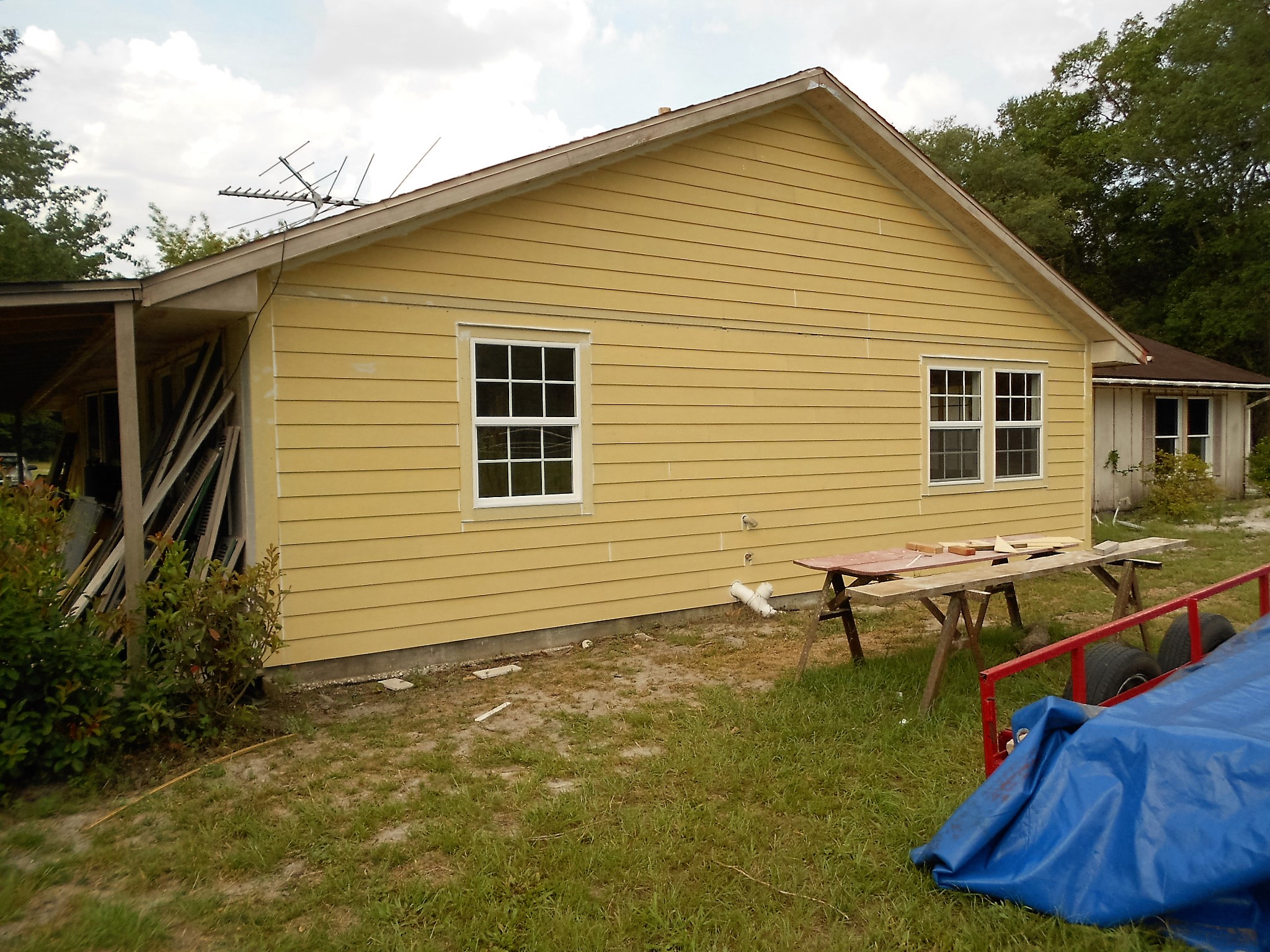

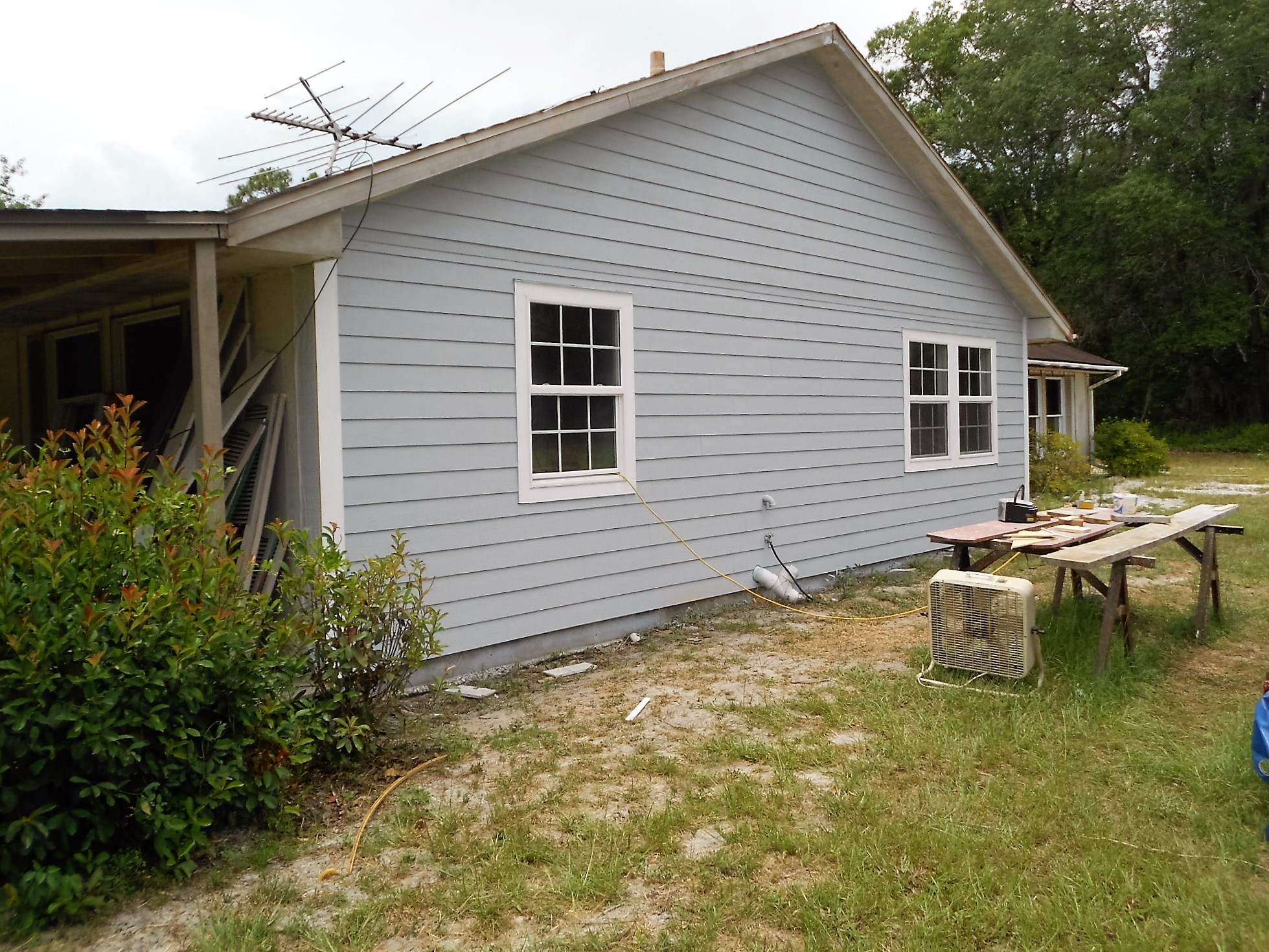

I painted this 2568 sq ft house just last summer with a Graco 390 sprayer that I found on trash day!
I had to spend 2-3 hours cleaning the sprayer after I found it and there was no hose or gun with it.
Again, it takes longer to move ladders than to paint.
I had a bedroom ready to paint and had extra paint so I ran the hose and gun in a window and sprayed the bedroom the same color as the outside.
I made a 4' cheater from a piece of aluminum sofit that worked great for edging.
