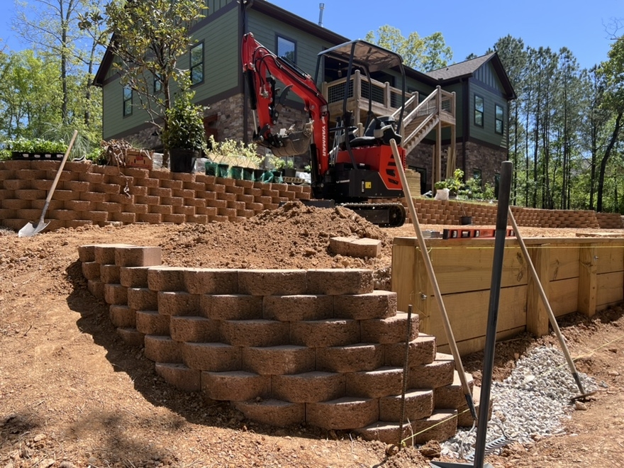

I have an AGT DM12X-C bought in July 2024 and have a little over 50hrs on it digging footers for two retaining walls and digging holes to plant some trees. So far so good other than some overheating. I added an oil cooler to it which helped a bit, also added a counter weight. The thumb bent so I had to beef it up. I also welded 2" extensions to the track tensioner bolts because I couldn't tighten the tracks enough, they kept coming off.
   / Agrotk excavators: Does anyone have one? Opinions/comments/critiques? #200
Why does it say Yanmar on the boom?
