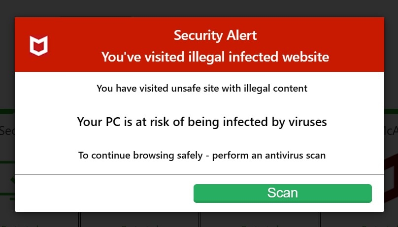

I will be reading a long story or watching a long video and when I start getting close to the end, this McAfee popup comes on my screen blocking it. There is no way to get it off except hitting control, alt, delete and using Task Manager to close the browser. Then you have to restart the browser and start over at the beginning at whatever you were doing.
I have good virus protection on my computer and have never had any problem with viruses since I installed it a few years ago. I have never had McAfee on this computer. I'm wondering how I can prevent this from popping up again.

This is a push notification to your browser. What are you using? Chrome, Firefox.........you'll need to reset the push notification settings for your brand of web browser. Go to Settings and search for notification and block any new request for notifications, remove the current ones.

If you hover over the "scan" button BUT DON'T CLICK ON IT, is there a web address that appears in the corner of your screen?
I'm thinking they are trying to trick you into going to a site where a hacker tries to get into your pc, or they spoof a McAffee site and try to trick you into "scanning" your PC.
I did that and it says http://otrck.com/click. I was just reading a link on nola.com and now this popup came up. Could it be that an antivirus seller is installing malware to get you to buy their antivirus?

I guess it's possible, but highly unethical. So I doubt it's actually being generated by McAffee. I mean it could be, I don't have any feelings about McAffee either positive or negative, but they are an actual "company", and I'd still like to think most wouldn't stoop this low. But I'm still thinking it's a ruse to get you to go to a pirate hacker site and click on something that downloads a virus, or installs spyware on your PC.
I think the only way you're going to get rid of it is to get some form of malware software to remove it. Most antivirus software has trouble identifying "malware" as harmful, so it doesn't get flagged and removed.
That hyper link is NOT going to anywhere on a McAffee website. I certainly wouldn't click on it myself.

When I bought this computer it had a program on it that tried to get me to buy McAfee. I uninstalled that program but evidently it left files on my computer. I did a long search for McAfee and finally, under Task Manager, Services, I found McAfee WebAdvisor that was running. I turned it off and have had no new popups from it yet.
/ Aggravating McAfee popup #20
Next time you start your computer I'll bet WebAdvisor will reload. You need to find that file and delete it, if you can. Make sure it is not running or you won't be able to delete it.
