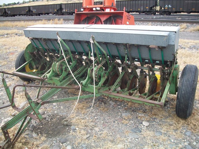

My dad says he has an old Deere grain drill with all the blades and crap removed that they used to use as basically a drop seeder. It’s almost identical to this one, but smaller. Do you think it would work for ag lime?
that should work if the agitator is still in it . If not drive it like you stole it and let the rough terrain do it

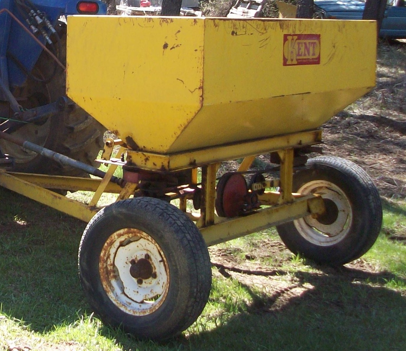

I知 in search of some kind of implement that I can use to spread ag lime on my food plots. I need to spread about 6-7 tons of ag lime. Pelletized lime is going to be ridiculously expensive for the amount I need. There are absolutely NO places that rent lime buggies within an hour drive of me. There is one guy that uses a spreader truck, but he can稚 fit it through the trails on my property. So I need to figure something out that I can use to spread the lime myself.
I have a tractor and loader, but I can稚 seem to find anything that痴 not crazy expensive to use to spread the lime. My grandpa said you could spread ag lime using a small seed drill, but I can稚 find anything online to support that. Seems like it would need some kind of agitator to keep it flowing.
Any advice?
Something like our Kent would probably work, also branded as Co-OP worked well for spreading pellatized lime
I am not sure how it wooould do with the ag lime.
Just a thought if you find something similar.
