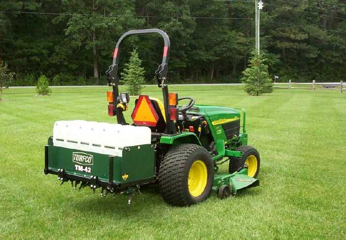

I have been very happy with my Turfco TM42 behind my 4110.The working width is almost identical to the tire stance. The weight jugs allow you to take the weight up above 500 pounds. The coring pattern was one of the best I could find when I bought it two tyears ago. I paid around $1,000 and I think the have gone up a couple hundred bucks. The spoons are angled to enter the soil as vertical as possible, but they do "drag" out of the hole a bit like most aerators. This really doesn't cause any turf damage to speak of as long as you set the unit to level while operating. The pattern is tighter than most and it pulls very nice 3-4" x 3/4" plugs. Pic attached taken this morning before I worked over my lawn for the season. Their company site appears to be hijacked by some German company right now @ turfco.com

Here is a cropped side view that might give you a better look at the angle of attack on the tines. I think many other aerators use the same principle, but there are more tines per square foot on the Turfco than most.
