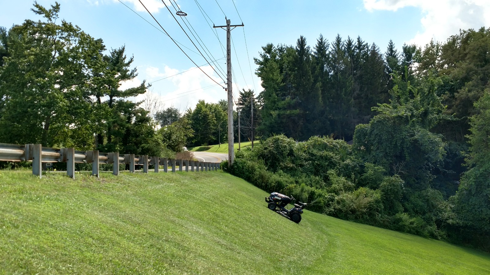

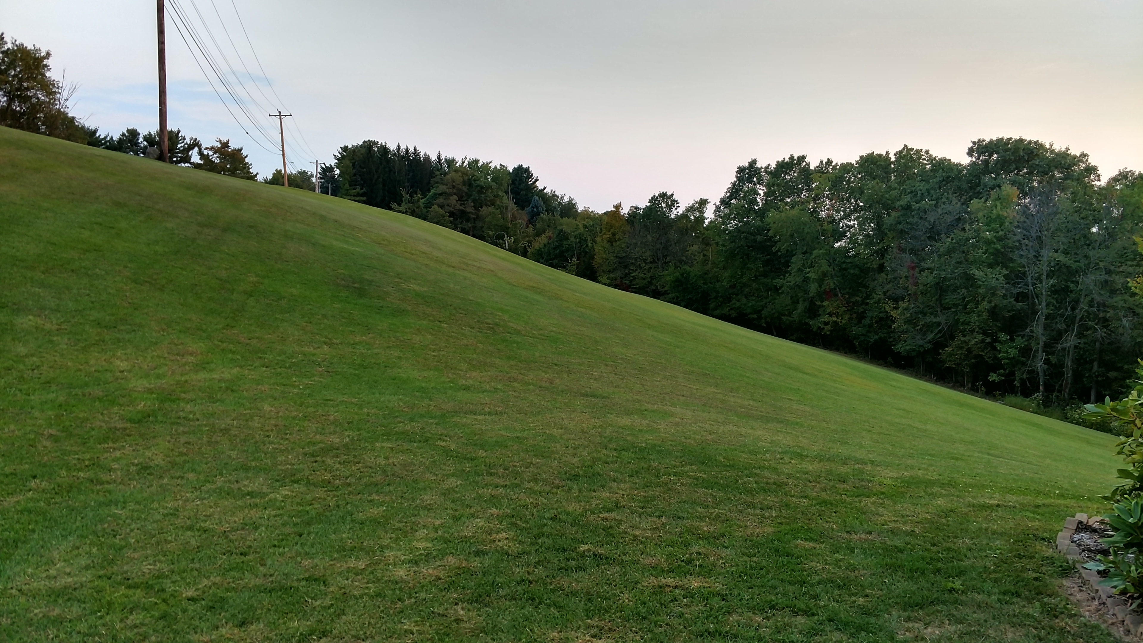

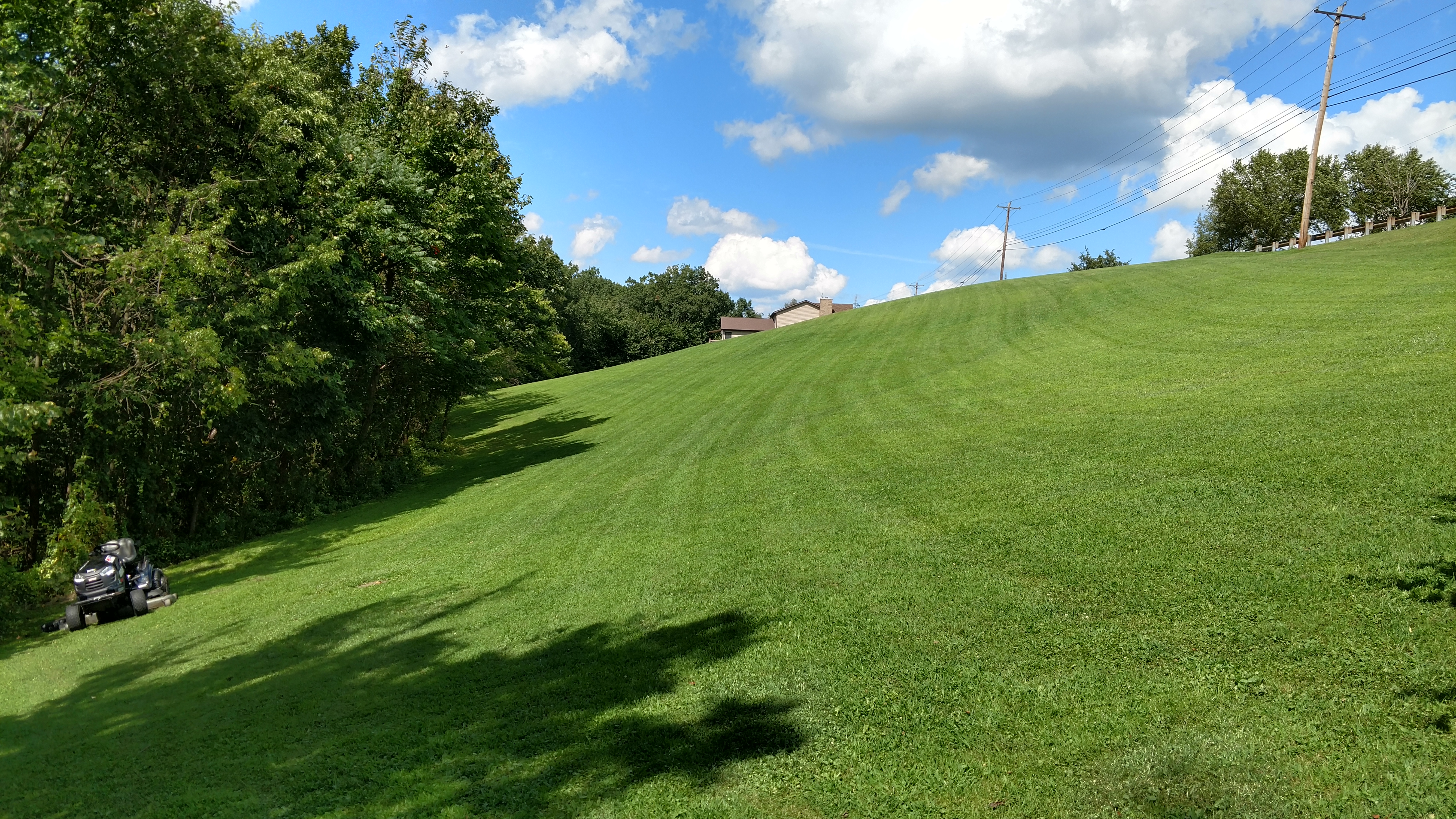

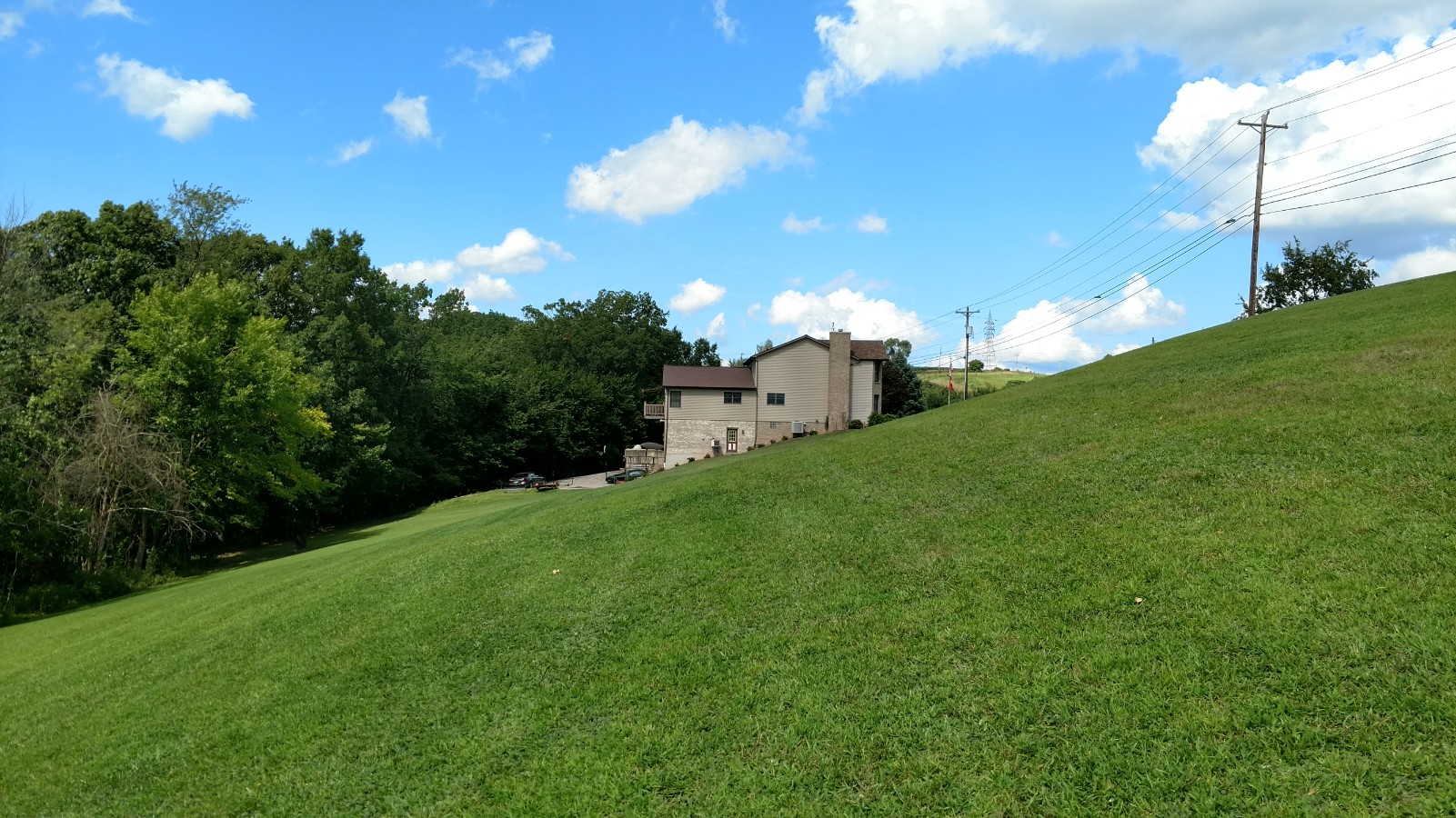

I have about 3 acres, 0.5 acres of 28 year old SOD that is treated 2 times a year by a company I pay $85 each time, and then 2.5 acres of what once was a hay or straw pasture. I keep all mowed short and tight. What I want to do is convert the 2.5 acres less into broad leaf and wild grass and more into a thicker grass typical of a home yard.
Do you plug and then seed and follow with a roller?
I'm looking at renting a large Woods 3-point plugger ($95 for a day) and then I have a 435 LB 42" roller, but I have access to a 950 LB 66" roller. I want to run my 2.5 acre pasture and try to get more grass rather than the naturally occurring grassy stuff that inhabits the old straw field. You can still see the difference 28 years later between the sod around the house and the transition to the wild grass.
I'm also thinking of fertilizing the 2.5 acres with Scott's fertilizer with the broad leaf/weed control, and mixing in grub control as well. I have quite the mole city that I would like to chase back into the 12 acres of woods behind the yard.
My fear with the Scott's product is... what if I spread that out here in the next month and essentially kill the entire 2.5 acres and end up with a dirt yard!
Photos of the 2.5 acres are attached.
I'm not well versed in lawn care. In my life I have simply paid the fellow to spray, I cut/trim and it is what it is.

Your landscape is beautiful. Mine is pathetic. Most folks around here plug and reseed in the fall. Usually here that is in mid September until mid November. Without water the seed will not do much of anything.
Never tried the Scott's products. I am sure they are excellent but pricey. We just stick to regular triple 17 and lime. The soil around here needs lime.
My mother has a professional landscaper take care of her place. That is his procedure. He does use slow release fertilizer but I don't know the specific product. Her place is immaculate.

WOW....that is some steep terrain to mow.
Go out right this minute and put down some pre-emergent fetilizer. I put down about 200lbs per acre of the crabgrass preventer that can be bought at rural king.....do it now and again in April. Keep the broadleaf sprayed all summer.....then in the fall aerate and overseen in September with a tall turf type fescue.....that is about it...get soil samples and amend according to analysis.
Theo there option is to do nothing.
I have been doing this lawn fertilization and overseeding for years.....roller is NOT necessary. I have a 1st products aeravator.....look it up....it is hands down the best aeration tool on the market....watch for Craigslists adds in your region....several states and see if you can't find one....good way to make some extra $$ as well. I sold my first one and had a guy drive 6 hours one way to buy it.

LOL, that is the "flat" part of my property. It's steeper down into the woods.
That machine your referring to.... WOW! $7,400 for the 60". That is more serious than I am willing to buy in to! That is one bad to the bone machine with the vibration on top of the plug knives. But the expense is far past my imagined budget to try to improve my yard.
Is there a way to buy bulk (non retail) pre-emergent? At your recommended rate, I would need around 500 lbs, at $60 per 40 lb retail bag of Scott's that would be $780 per application in Scott's. That seems really excessive.

For the projects I do, I spray 2,4-D amine in the fall when it's cold and the leaves are gone. The product is less volatile then and you kill broadleaf weeds with less collateral damage of bedding plants. It works great and make sure to do before a hard freeze. I use a 20 ft wide boom spryer but you can buy a 10 ft wide version from the farm stores that works great.
Spraying fertilizer sounds great but does not work in confined areas like edges and corners where a sprayer can't reach. I use a Vicon, now Kubota 1000 lb dry spreader and it takes just a few minutes do a beautiful job. The Earthway model posted earlier is also an excellent idea, does a good job and is perfect cardio exercise. It just takes a while. I would not be afraid of the Earthway model and use one occasionally.
For fertilizer, the best idea is to do a simple soil test and do what they say. Likely it will be a 21-2-10 or similar. You don't need the middle number--phosphorus--because most of it runs off and it's a severe pollutant in waterways. Best time for fertilizer is early summer and late fall. If you going to do it only once, go for mid November and something like 31-6-10 @ 250 lbs to the acre or whatever the soil test says.
Spring fertilizer invites disease so if you want to do it, put it on after the flush of spring is gone, say late May or early June and any fertilizer is done immediately before a soaking rain. If the ground is dry you could "burn" the grass. On gophers, moles, etc, you need plan to get rid of the grubs that are their food. A few cats does a good job too, just don't poison the cats.
