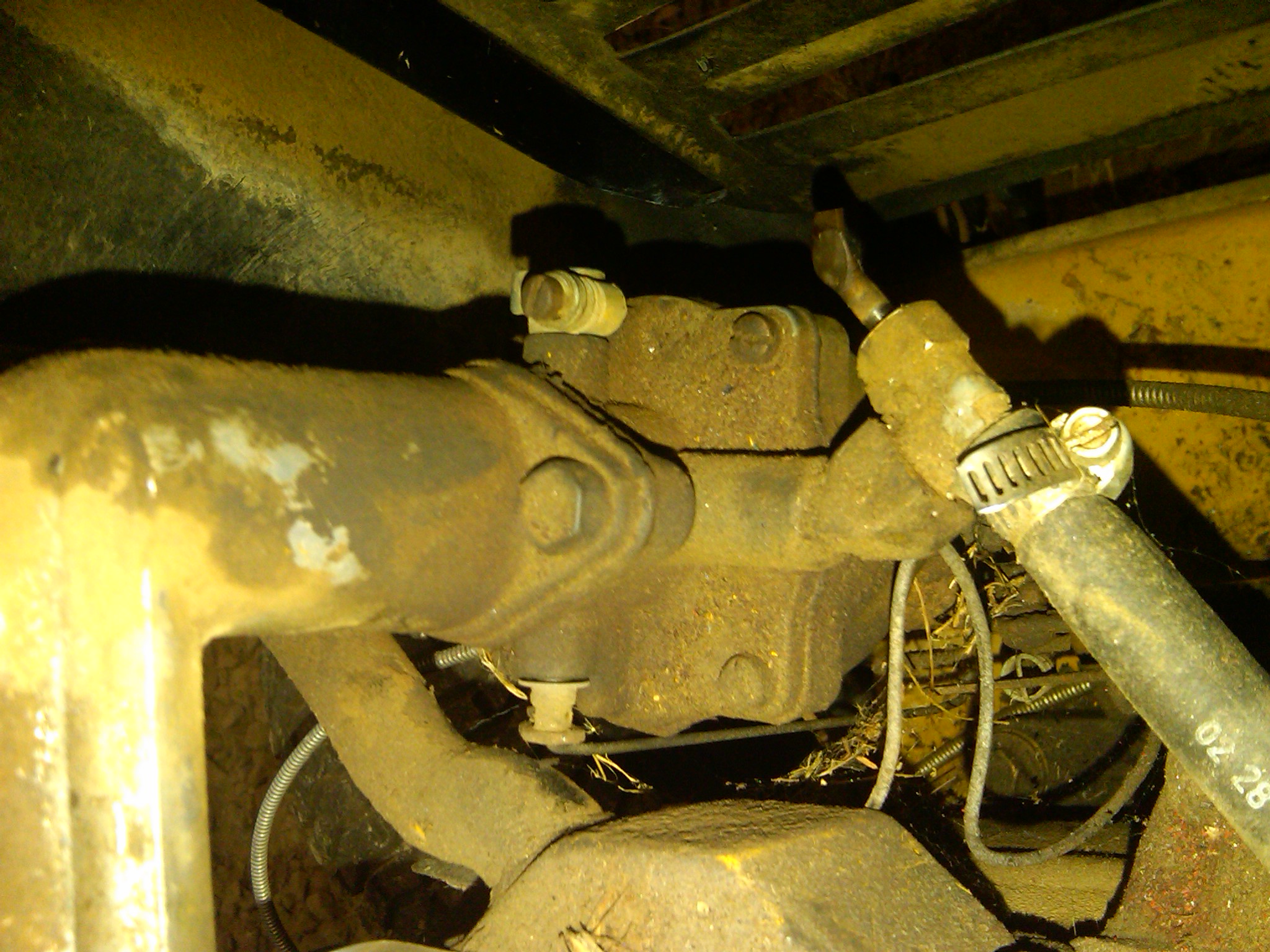

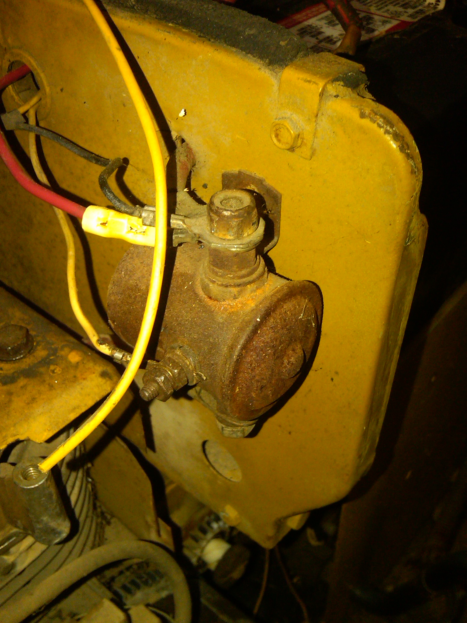

The clicking is from a bad solenoid, that's the part where your neighbor jumped with the screw driver, ot it could just have dirty or bad connections. I would clean and repair the connections first because they will need to be good if it needs a new solenoid.

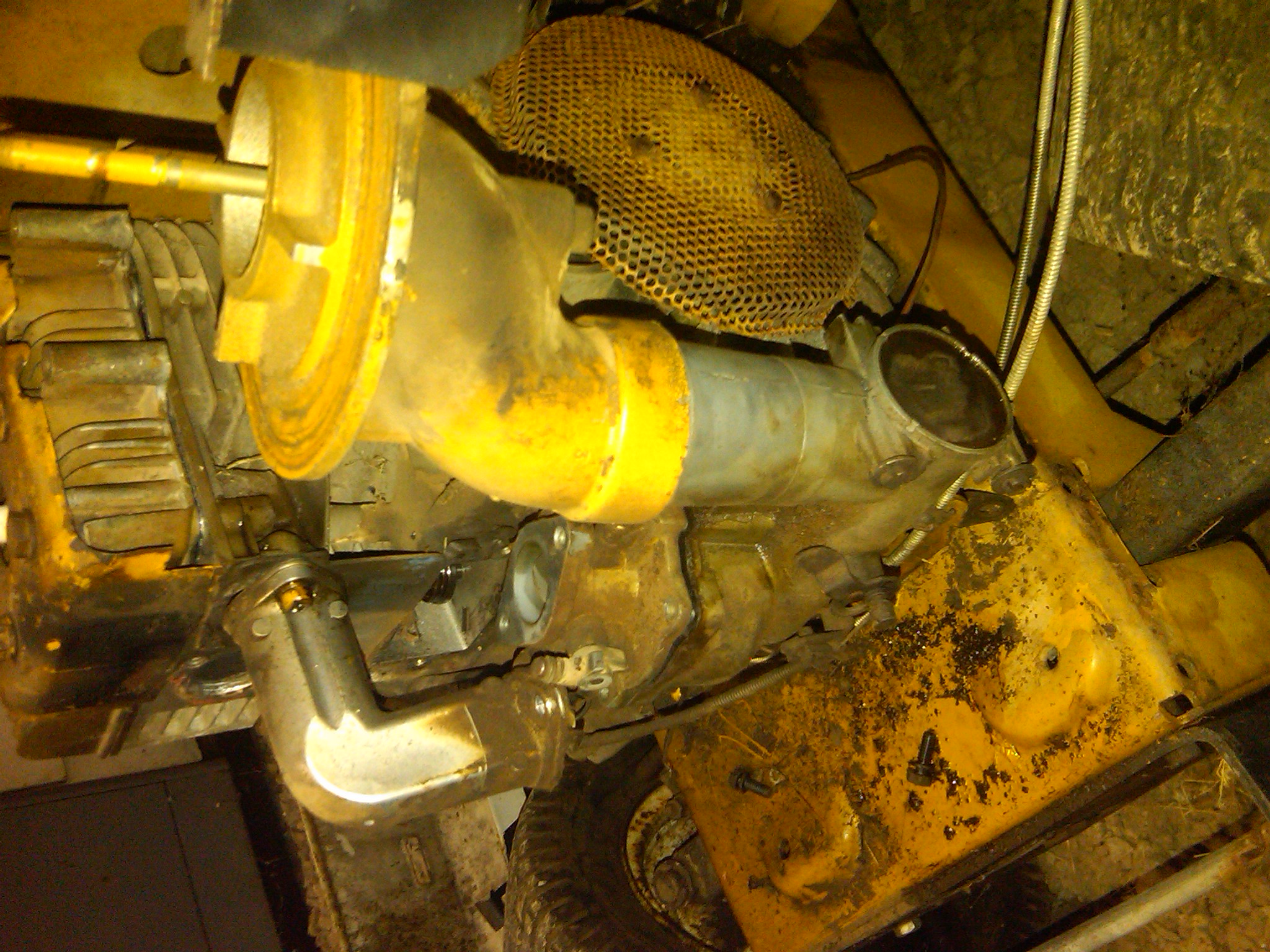

Picture One: In this picture, this is the thing I was talking about where my neighbor took a screwdriver and connected the top bolt to the bottom with it. It gives the tractor more ignition that just by turning the key but t still doesnt want to start.
Picture Two: Just a closeup of picture one.

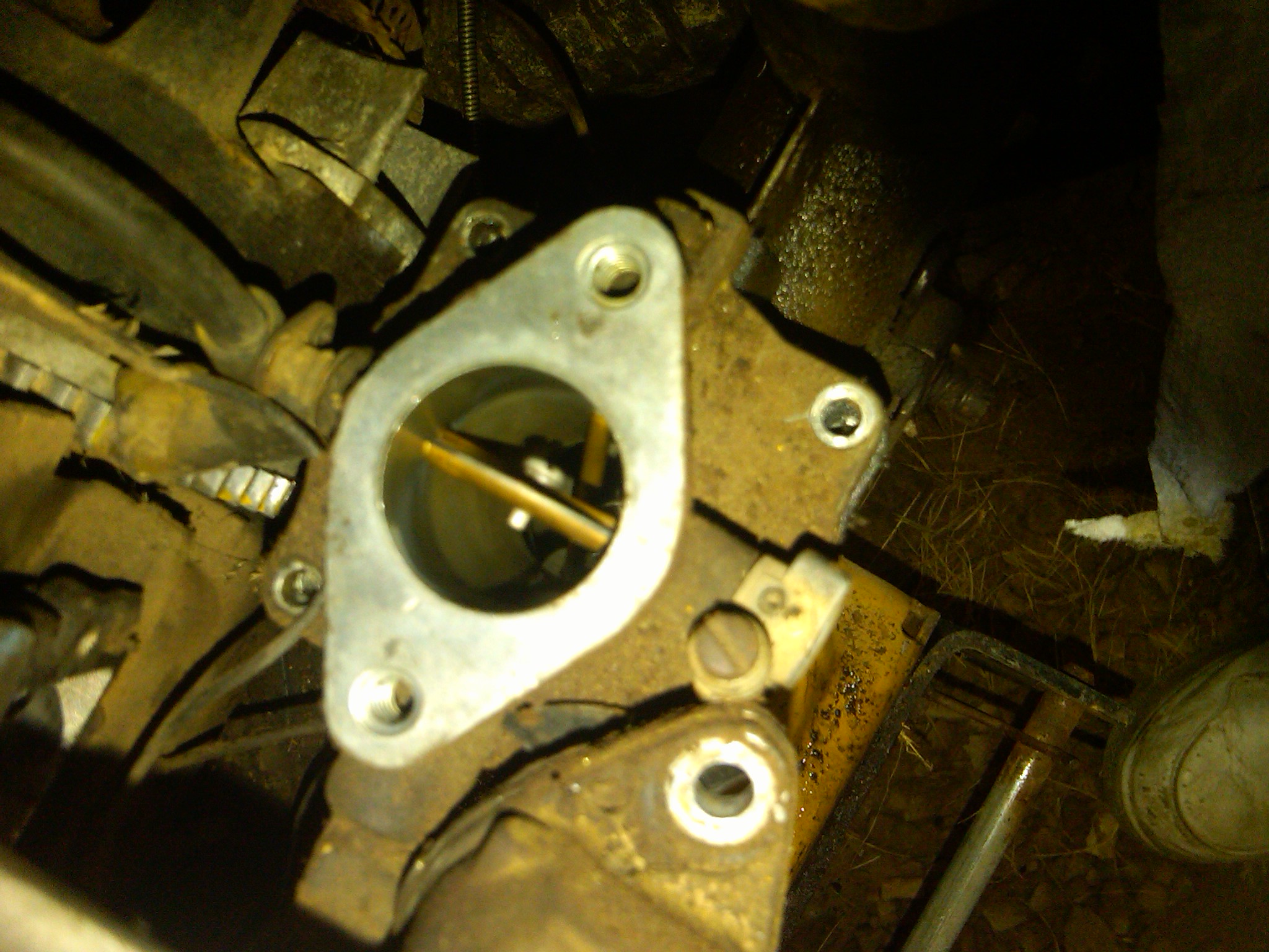

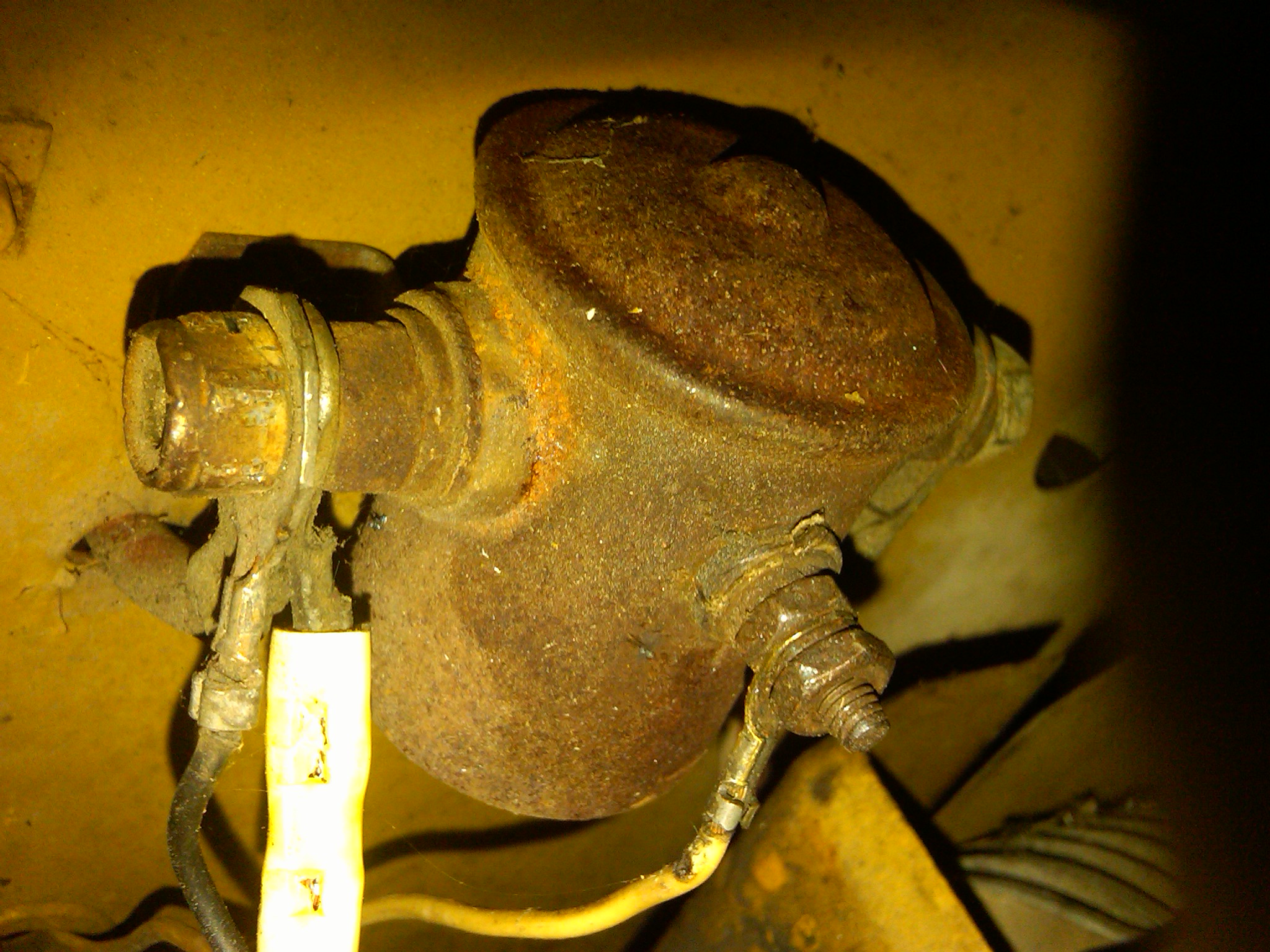

Picture Three: This is the carborator

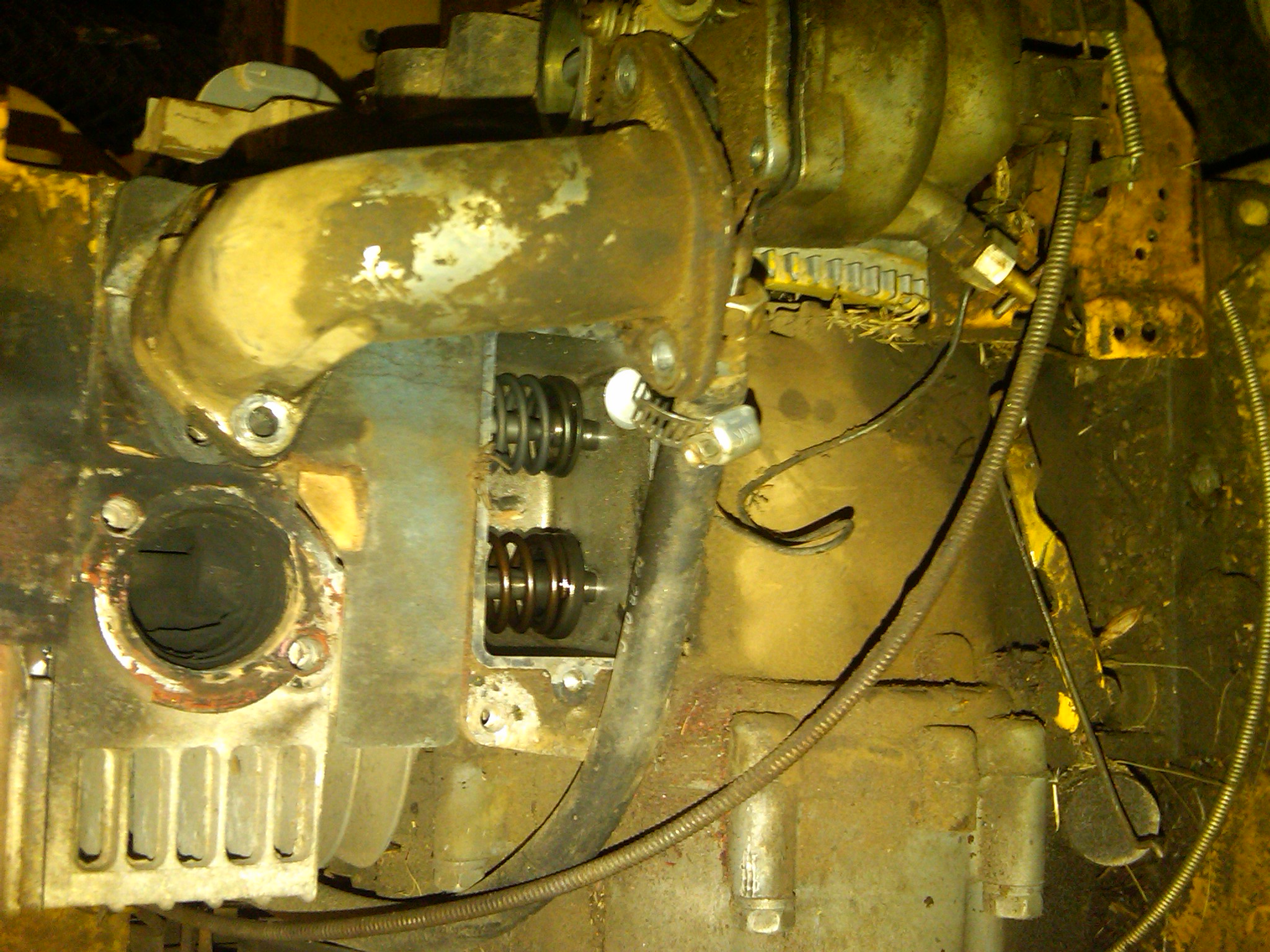

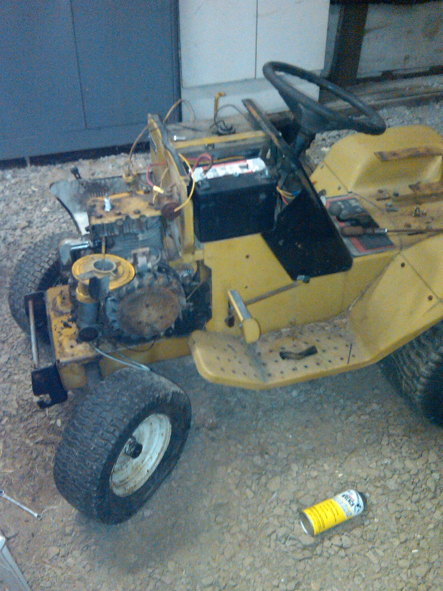

Picture Four: This is what the engine looks like before I started taking things apart.

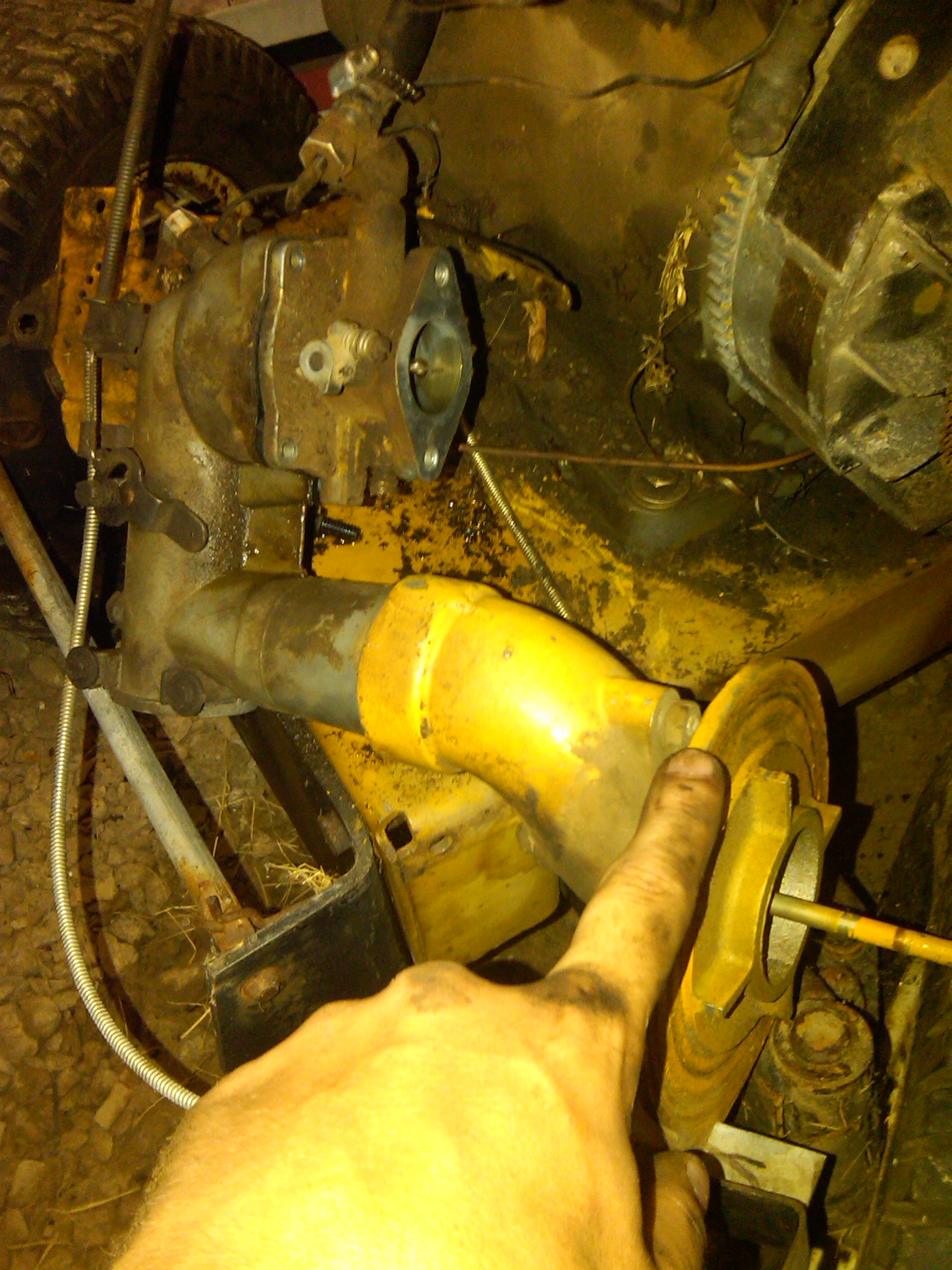

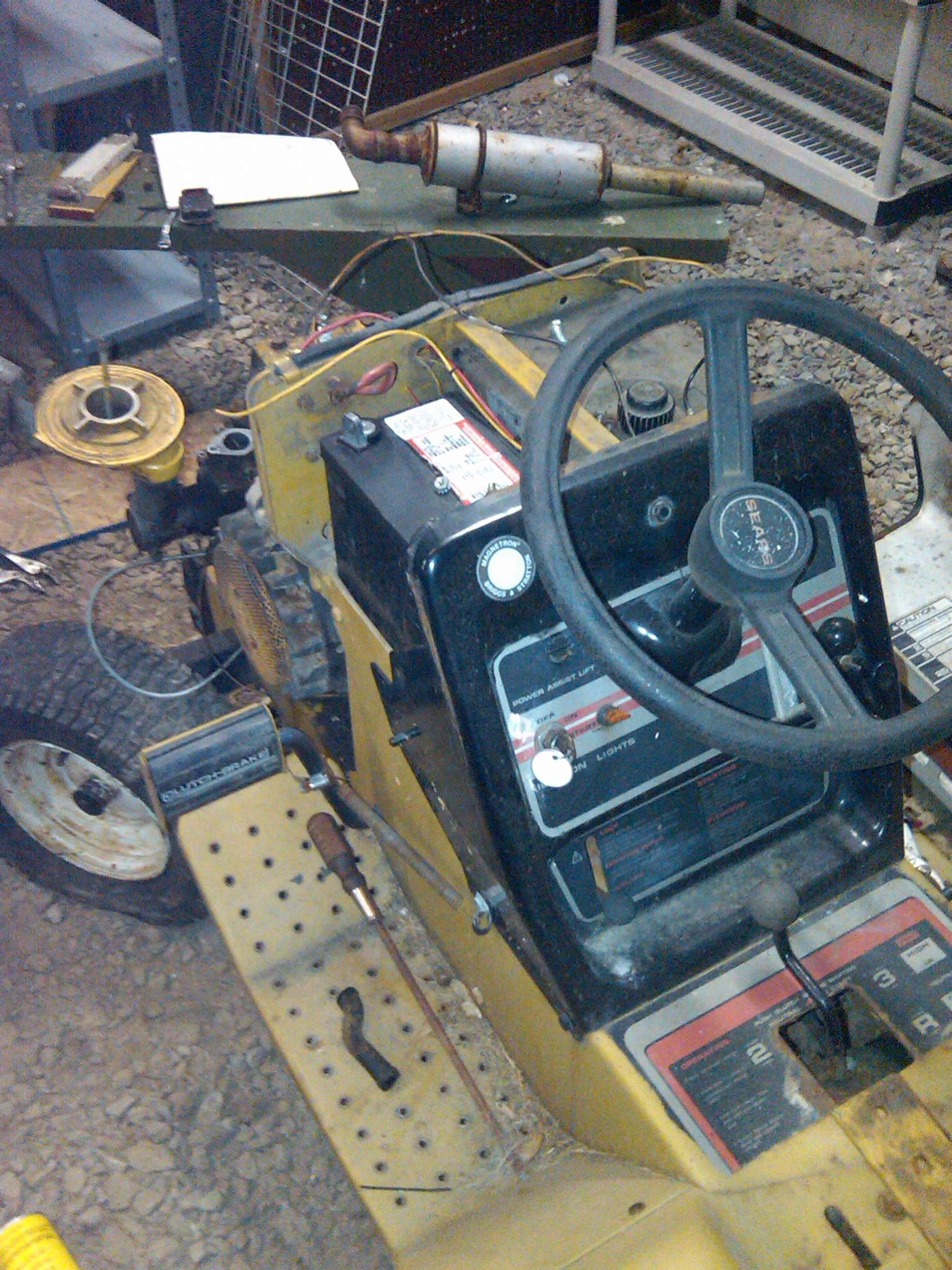

Picture Five:A closeup. I am pointing to the air filter, which is connected to the carb.

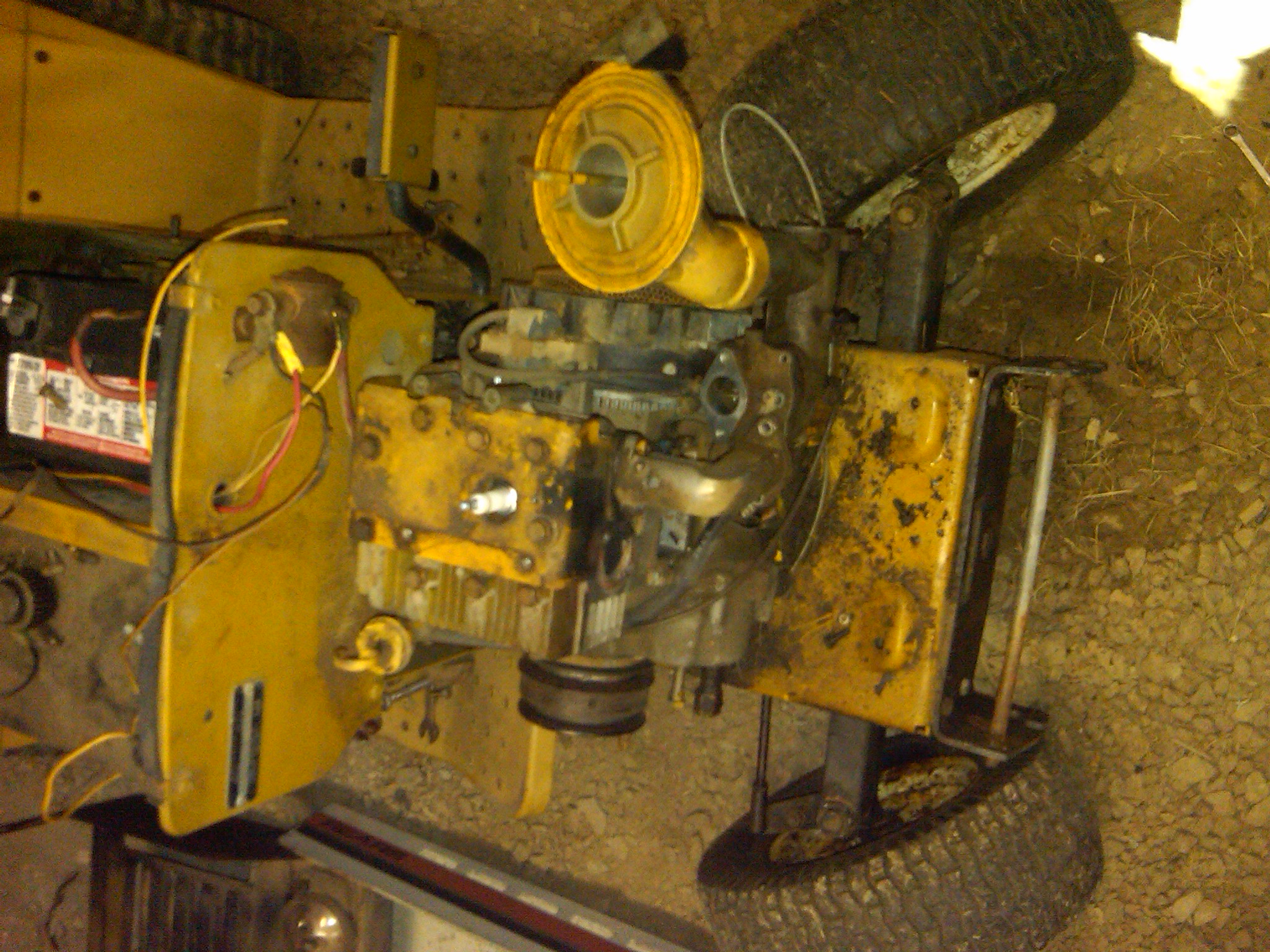

Picture Six: Looking down the carborator

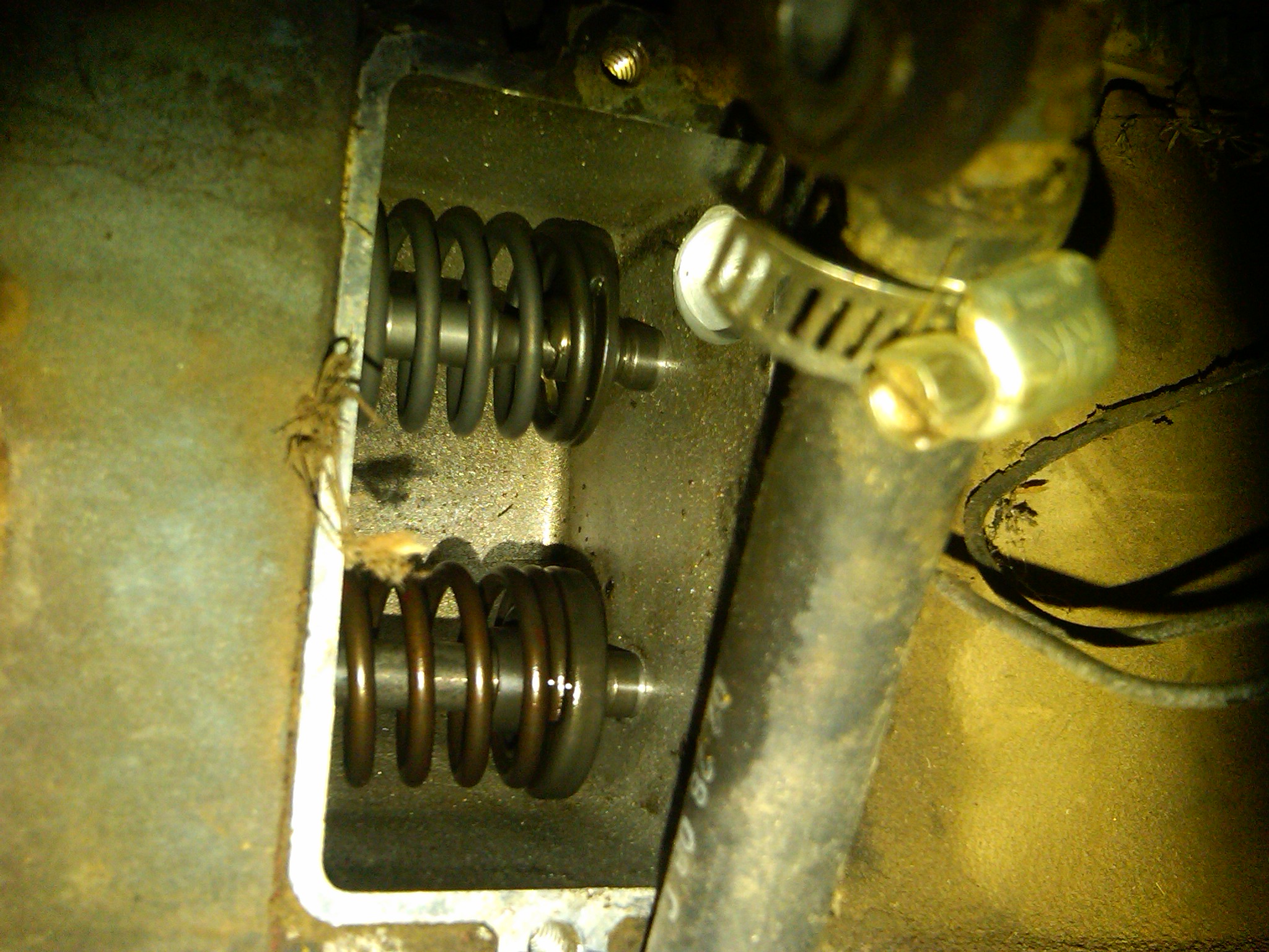

Picture Seven: I am replacing the gasket around the area where those black springs are (again,remember this picture is crooked)
Picture Eight A close-up of those coils

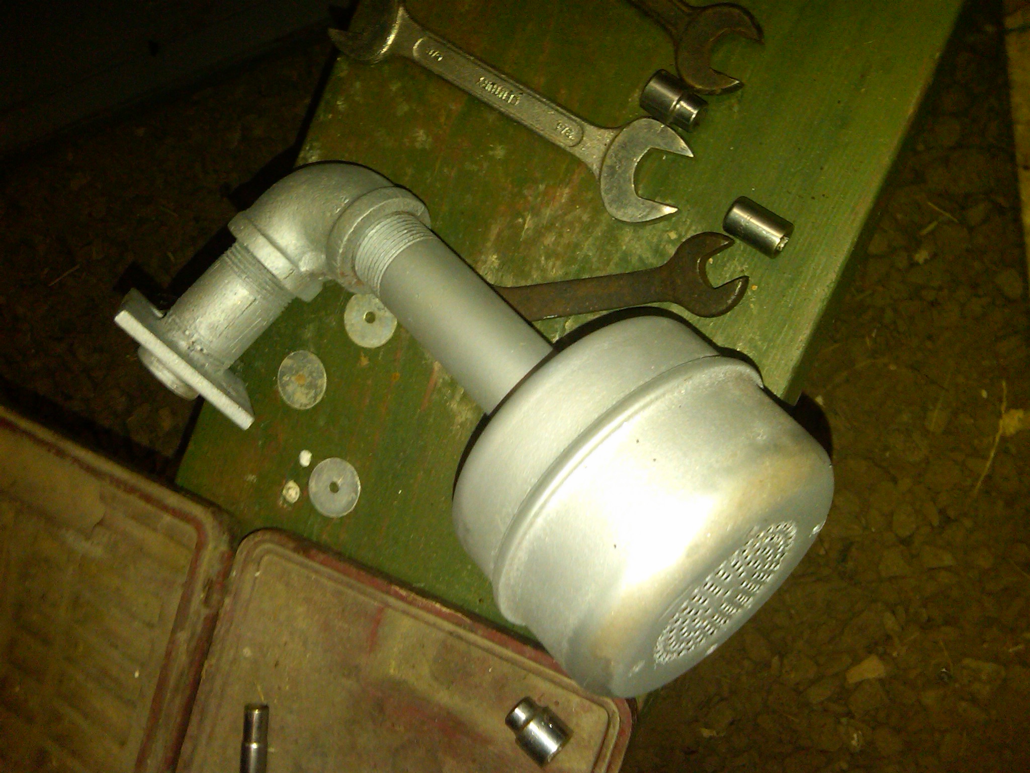

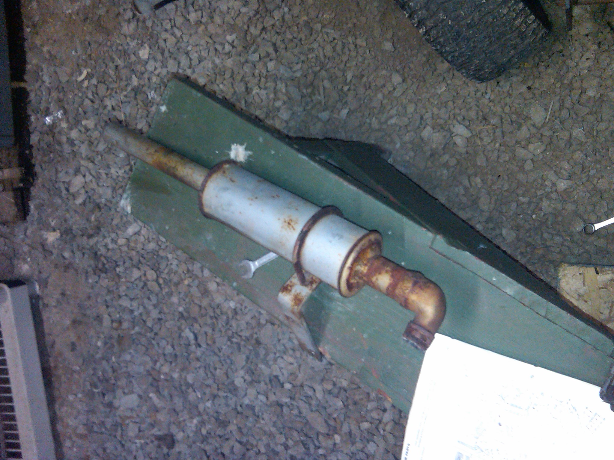

Picture Ten:This is the orginal muffler that came with the tractor. I sanded in and spray-paintedit, however I have not cleaned the inside. My grandpa took it off, so IDK why he kept it.
Picture Eleven: This is the muffler that has been on the tractor for the past twenty five or so years. It hasn't rusted through, and he connected it to the engine using flex tubing and bolting it to the hood.
Picture Twelve: Just to give you a general view of what the tractor looks like (w/o the hood of course)

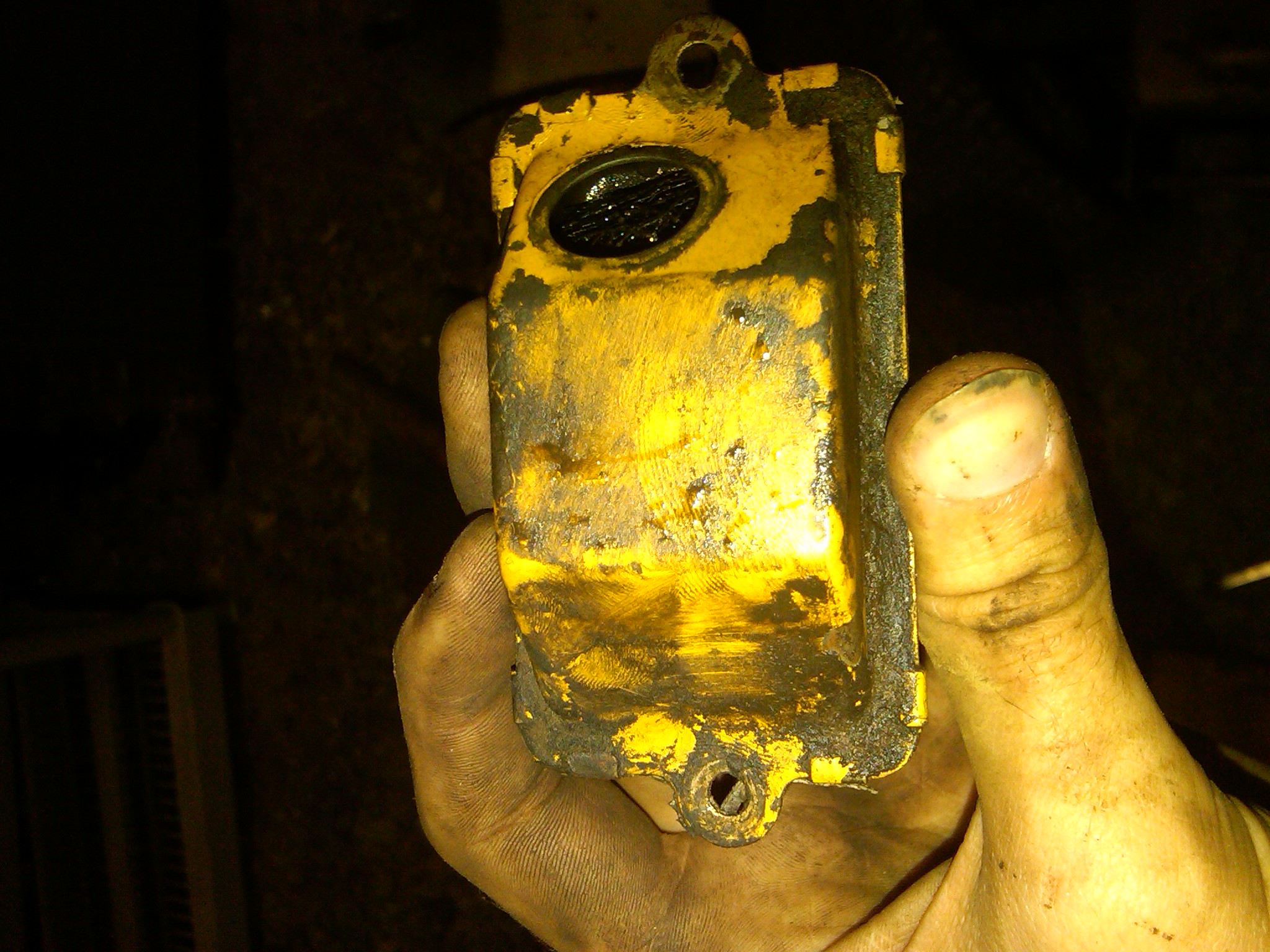

Picture Fourteen: Remember those coils I took pictures of? Will this was the plate covering them. The hole on it is for a tube that connects it to the air filter. Inside of this is a wire brush like substance that was all black and gross. I washed it out with water, and you will get a close-up of it in the next picture.

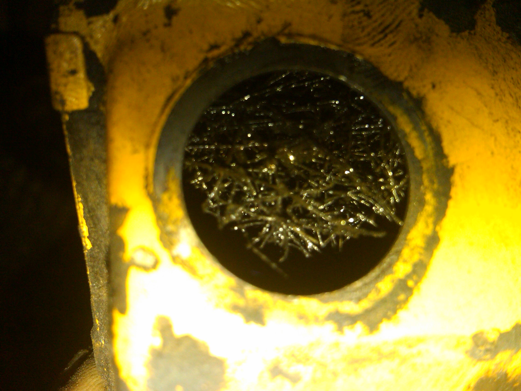

Picture Fifteen:This is the closeup of that wire like stuff. It is all black and greasy. I cleaned it out with water, but I doubt that will do too much. (FYI, this picture was taken post water cleaning)
Picture Sixteen: This is the tube that connects the air filter to the plate with the black stringy crap (pictures 14 and 15)

Picture 1 is the solenoid that I mentioned in an earlier post with a part number and price.

Pisture 8 is your valve springs, you won't need to do anything with those unless it needs a valve job.
Picture 10, I would put the original muffler on, it should be OK as it is, but the paint will burn off. It will smell bad and smoke while it's burning off. Your grandfather may have put the other muffler on to send the exhaust up, he may not have liked it the way it was.
Picture 14 and 15, That's the crankcase breather. The black stuf is a filter, and is black when it's new. That, and the hose work something like a PCV valve in a car engine. It looks OK.
Be sure to download and print the parts diagram I posted earlier, it will help identify parts when you're posting here, and when talking to people at a parts counter.
