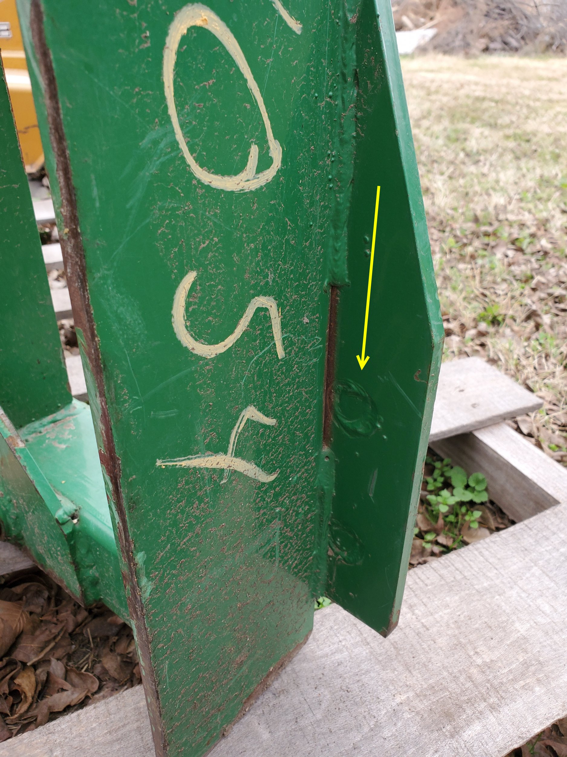

Hi all,
On the hay spear frame I have I need to replace one of the lower quick attach pins.
It is welded into a hole on the hay spear frame and the back side is accessible.
I don't have a torch available and it would probably make a mess anyways.
Grinding seems to be the best option but what to use?
I'm thinking about some kind of pointy grinding stone maybe to cut the weld?
As you can see in the picture with the arrow, the weld is pretty much flush with the plate.
Before I start cutting away at it I figured you guys may have some good suggestions.
Thanks.

That's going to be hard to do without a torch, not impossible but difficult and hard to get good results. Don't know how you're going to get the weld using only a grinder without grinding away too much of the main structure..........Mike
/ Advice Please On Removing JD Quick Attach Pin #5
As Sea2Summit stated. Magdrill with annular cutter. Are you near Middle Tennessee?
What does front side look like? Chain of 3/16" holes and clean up with a burr and chamfer tool?

Sure it will save some cash ... maybe... depends on how neat of a job you do grinding it out. A torch can cut it out in 5 minutes, it'll take you several hours grinding it out. Grinding is complicated by the side frame blocking access.

So the first thing is the hole the pin goes in needs to stay at the correct size so the pin is tight in the hole. It is only weld on the back side as it needs to be flush on the front. This is why a torch may not be a great choice.

Get a good bimetal hole saw with the outside diameter of your replacement pin. A little smaller for a tight fit would be ok.
Make a holesaw guide. What ever 1/4” scrap steel plate or maybe 3/4” wood. Bore a hole to line up over your weld. This would be close to the edge to fit your frame. The guide is then clamped to your piece so your guide hole is directly inline with the old pin. I would probably grind the weld smooth so the guide block can be securely clamped to the piece. The guide block guides the holesaw so no centering drill is required.
Slow rpm, high pressure and lots of cutting oil are your friends. If your alignment is good the old pin should drop out once you have cut thru the weld. Once setup the cutting takes a few minutes. Leaves near OEM hole to weld your replacement pin in.

Smokeydog has the right idea. The pin will push out once the weld is cut. Should only have to drill no more than halfway through plate.
The flat front face is perfect for the mag drill to chase the original hole. You can bore slightly undersize and peel out the pin. A step drill from the back face may also work. But not much room to the side frame.

I started out by carefully grinding with a small die grinder on the weld side to try to reveal, cutout the weld but this proved ineffective.
Next, I started to drill small hole around the circumference from the non-weld side. Once that is completed, I'll cut out the center mass of the pin.
My plan then is to work from the non-weld side and pry the remaining pieces away from the sides of the hole and the cut/break or grind them out of the hole.
The key is to preserve the hole size and shape so the new pin fits snug.
We'll see how this turns out!

I ground on the weld all around the circumference of the pin more than an 1/8 inch deep and never started to get a separation of the pin from the weld. Never saw a "crack" form.

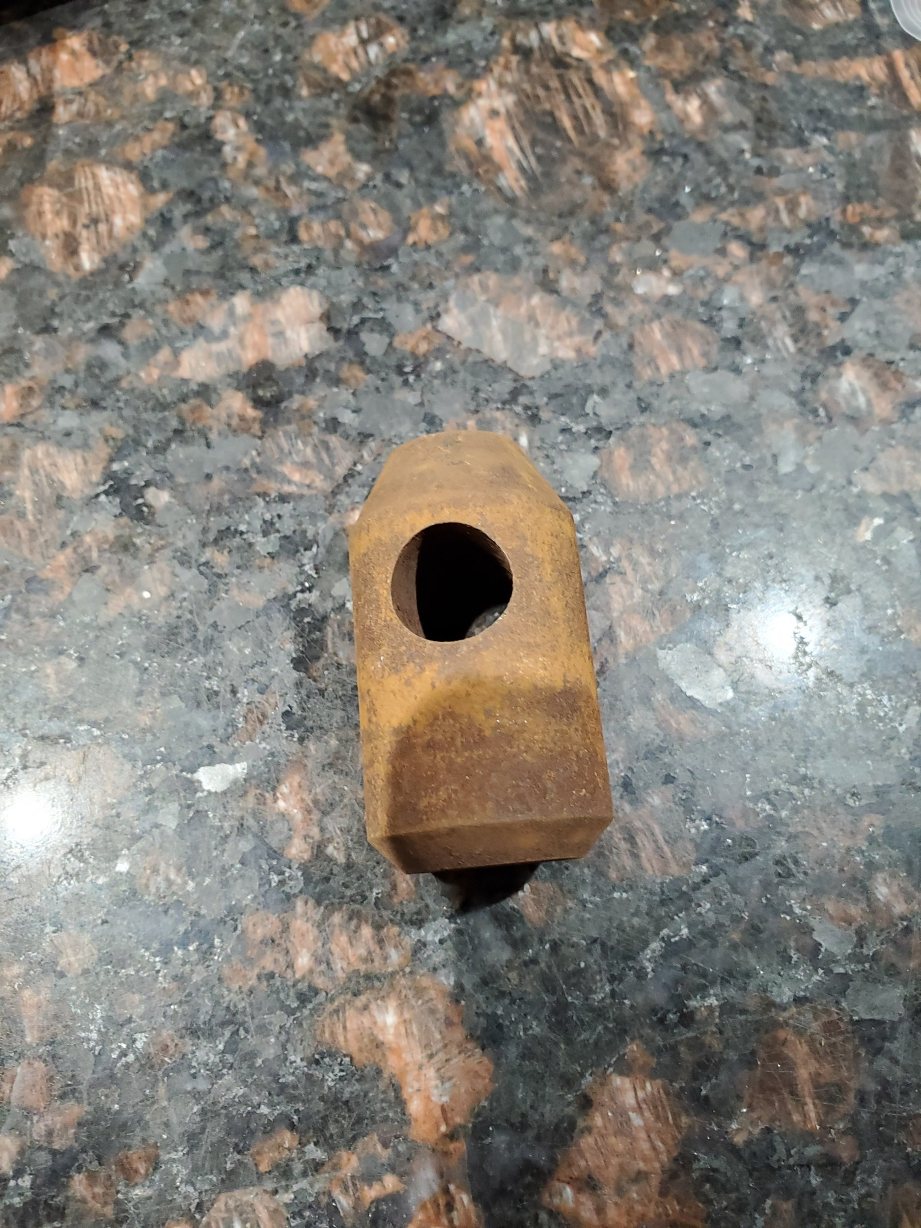

The "weld" end of the pin is beveled so you more weld inside the hole than on the flat surface and that means the weld penetrates about half the thickness of the plate.
The main thing is the weld is flush with the surface of the plate the pin is welded into. In order to grind the weld off you're going to make a sizable hole in the back side of the plate by grinding away a lot of the surrounding metal. This is something I'd rather not do.
I think by cutting out the center of the pin, drilling small holes as suggested, I can then break out the remaining edge pieces and then use a cylindrical grinding stone to clean out the hole until the new pin fits correctly.
I do appreciate all suggestions!
Here are the pictures again and one pointing to the bevel on the pin for welding.
