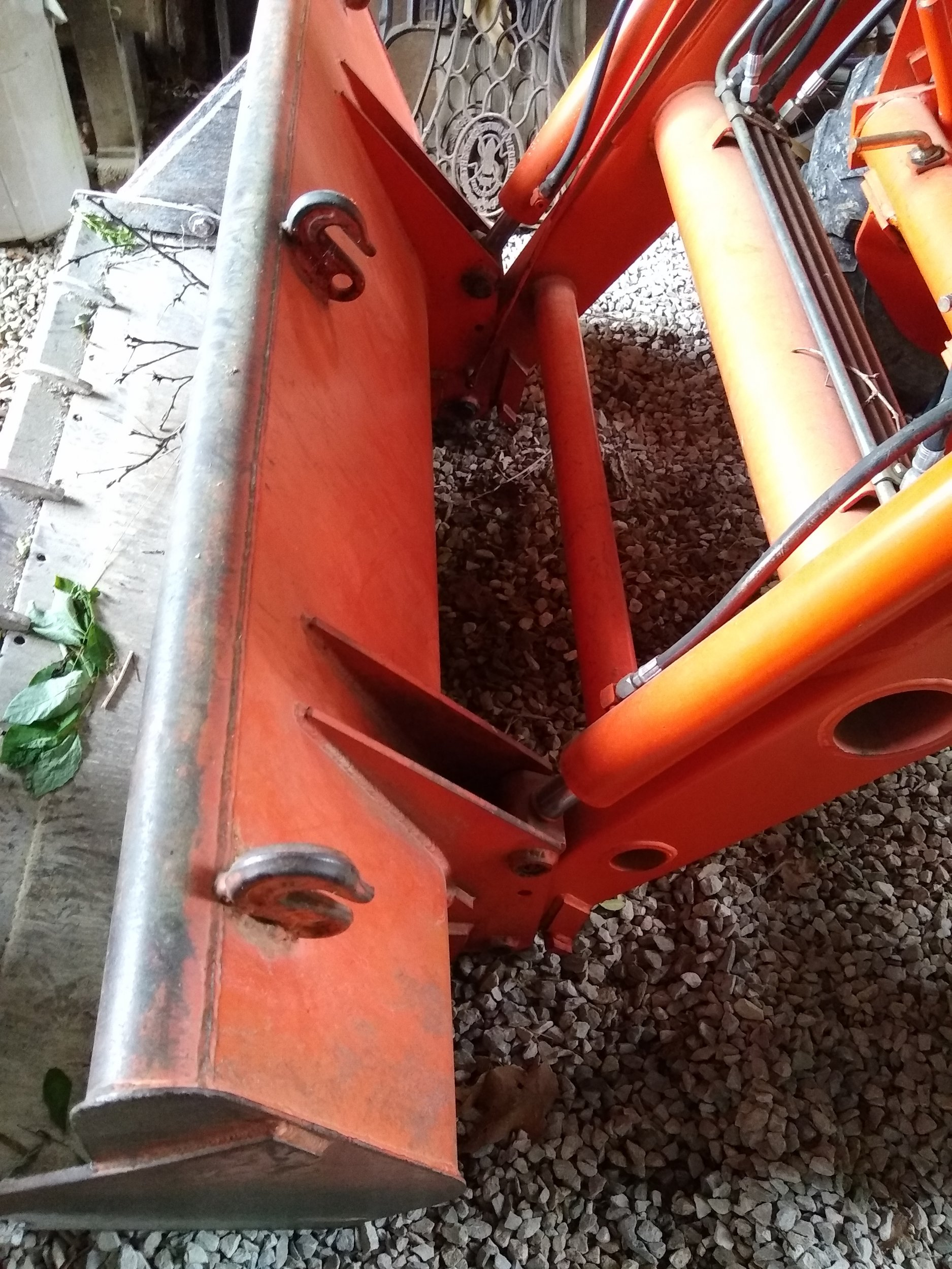

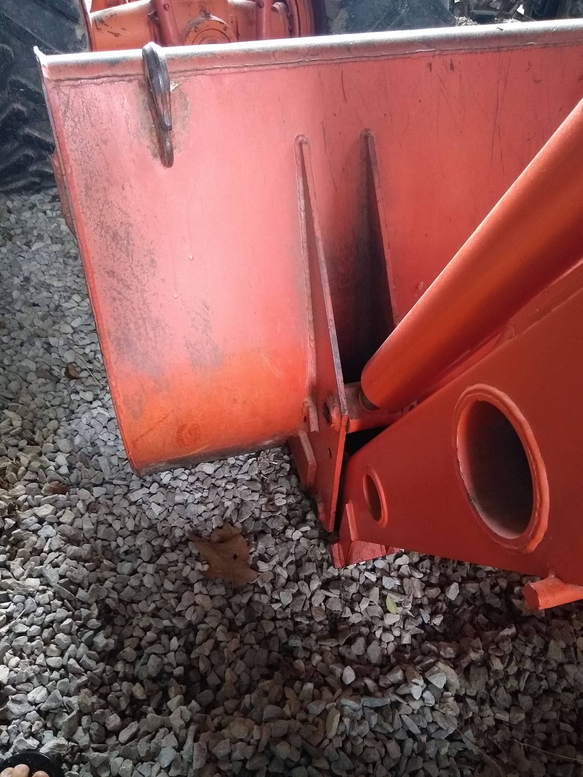

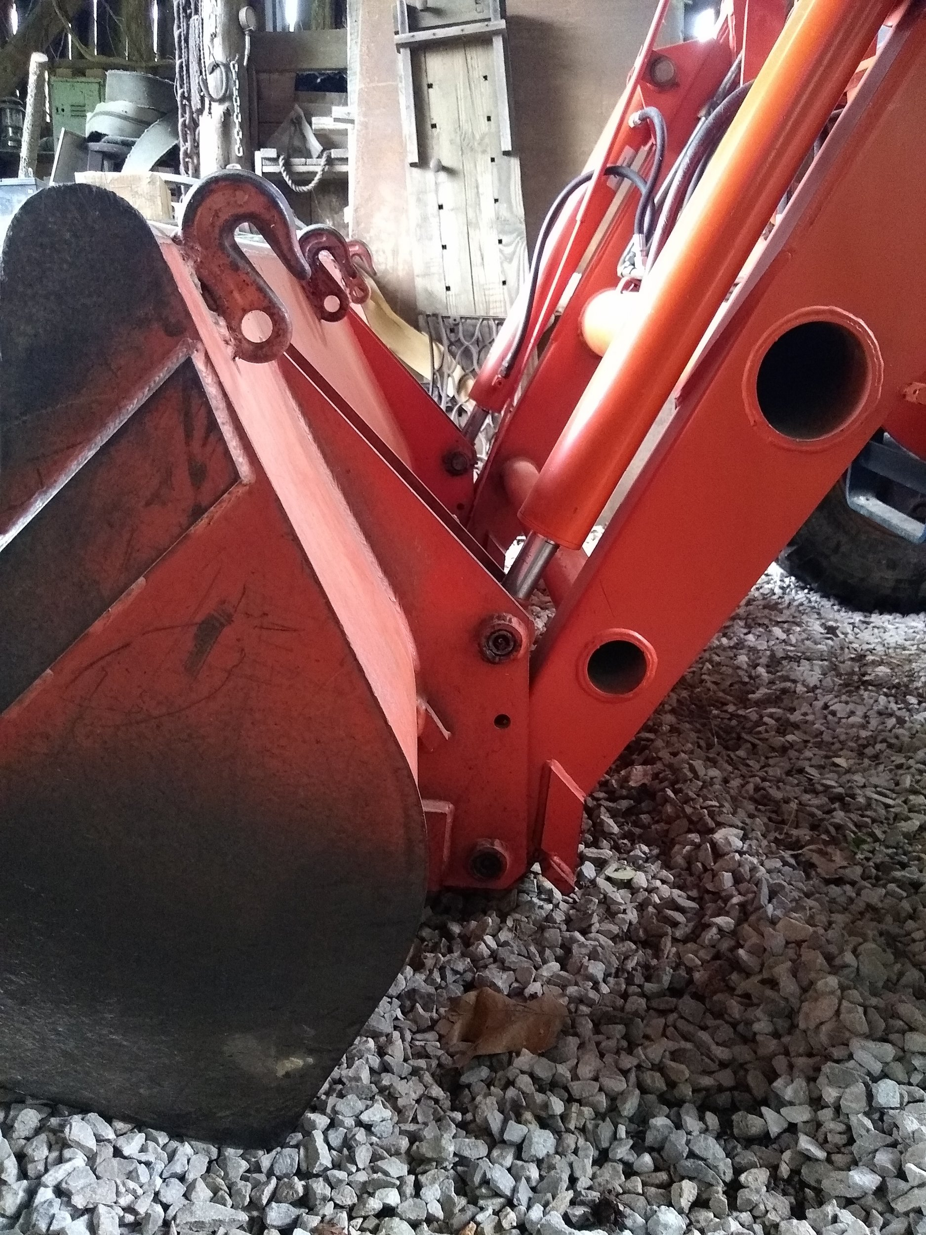

I got a really nice used L4850 with FEL last fall, and am totally loving this tractor! However, it has a pin-style loader bucket attachment, and I want to change this to a SSQA, so I can use my nice forks from my skid steer, as well as other attachments.
I have a friend who is a union pipe fitter that can weld like a champ, and he's offered to help me do this fab job. However, I want to make sure I install the latch boxes etc at the proper place, and make sure they are heavy duty enough to safely work, the loader is rated at over 1 ton.
Can I just use the $100 latch boxes from eBay for this? I can't find any load limits on the product descriptions. Is there a superior product that I'm just not seeing? They all look pretty similar to me.
Also, since this is a round back bucket, I'm scratching my head trying to decide the best place to cut the brackets for welding on to the SSQA latch boxes. Any thoughts?
Attaching pictures, and TIA for any advice!

Before cutting anything, roll your bucket down to the level position (the cutting edge flat on the ground).
If you have a level indicating rod check it's position then measure how much your cylinders are extended.
Once you get all your pieces and get your tractor side together either using a kit to replace your pin on or building your own,
extend your bucket cylinder the same amount and mount your bucket mounting plate to the ssqa push the bucket up to the plate
and then build your spacers to fit. Also measure your lift arm cylinders at the same time and repeat those measurements when aligning your bucket.

Trying to run this thru my brain. I can't see any way to leave your existing bracketry on the back of your bucket. I guess anything is possible. I think the problem would be the SSQA plate will be too far rearward of your bucket. You would lose lift and curl ability.
The bucket part will be the easiest. I built one on an old Ford FEL bucket. Removed all brackets that were in my way to get the attachment plate as close to the backside of the bucket as possible.
The FEL part of the SSQA will be the most difficult to fabricate.

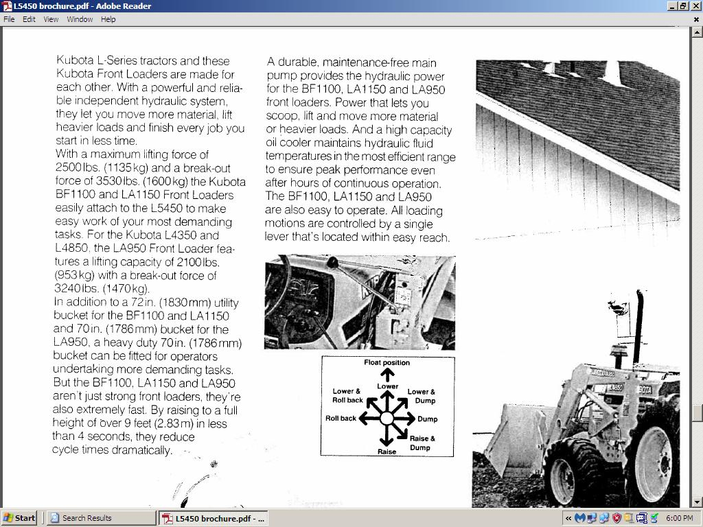

Here are brochure pages for the L4850 that state the load the LA950 loader is designed for - need similar SSQA rating.
My L5450 has the round-back bucket like yours. It looked like a QA setup would move things forward, reducing capacity - so I settled for forks that go in holders in the bucket.
