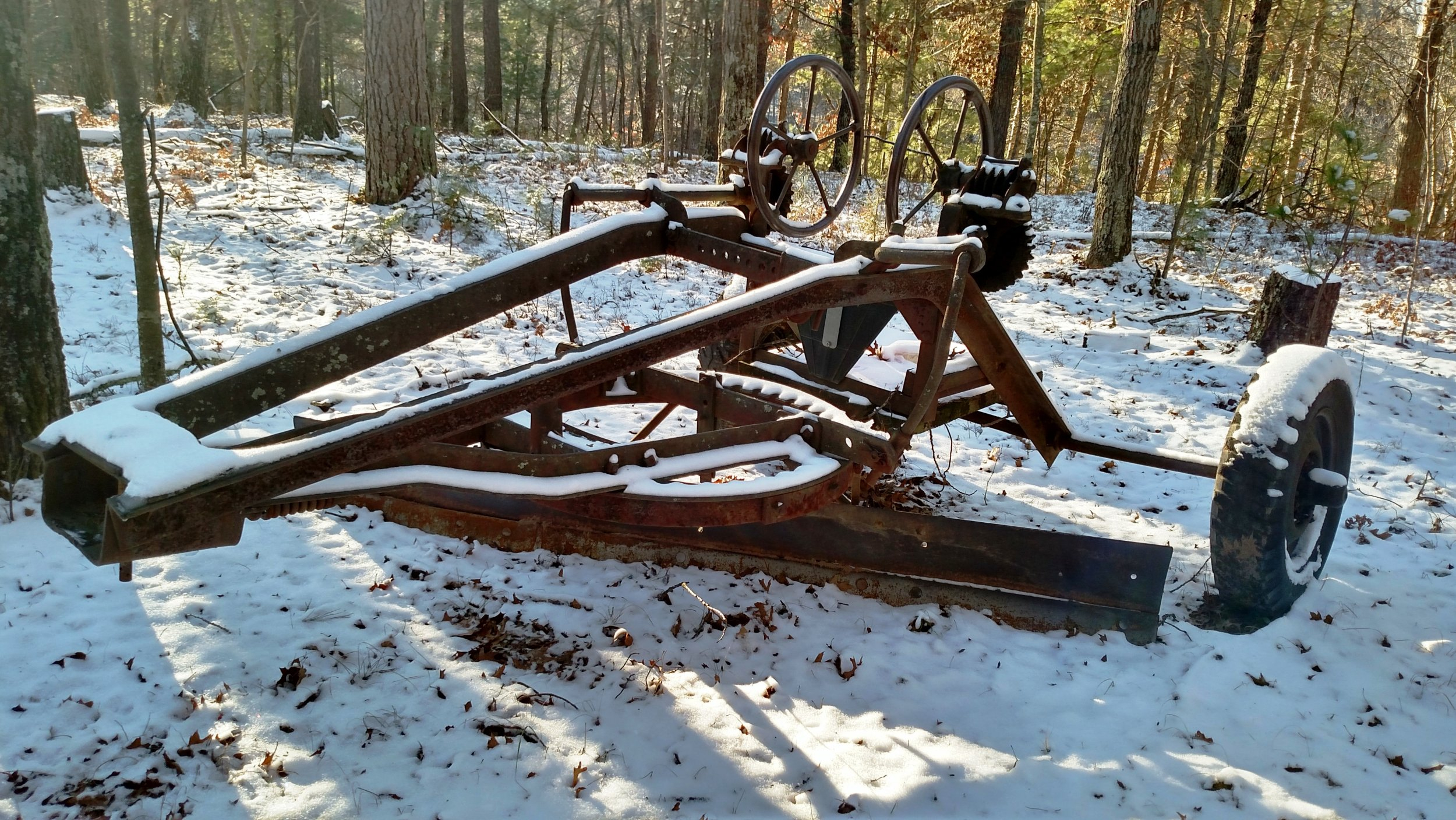

My favorite implement for smoothing or leveling ground is this old Pony Grader.
   / Advice on smoothing, leveling a field #46
Or a rear blade with guide wheels
