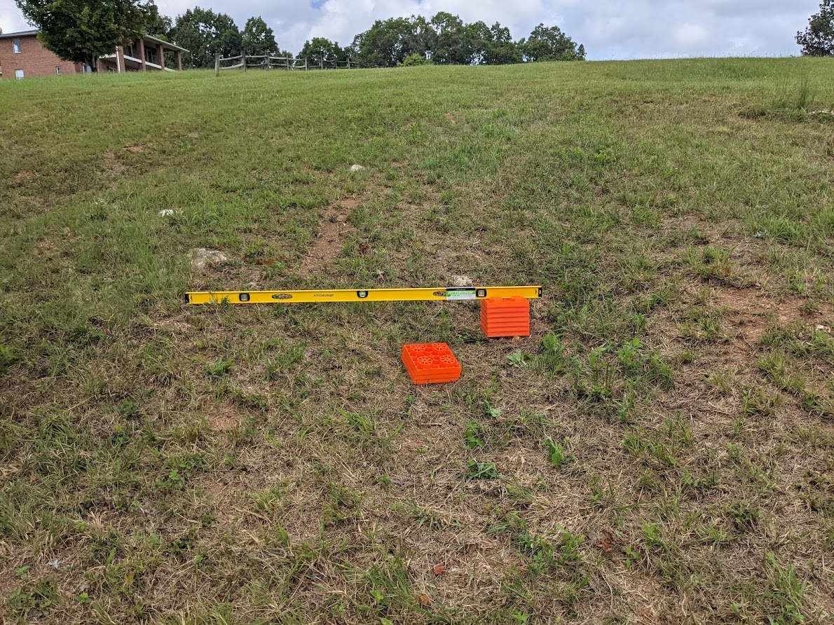

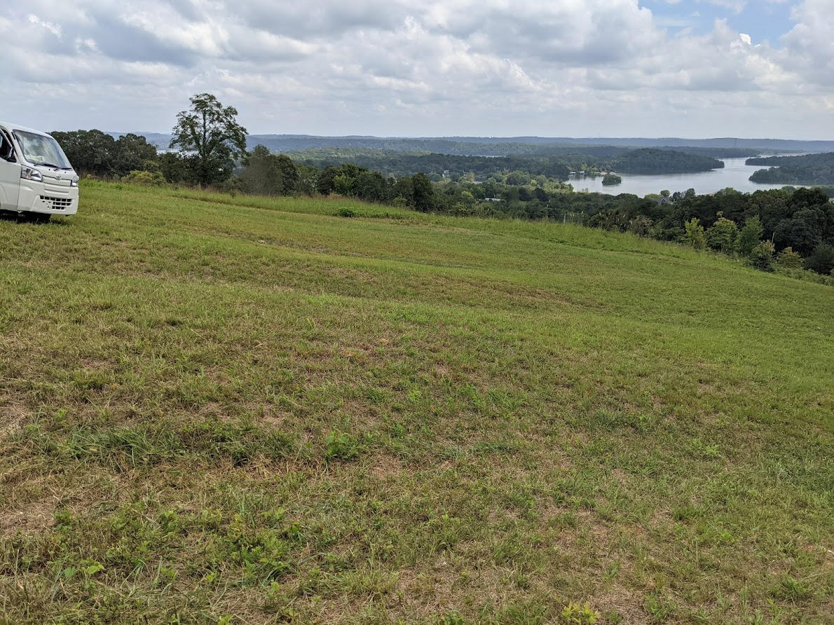

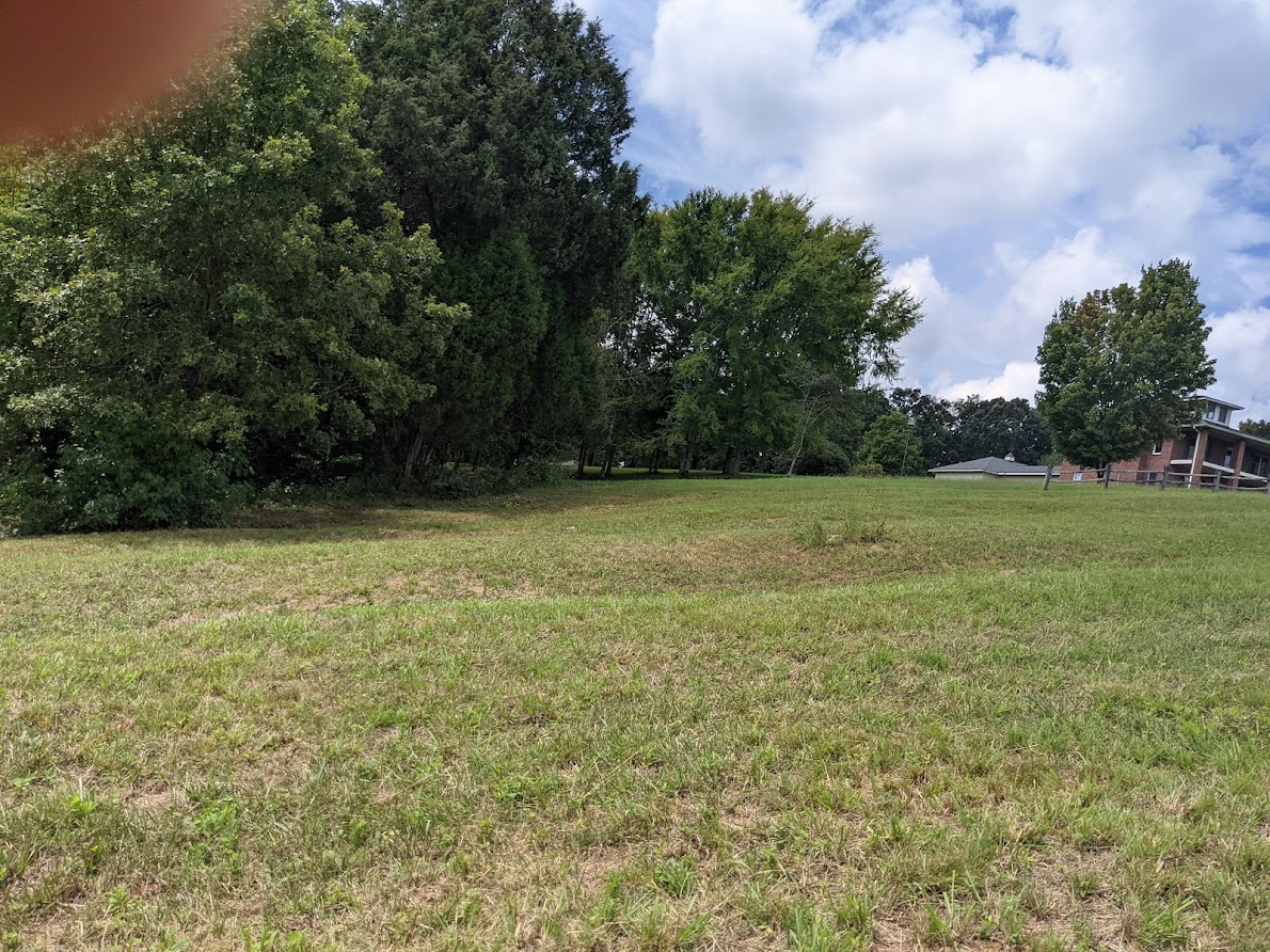

Ok I took some more pictures to try and convey what I am dealing with. I have a very large section of land that just undulates like a sine wave. I don't know if it's from erosion or some other means.
I used a level and some blocks to try and give an ideal on how deep these are. It's basically 8-10 inches to the bottom of the level in these pictures and it is not even at the top. Some are 30 yards long, some go on for much longer. And it is like this for a very large area.

Second set of pictures shows that it's not that bad. I would suggest a box blade. Use it to create more gentile slopes going into your depressions and to fill the little rivlets.
The picture with your white van. Sure hope you don't want to fill those undulations. The ones with yellow level - box blade will smooth that all out.
Hey - you moved out into the country. Did you expect to create a pool table out of your land.

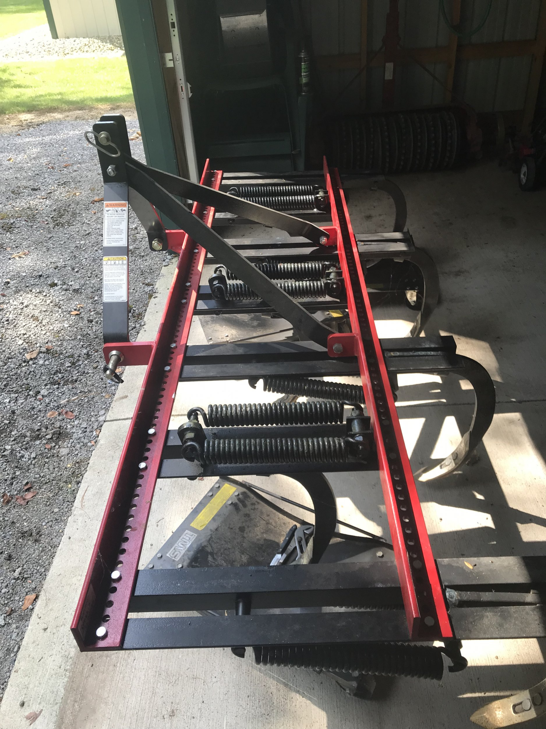

3 point rotiller would smooth that out or this option followed up with disk.

Yep those are the ones I am talking about. I don't expect billiard table smooth, just want to be able to mow it easier. Otherwise it will gwt neglected and look like junk.
I do appreciate all the suggestions. I have a lot to think about including if I want to hire that pro.
I like the look of the power rake. Costly but looks like it can handle it. Really pondering this.
