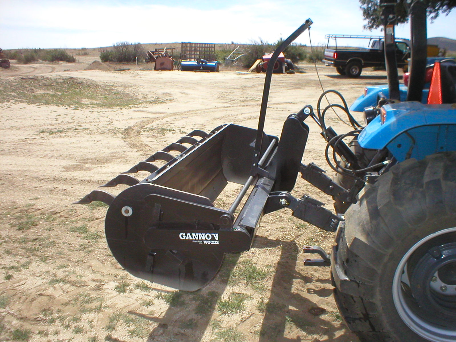

With everything that you have mentioned, these are the items or equivalent items that I would be looking at. Personally have by the way.
General road maintenance, a land plane grading scraper (LPGS) really needs to be a 7-8 footer at a minimum of 1000lbs, so an industrial model, no hydraulics.
A 6'-7', 800-1000lb box blade at a minimum, different types available, Gannon is typically thought of to be the best, but there are others that are just as good. The same design is used on most of these types though.
A rear blade that weighs close to or above 100lb per foot width. For your tractor, an 8 footer would be about right.
To make the most of these implements, you will need to add rear remote hydraulics if you do not already have them. None of this is cheap, but unless you want to do this several times over (doesn't sound like you do) sort of what you should have IMO.

If you have drainage problems, then a good rear blade would be the place to start. Be sure to get the rear blade with skid shoes. They really do make using the implement easier. Here is a link to another rear blade unit that I like, not quite as heavy as I like, but close.
You can get lighter duty implements and still get stuff done, just not as easy or fast and you have to be careful of the implement.
Good luck. :thumbsup:
