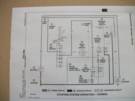

Over the years I have posted a few attachments I have included them should you want them.
Would be interested in knowing what you think of the backhoe.
