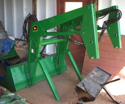

I included a link to JDparts, you can look up what parts are inside the cylinder. I would try and repair the cylinder myself. You might post a question to see, if anyone else has repaired the cylinder. I would think the hard part is getting it open. Also once you have loader off the tractor, it is easy to get the cylinder off the tractor and test your repair, before putting the loader back on the tractor. I attached a picture of mine off the tractor.

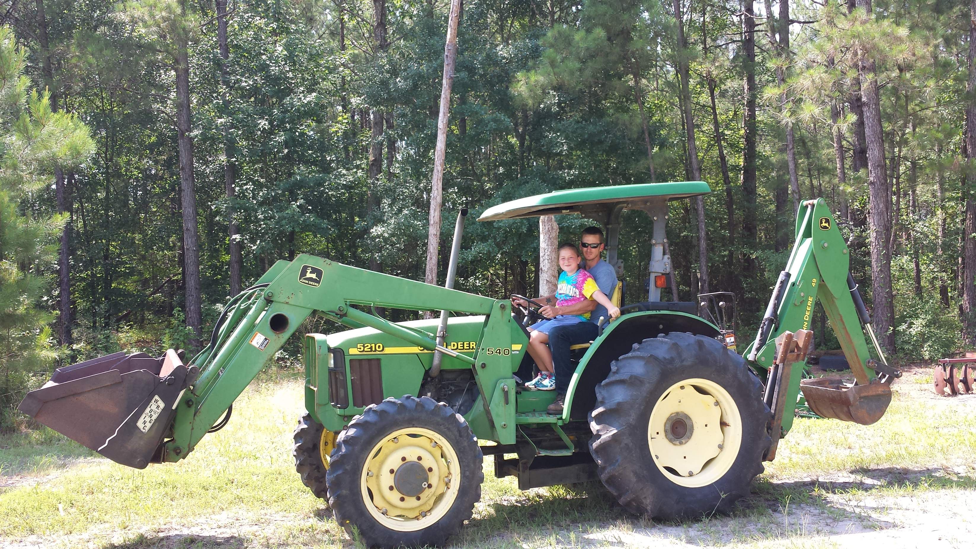

download_20150701_153526.jpg I do appreciate the advice. This is the only picture I have right now. I will post more of everything. For 18.5k I ended up with a leinbach 6ft disc harrow, the mx6 mower with extra new blades, a united 7 foot box blade, the 4in1 loader bucker, the jd loader bucket, a 2' backhoe bucket and a 3' backhoe bucket. He had all the manuals for the JD stuff which was awesome, a new 5 gal bucket of JD hydraulic fluid and a half full one, new airfilter, and lots of various extra pins and bolts, and 2 extra front tires. I feel like I am leaving something out. Oh, and he delivered everything to my property about 20 miles away from where he kept it.
I have to replace the joystick controller rebuild the 4 loader cylinders due to leakage, and at some point the 4 in one cylinders, and also replace 4 hoses. Going to do all the other maintenance require at 1200 hours and any other interval not included in the 1200 hour, since it has 1040 hours and I don't know what has or hasn't been done. There's a story behind that, I believe it was maintained and very well because of extra grease on fittings, the Super clean brand new smelling motor and hydraulic oil, and the general condition, but it hasn't been used more than 40 hours in the past few years, and jot at all for six months.
The seller was a super nice, honest and easy to deal with guy,
