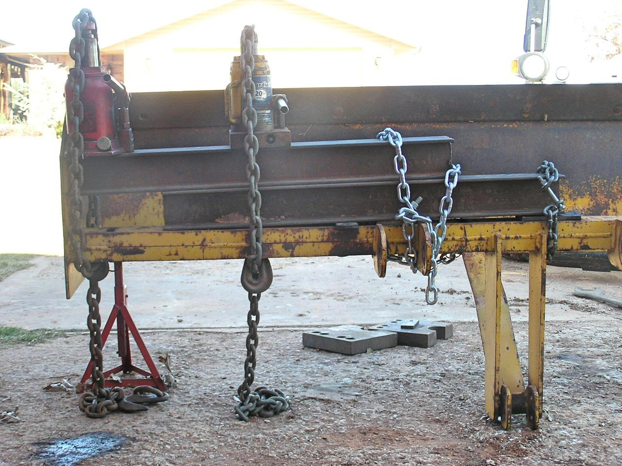

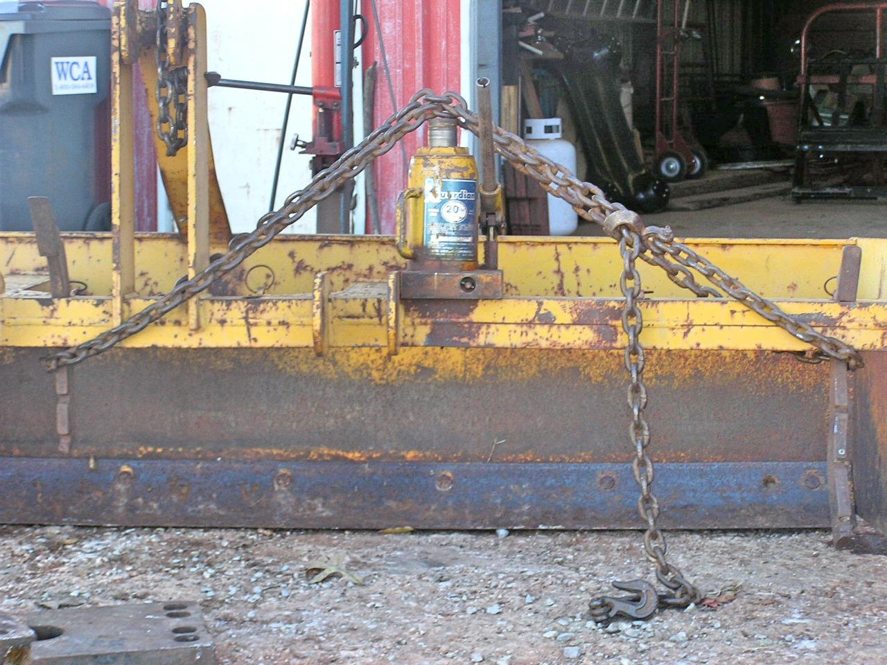

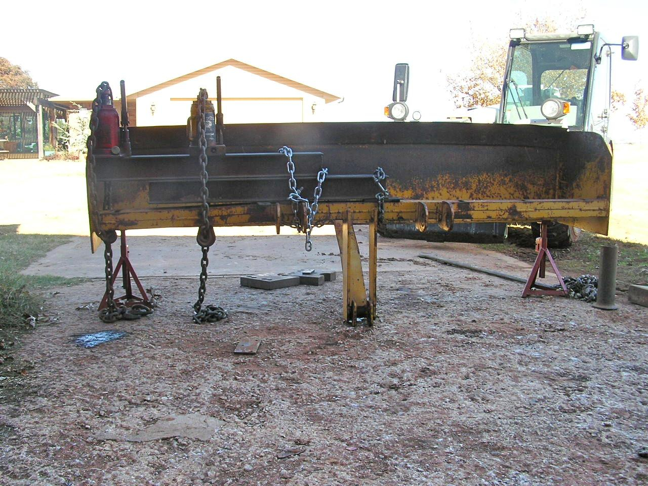

I nave used a chain and a jack to straighten many things. Put the jack on the high spot and push it down:
Or pull up where it is too low:

   / Advice On How To Straighten Gearbox. Deck Mounting Point Bent Slightly. #15
I'd weld a plate to the deck and reattach the gear box with longer bolts. All of my RC's had more than enough space to do it.
