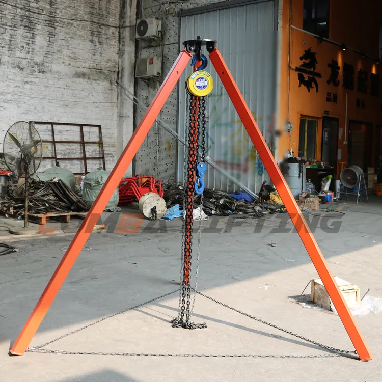

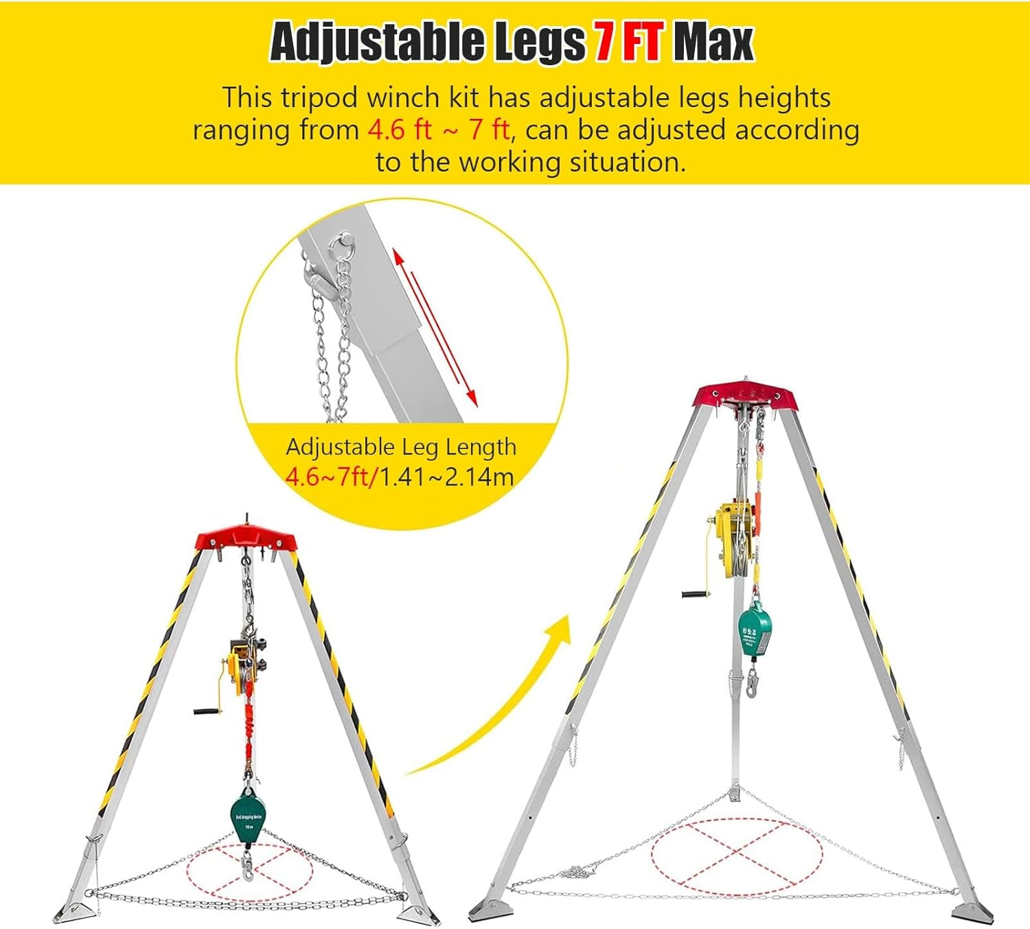

ciao ho bisogno di recuperare un oggetto pesante in campagna. ho pensato che siccome potrei usarlo in seguito per altri lavori, vorrei realizzare un paranco a treppiede che si possa smontare e rimontare. che materiali mi consigliate di usare? devo portarlo in loco con un mezzo montarlo sollevare il carico sul retro di un furgone smontare la struttura e portarla via con il carico grazie. carico massimo 500 kg non di più. che materiali uso per la piramide. staffe o piastre per il montaggio?

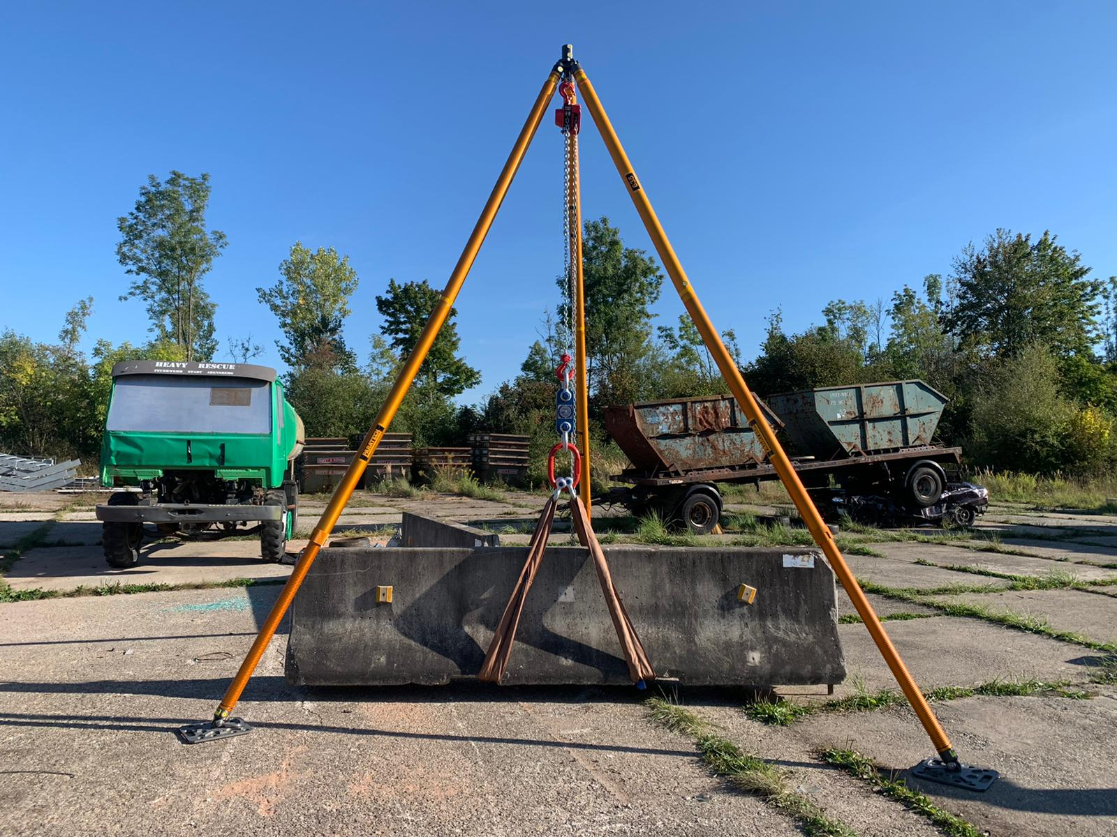

cosa mi consigli come configurare questo strumento mi consigli soluzioni alternative? come sollevatori a trazione e rampe di carico come gin pole hoyst scissor tow truck? grazie attendo consigli e suggerimenti adeguati grazie

I don't speak Italian, so not 100% sure what the goal is here, but I'll give it a shot. If I was going to build a tripod similar to the ones pictured above that was capable of supporting 500 Kg. (roughly 1100 lbs., for us American savages still using the Imperial system), I would use 2" x 3" x 3/16 (50 mm x 75 mm x 4.5-5 mm) tube for the legs. The problem is going to be that it's going to have to be really tall to allow the truck to back underneath it. Seems like there may be better options. Something like this, perhaps. Vestil Truck Mounted Davit Crane
I built one similar to this using an old hub from a Dana 80 axle as the pivot. It will lift at least 1500 lbs.

Can't post photos at this time unfortunately, as the crane is buried under several feet of snow at the moment. It's essentially the same thing as the truck mounted crane in the link that I posted. The tripod that you're talking about could easily be made to lift the weight. The problem would be getting the truck underneath. The legs have to be far enough apart to allow the truck bed to fit between them.
