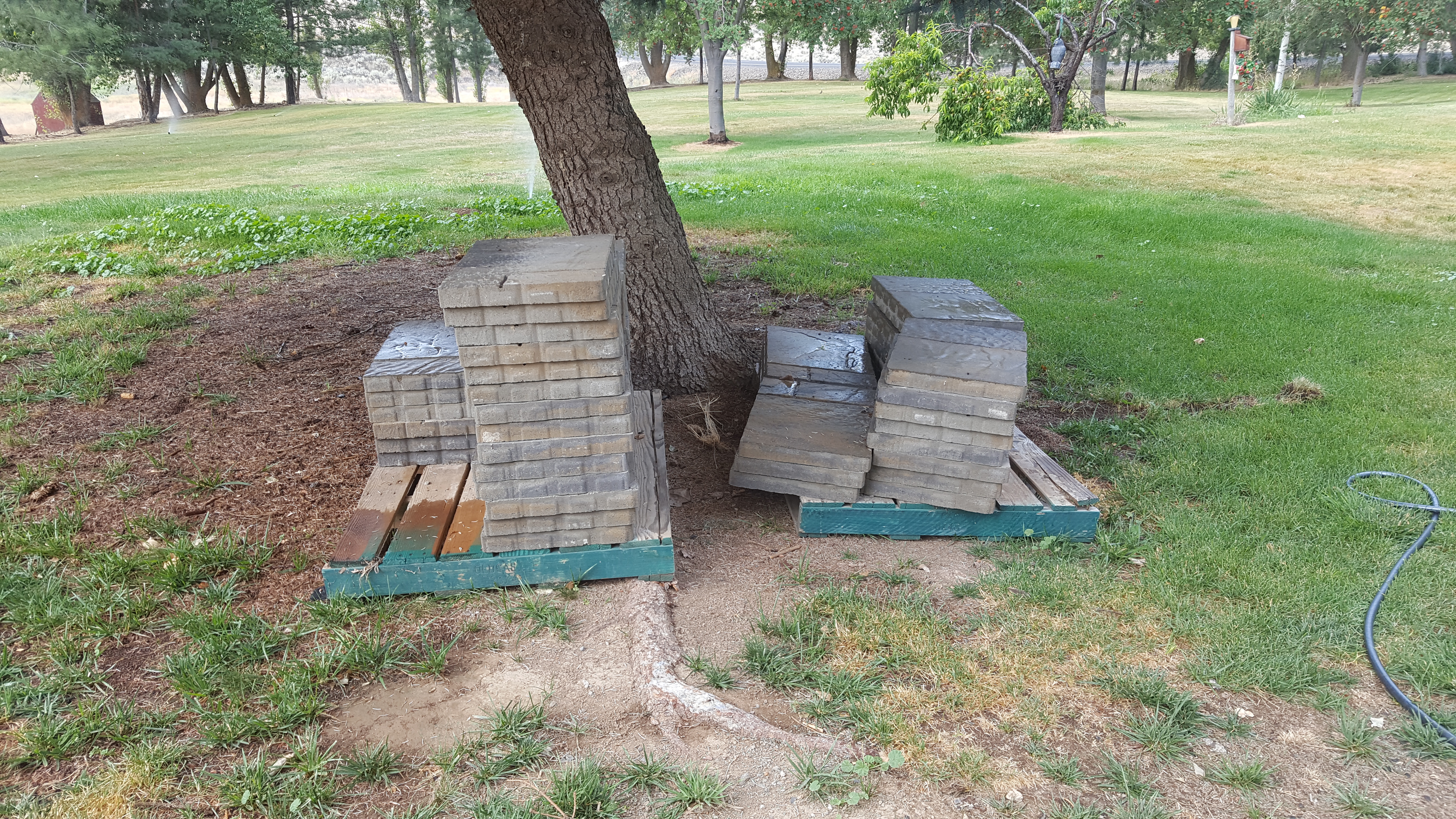

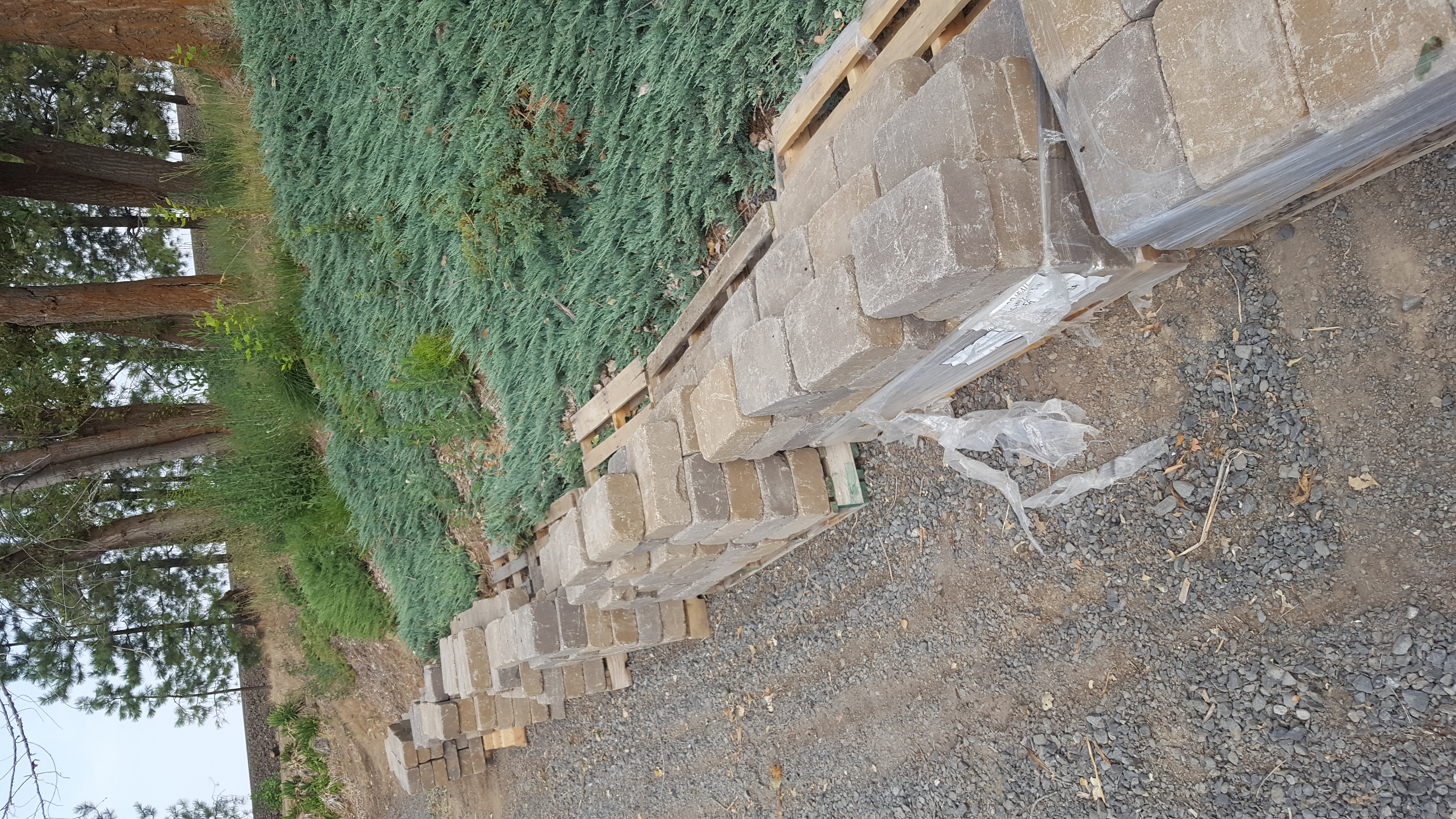

I have a 4720 and with quick attach pallet forks we have to break up pallets of pavers/bricks in half and stack them close to the cage/tractor. Not sure what the weight is on these? maybe 1500#?. Maybe a three point forks have more lifting capacity. 20180728_094558.jpg20180728_095314.jpg
