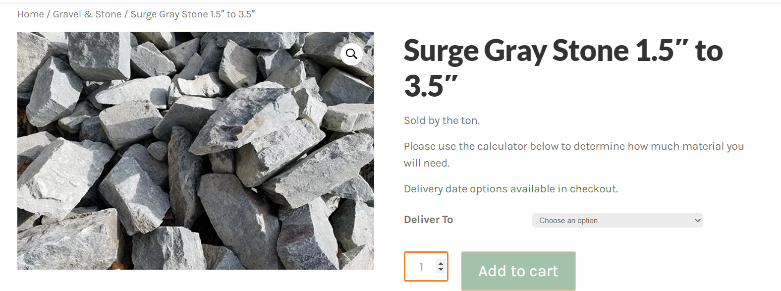

I have a road (about 275 yards) through the woods linking two sets of pasture. The road is down a steep incline that winds through the woods. I have been able to keep the water from the pasture draining into the side ditch but the road itself collects enough water to wash. Years ago I had a shale/clay mix (some call it dirt rock around here) placed on the road. The shale made a good base but overtime it broke down and washed. It broke down under the weight of equipment and the weather. I planned on topping the road with crusher run but the material hauler suggested I use surge gravel. I have a few questions: 1. How easy or hard is it to scrape surge compared to crusher run? I have a 50hp tractor so I am not concerned with the ability of the tractor, I am concerned that every time I scrape the road it will be rough. 2. Crusher run will pack relatively quickly; I assume surge will not pack solid as quickly. Will the cows be reluctant to walk across the surge gravel?

I know different areas have different names for gravel but what is "surge gravel".
/ Advice on a farm road #3
What you call surge will definitely sit in really well. It will be rougher than crush run but in my opinion will last a heck of a lot longer. We have a few dirt roads here that I work that are steep and winding and as soon as I finish grading it and putting a decent crown, I add number 4 crushed limestone. It packs fairly quickly on a fresh graded road. I have tried crush run but the rain just washes fingers in it because it’s so fine. Btw, small cars travel those roads I add number 4 to and cows will walk on it. A guy that lives on one of them crosses his cows a couple times a week.
/ Advice on a farm road #4
Agree with the hauler - put down surge base 4-6" deep and crusher run on top. In the NE we call this 2" or 3" minus which is a mix of stone 3/4" to 3" and you can move and level this out with a normal loader bucket.
Then top this with either 3/4 stone or your crusher run you scraped off first.

what do you drive on it, car, quad, tractor? I don't think I have ever had trouble with cows not walking on 2" rock, but, if I was driving a car down it, I would use something else. This is normally used for base, with a layer of 3/4 inch on top and then crusher run on top of that. I don't like working with gravel of different size because it grades weird.

The first thing that you need to do before topping with any kind of gravel is to shape the road and put drainage into the road. Google “rolling dips.” By building these into the road, it will drain and you won’t have washing. Then you can top it with gravel. Usually a small dozer is used to cut rolling dips into the road, but a good heavy blade on a utility tractor might also work.

Yea sure, and the poster above was correct, get the water off, water bars can help, always hard to say without looking at it. Even pictures I have trouble telling grade.
But to your question, if only truck and cattle, I would give it a go, it will certainly out last crusher run, and dry quicker. Run a two foot path down the middle of crusher run if the cows complain:)

I say surge stone will be easier to grade then crusher run since it has less fine to compact ... with that being said I think surge stone will always be rough, it wont compact you need fine to achieve compaction and be hell for the cow to walk on... I understand its best for erosion control but it is use for as a base.
I personally love Granular type 2 (0.1 to 4'') it compact like cement and is very hard to wash away ...
I'd say to follow you initial instinct the crusher run will give you better compaction and still give you the erosion control you are looking for or go with a mix like many brought up a base of surge stone with and cover up with a smaller diameter material.
