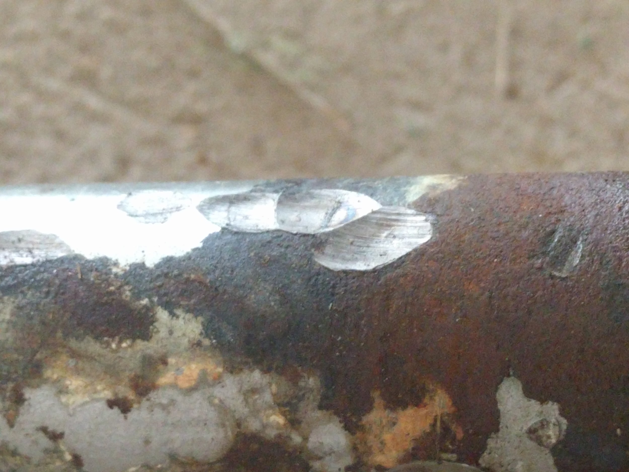

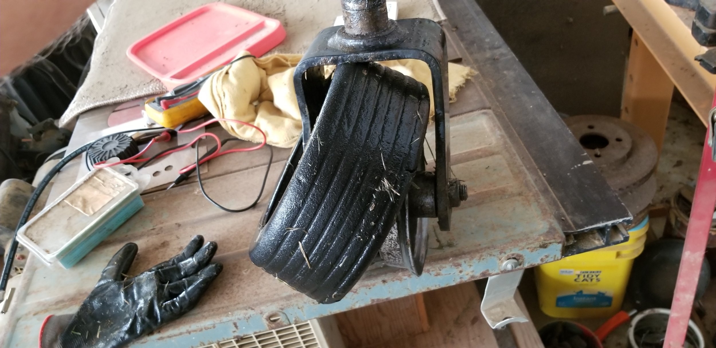

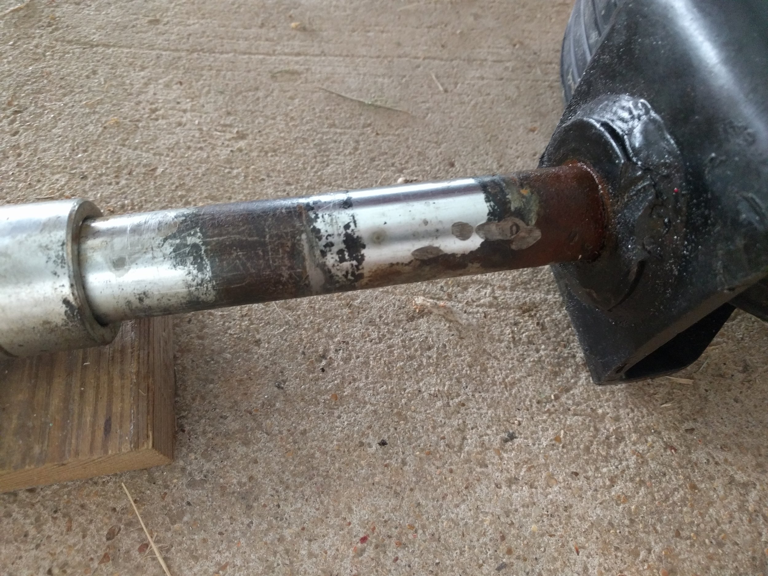

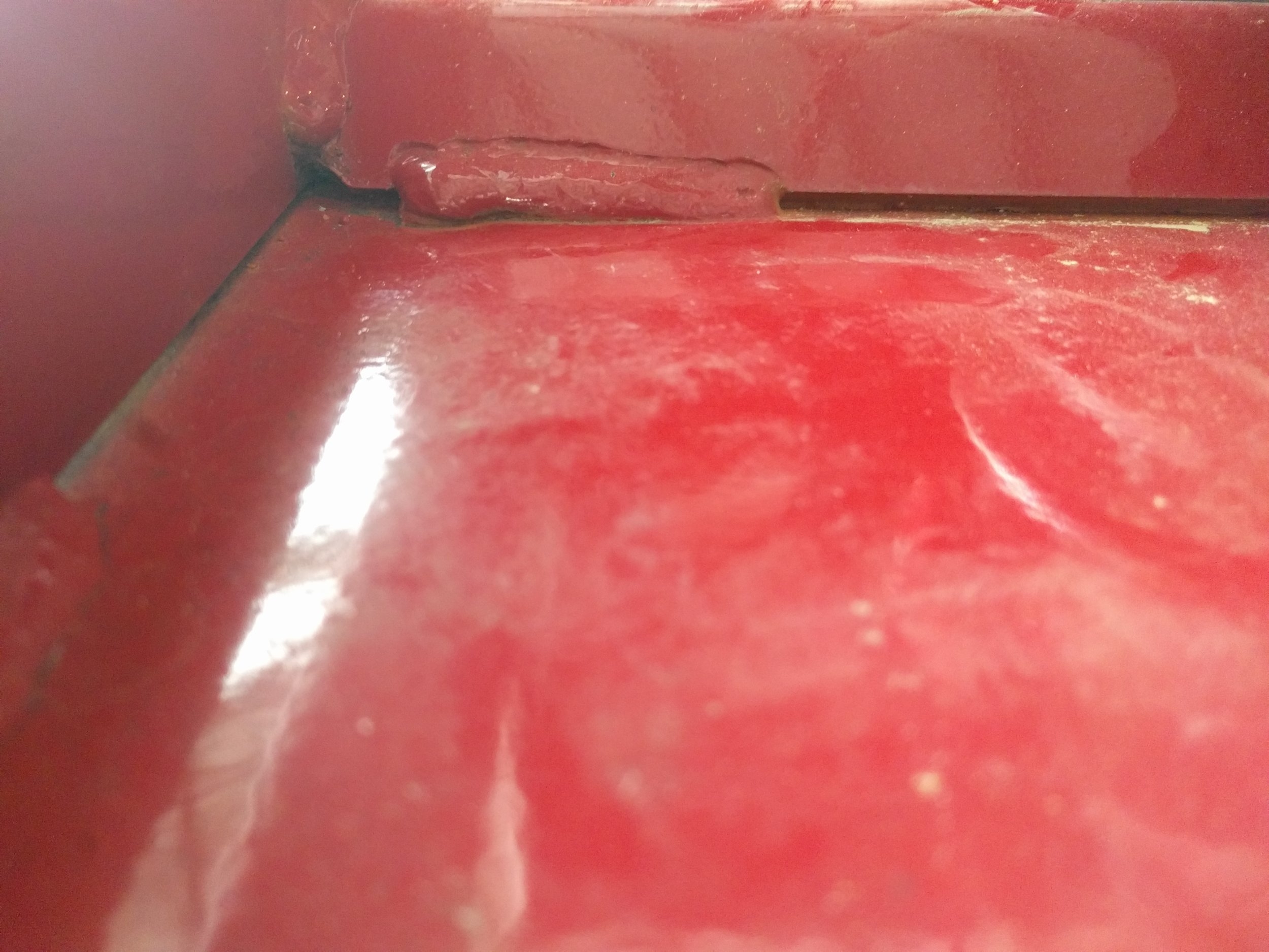

I'm glad for you guys with 6' versions of the BH, but the 7' is a screaming disaster. 1st copy 'ready to cut' had only water in the gearbox, and a couple of the vertical shafts for the wheel assys about 4 degrees out of vertical, and at least half the MIG welds on the frame were just 'calked' onto the surface. There was more that I don't remember at the moment. 2nd had the weld issues, vertical shafts for the wheels binding so bad in their bushings that the shafts got scratched up removing them, ends of the shafts had been worked over with a hammer (literally), really bad rust on multiple shafts and grinder gouges on one shaft, etc etc. The 3rd copy had various issues as well; fortunately for me the delivery guy let me pull a few good items off copy 2 to replace defective ones on copy 3. One of the wheels had a sheared-off grease fitting which I didn't discover until after the delivery guy left; the dealer (remote from me) refused any assistance; told me to take it to a dealer. In less than 2 seasons of mowing, the solid tires started coming off the wheels (fortunately, someone here gave me a source for quality aftermarket wheels). I've been through 3 or 4 belts in 3 seasons of rather light use.

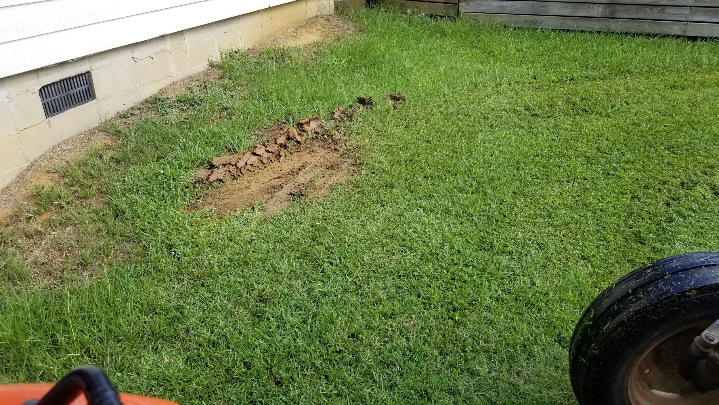

I wonder if the 6' & 7' mowers use the same frame & wheel spacing. The 7', with more overhang outside the wheels, will dig the outer edge of the frame into the dirt with very little unevenness of the ground you're mowing on. Many places where I had no issues with my old 7' mower get big gashes from the BH frame.

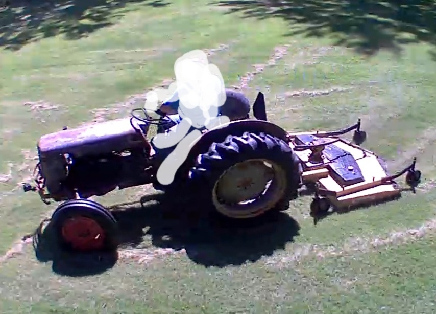

My 6' KK is 2004 and still going strong, but we only mow four acres. If your deck is fine, you'd be better off buying new blades, belt, and solid wheels and...., gearbox if you need one. No problems with mine. Original tires, rotated axles, 3rd belt, 2nd blades, 2 idler pulleys, and 3rd retention spring pulled by 1950 Ferguson.
Wow, you hired Bibendum to do your mowing!
Thanks for making me look that up. Never knew he had a name...
