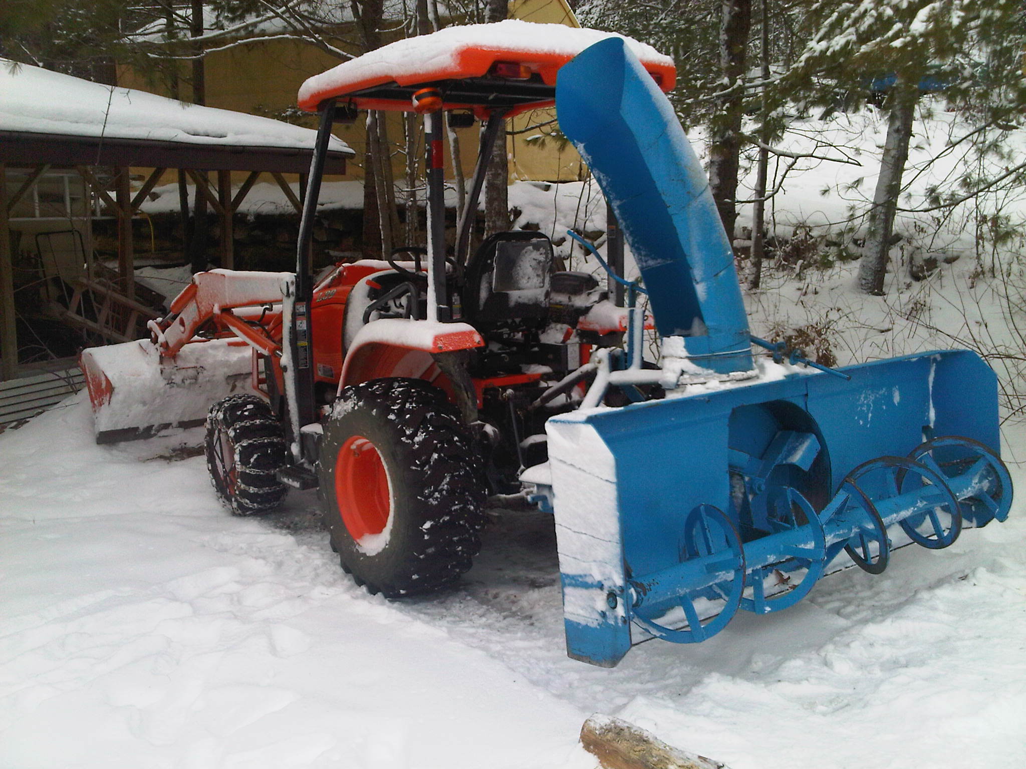

/ Advice Needed #12
Might I suggest a L39 or L45 with 4 chains and loaded tires and a 72" pto snowblower. It works for me in the muskoka's which might be the same place your cottage is....I have a steep hill out my driveway also and have no problems with it just with front chains.
Mike

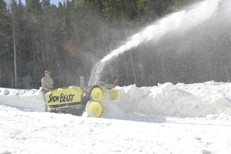

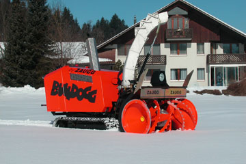

/ Advice Needed #15
Hello Zeq,
Either the Zaugg snow beast and snow bear might be a better option.
I have attached a picture of the snow bear and snow beast and you can see videos of them both at www.zauggusa.com
