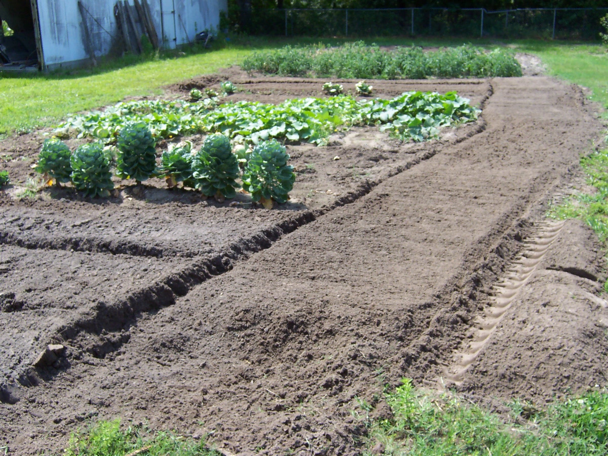

/ Advice for tiller for small tractor #5
There are a few variables with tractors and tillers.
Size and hp are not the only factors.
If you get a forward turning tiller it is much easier for tractor to use.
Also mine has skids that are adjustable for depth and less depth means less power needed.
Once an area is tilled it will take less to till it on a regular basis and the more you till the better the soil gets.
You can go slow and shallow at first then increase as you work it.
I bought a 4' tiller and it is day and night difference from walk behind. It grinds the soil up including the lumps.
