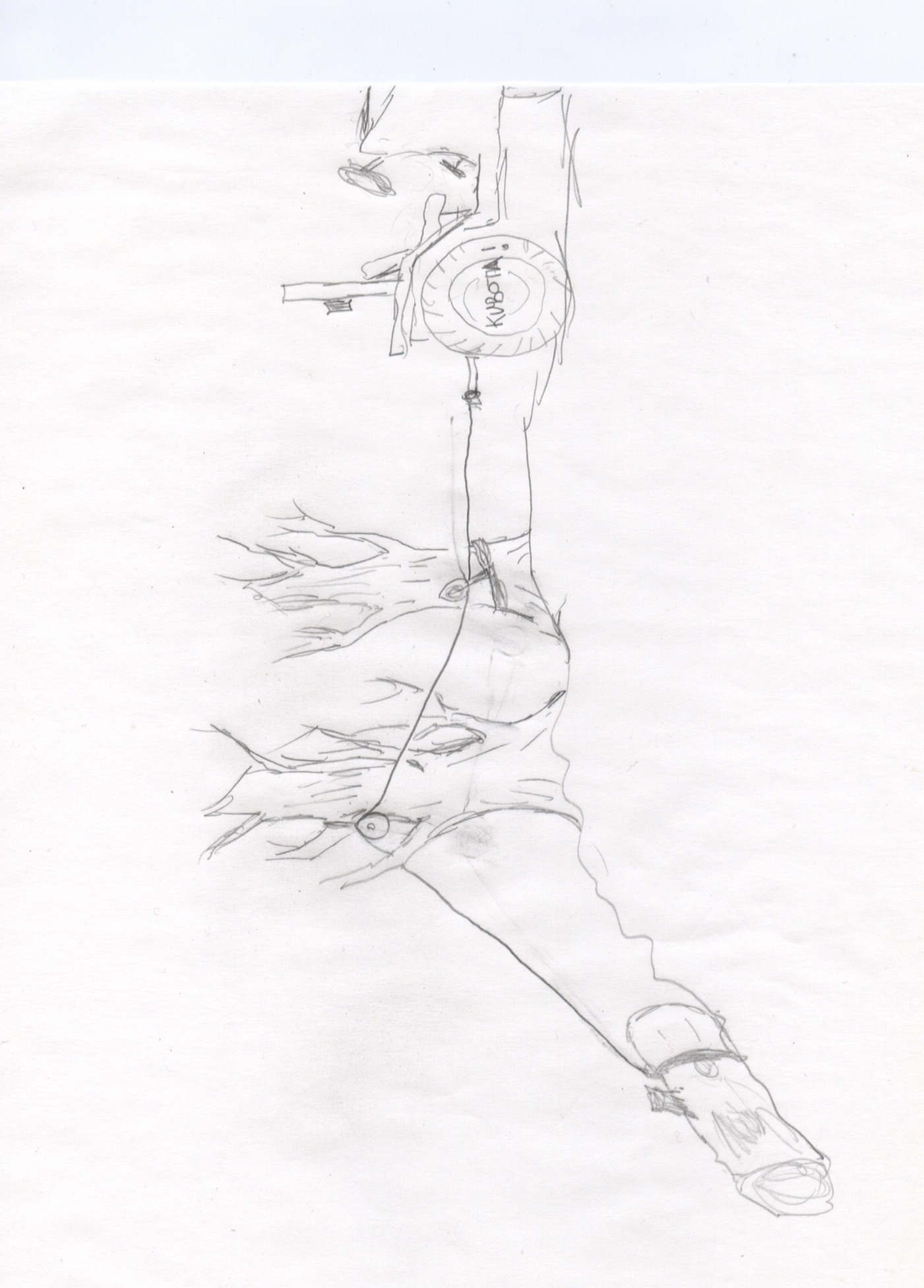

Having plenty of cable and chains could help. If you have any standing tree's that you can run a snatch block pulley as high as possible. Strong climbers rope could work if you don't stress it too much. Then come back down to another ground level anchored snatch block. Then off to your tractor or vehicle. Always always be careful of breaking ropes, chains or cables. I wouldn't try dragging uphill too large of pieces. If you can get an observer to guide and watch from a safe distance as you are pulling incase the log or rounds get hung up. I tried to use Word to draw up a really really basic outline. So don't laugh too much. Ok well after doing a hand drawing and then putting it on my scanner the picture keeps showing up as the tractor going straight up. For some reason it won't rotate to horizontal. Let's pretend the tractor is on flat ground

No need to laugh. It was a good drawing.

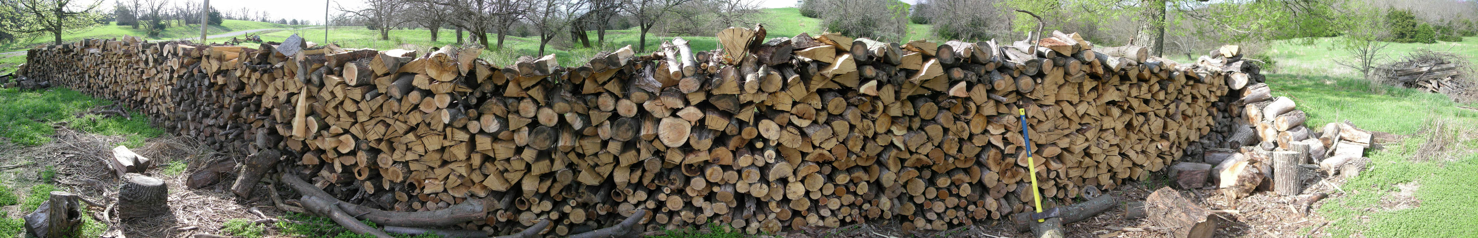

Below is a picture of last years wood pile all split with the maul leaning against the stack.

Dangerdoc,
Although impressive, your panoramic picture of last year's woodpile in post #13 seems to show some signs of digital enhancement--at least two of the stitched pictures appear to be duplicates.
Is this one of those "man things" :D ?
- LogChain
/ Advice for skidding logs. #20
LogChain
About 2' of the pile is all that I see duped. Still a respectable pile of wood. Guess there is only one house in the background. :)
