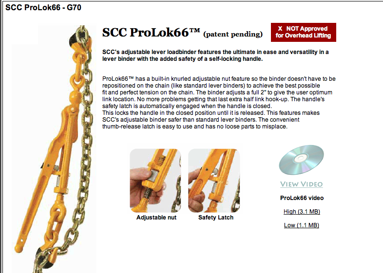

Adjustable lever binder
/ Adjustable lever binder #1
Tompet
Platinum Member
Oct 6, 2004
767
Ohio
Ferguson TO 20, Kubota B3300, BH77, Massey Ferguson 1540
/ Adjustable lever binder #2
Looks like something else to go wrong to me. Rust may also be a issue for some. I store my stuff indoors. I like just the good old tried and true lever binder with a cheater pipe to synch it down good.
Others like the ratchet binders. I think they would be a better option than these.

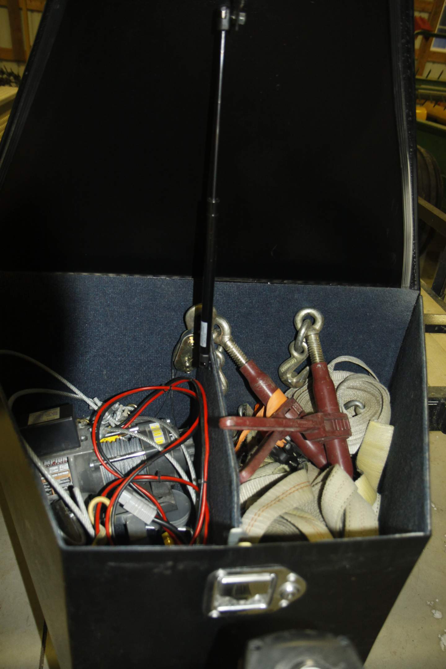

ya, mine are stored in trailer box when not being used. They like to stay snug and warm.
