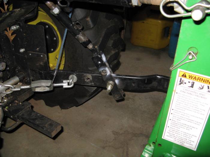

The picture in your manual is identical to my 2320. Looks like they changed the new tractors and used the old photo.

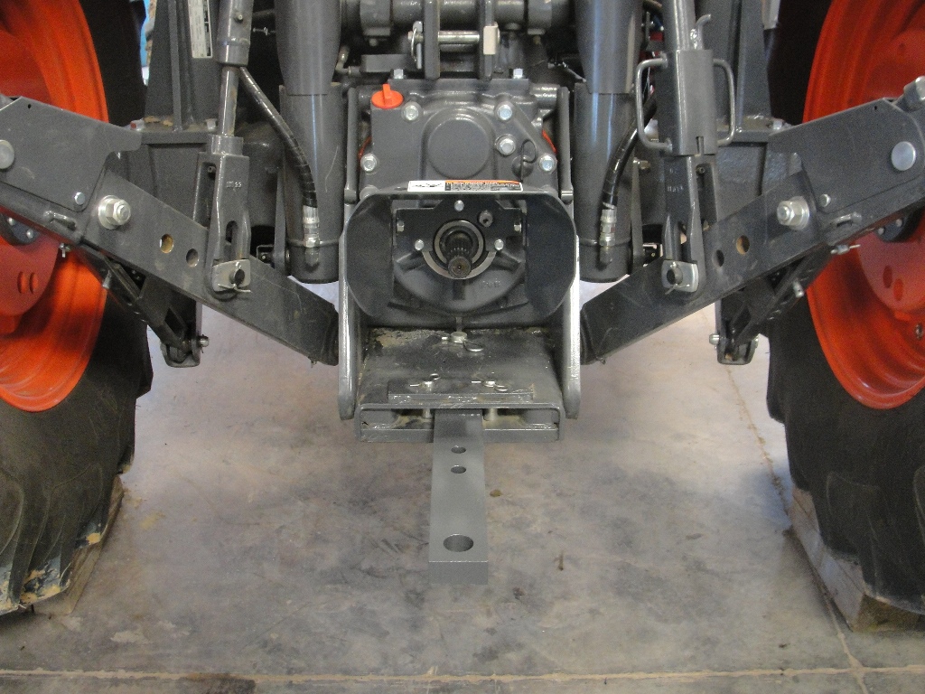

Do you know the reason why some tractors have adjustment holes on the draft links Some don't.
I'm not sure. Seems to be more common in larger CUTs, Utility and small AG tractors.
I'm a maximum height guy so mine are normally pinned closest to the tractor end of the lower arm.

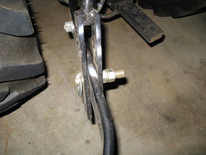

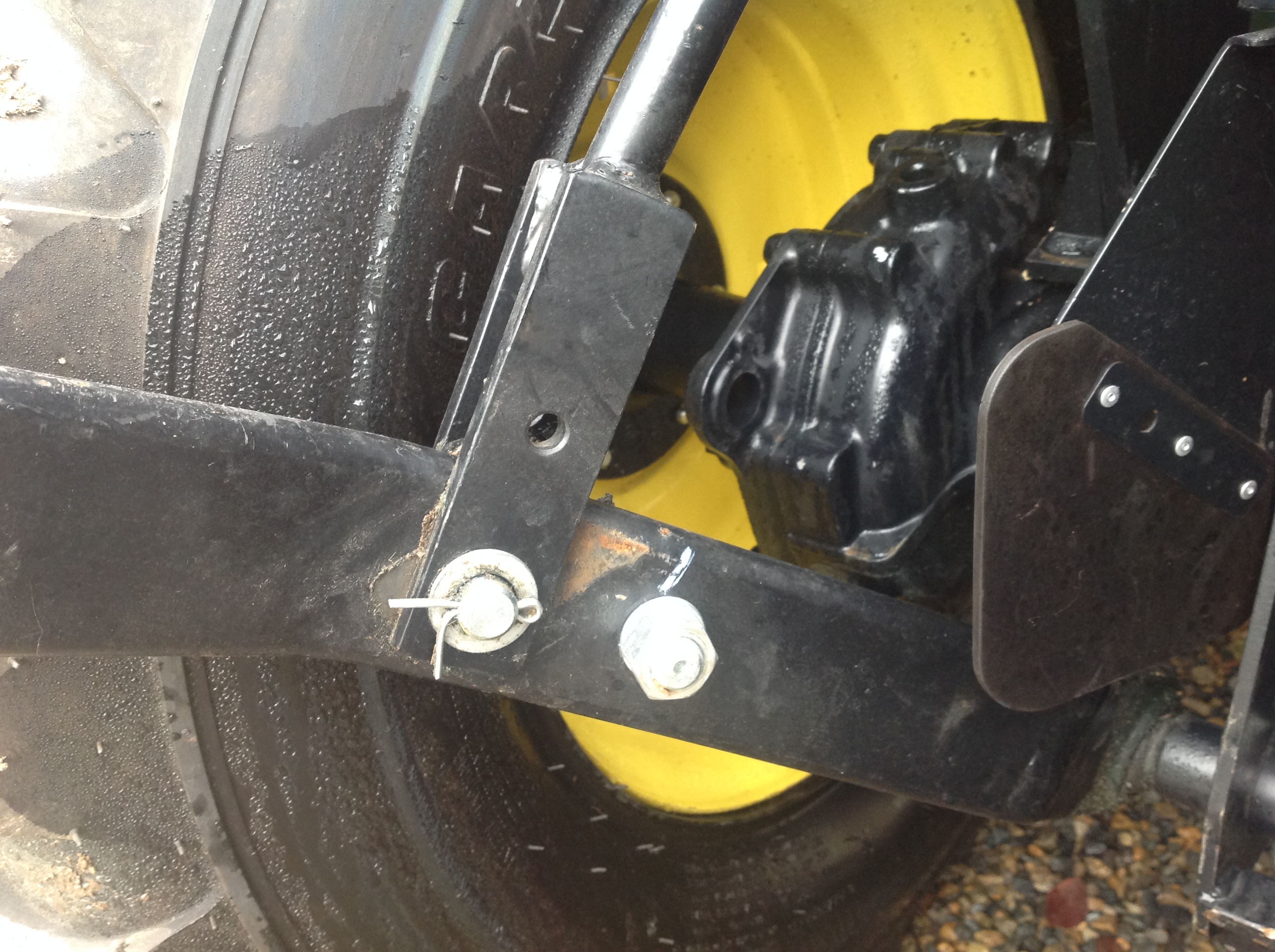

My service manual says 2025R & 2032R, does anyone know why I don't have as many adjusting holes as the manual says?
View attachment 494337 end quote
The hole seen in your pic of the lifting rod sturip isn't for adjustment, it is to small for the pin to fit in. I suspect it is a location hole for a welding fixture so the part could be welded in the proper orientation.
Good catch!!!!! You are exactly right!!!!! I've saw pics of those before and never caught that!!!! Thanks for the clarity!!!! :)

Here's a pic of my Kubota set for maximum lift height for reference.
Ding, Ding, Ding, give that man a prize, right you are sir that hole is to small for a pin and that's why the manual does not mention lift or capacity adjustment for the 2032R.

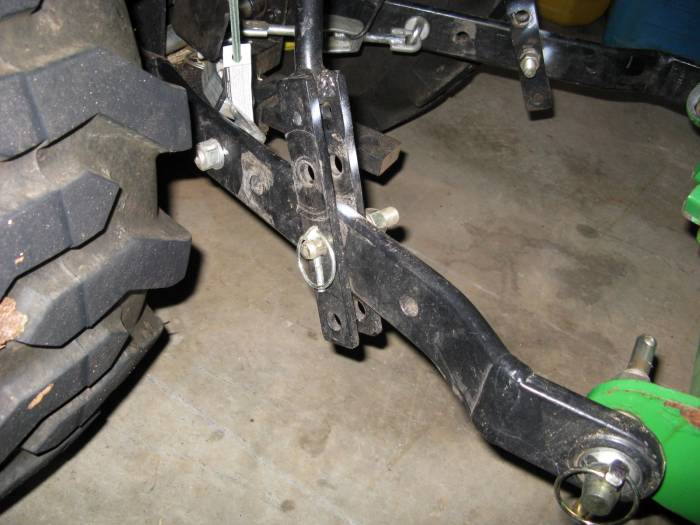

If you move pin from LOWER hole on left and right Lifting Rod stirrups to TOP hole on left and right Lifting Rod stirrups, your three point hitch will lift approximately five inches higher at the Bull's Eyes.
Is 5" of additional lift going to give you what you need?

BigTiller got it right, by noticing I have no adjustment because the top hole is to small, I own a 2032R not a 2025R but the manual covers both models, so the 2025R has lift and capacity adjustments and the 2032R does not.
