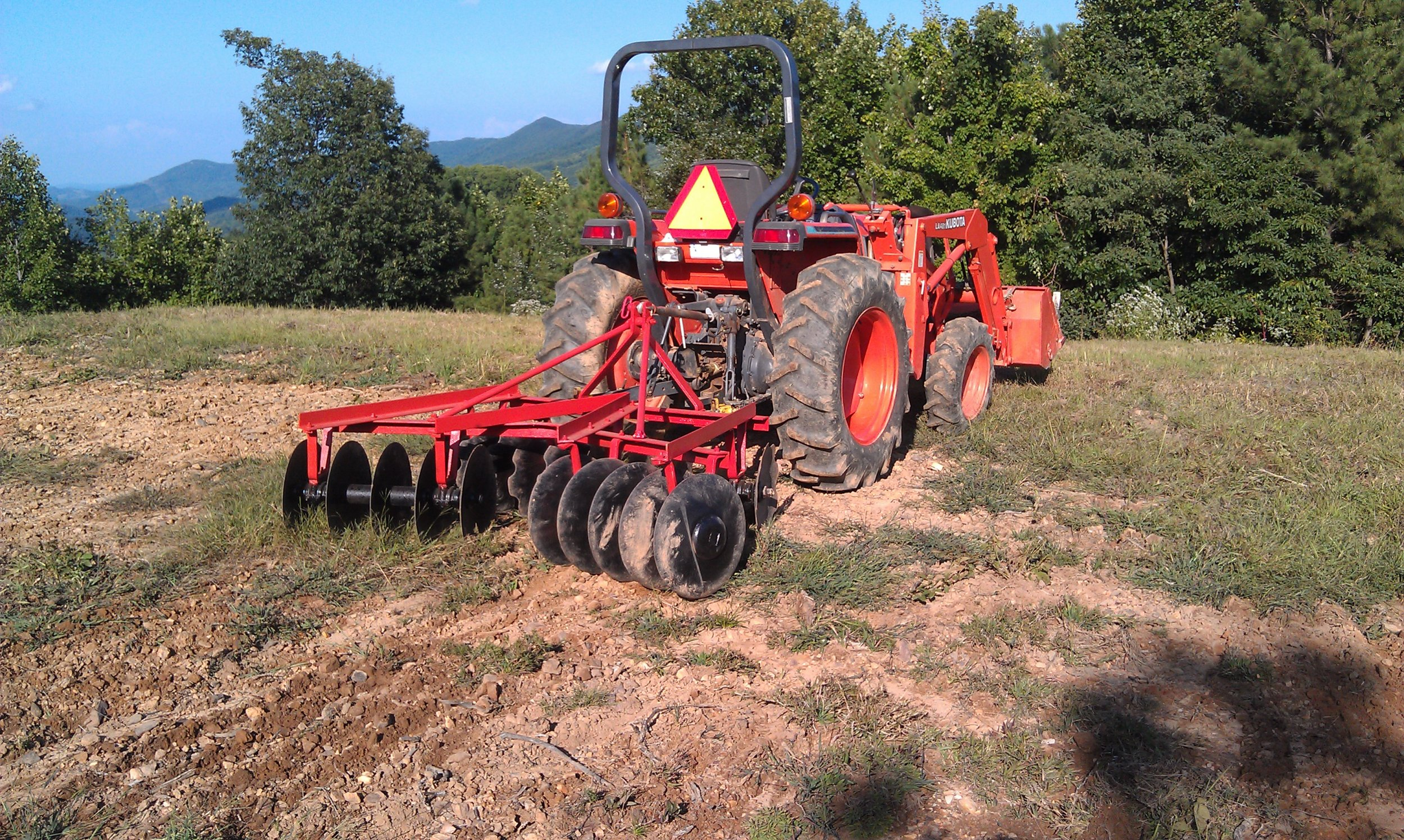

Guys, it's "disking" time for my food plots. As usual they're grown up with tall thin wiry grass and weeds in general.
I bush hog but the wiry stuff just lays down and doesn't cut.:mad: Then I hook up my very heavy disk and roll, roll, roll. I recently read an article about disk blade angle. I returned to my disk and.....they're welded in place, no adjustment.
Soooo, advice on ALTERING my disk or selling it and buying a different adjustable angle disk.......Please advise. Thanks

Disking is a secondary tool most of the time. The idea of plowing a food plot is not what most people do.
For your problem I would try to add some more weight to your disk before I spent money for a new one. Lay a railroad tie or a log across the disk to see if it improves the ability to cut. Use a #9 wire or similar to tie the log on.
Also you might try shorting the top link to make the front gang cut better. Then flatten the dick back out to smooth the plot on a second or third pass.

My tillage experience would lead me to believe disc angle would not help. I know of some people have sharpened the disc. Some crop residue could be managed by flattening and uniform angle to help tillage tool cut. But in this case , cutting residue better first would be most effective. Get mowing several times beforehand, a flail mower or most effective, use roundup. Its a safe and effective solution.

2) Pin the INBOARD end of your Top Link into a lower set of the paired Position Control holes. Lower positioning of the inboard end of the Top Link will raise the rear of the Disc a little higher.
Thanks Jeff, I do keep the upper link short to put most of the weight on the front cutters but I never thought of moving the link pin. Great idea. Thanks again. I love this website, there are hundreds (thousands) of people with more experience than I. 🙂🥰

From looking at your ground in your photo of your disc and tractor, you have 2 major obstacles you need to deal with before using your disc. 1st and foremost is the height of your grass/weeds.
1st & Foremost is a deliberate word choice—realize that your 3ph’s only down pressure is the weight of the implement. The weeds cause the disc blades to act more as wheels than blades keeping the disc on the surface. Mown short 3” will continue to be a battle for a disc. I will come back to this in a bit.
2nd issue you have is a 2fold one. You have hard packed soil and rocks. Both of these factors limit your penetration of the ground even after the the grass/weeds are dealt with.
Recommendations:
You can do chemicals to deal with the grass, but the chemicals will do nothing (or less) for your hard-pack and rocks.
You need a plow!
I suggest a single bottom plow (in hard pack, your 3032 is going to struggle from both a HP and weight/traction with a 2 bottom plow) and skip the chemicals. The bottom plow will turn the soil including the roots of the grass/weeds from bottom to top. (Use some caution with the depth if the bottom plow as you want top soil to remain on top—this may or may not be an issue in your area. However, I know it is a major concern in the western/central NC area with the heavy clay in the area my son lives in,)
There are other types of plows, but the bottom plow does the best job of turning the roots up to kill the grass and weeds. They will decay adding nutrients to your soil. Following the plowing , you can disc (I recommend at 90 and 45 degrees from direction of plowing in that order. Remember you are not looking for a lawn finished product, just soil loose enough for seed to take root. A cultipacker is a great tool and one you may want to add, but a light hand ranking has worked great for years for lawns after broadcast seeding. A very light discing can be done as well.
One last point—most areas have a relatively thin layer of top soil so 6-8” of penetration is ad deep ad you ever want to go, in hard pack you may only get to 4-6”. I would guess from what I could see in your photo of your disc, you are only getting 2-3” max.

Cut your grass/weeds as closely as you can (at least 3-4” high) then use the fire out of that single bottom plow in the picture. It is difficult to avoid weed seeds, but buried at 6-8” (your plow should turn 6” of soil with little difficulty) the seed should be too deep to ever grow. Once turned with the plow, make multi passes with your disc harrow until you achieve results you want in soil condition. Do your passes at 90 and 45 degrees to the plow direction. This should allow 3 passes in differing directions to the plow direction. As long as you watch the wetness of your soil conditions, this will probably be as much tillage as needed.
You may need to follow this tillage process for a few years till just discing will provide acceptable results. Number of years depends upon soil conditions. The organic material (weeds and grass) will provide nutrients to your soil.
