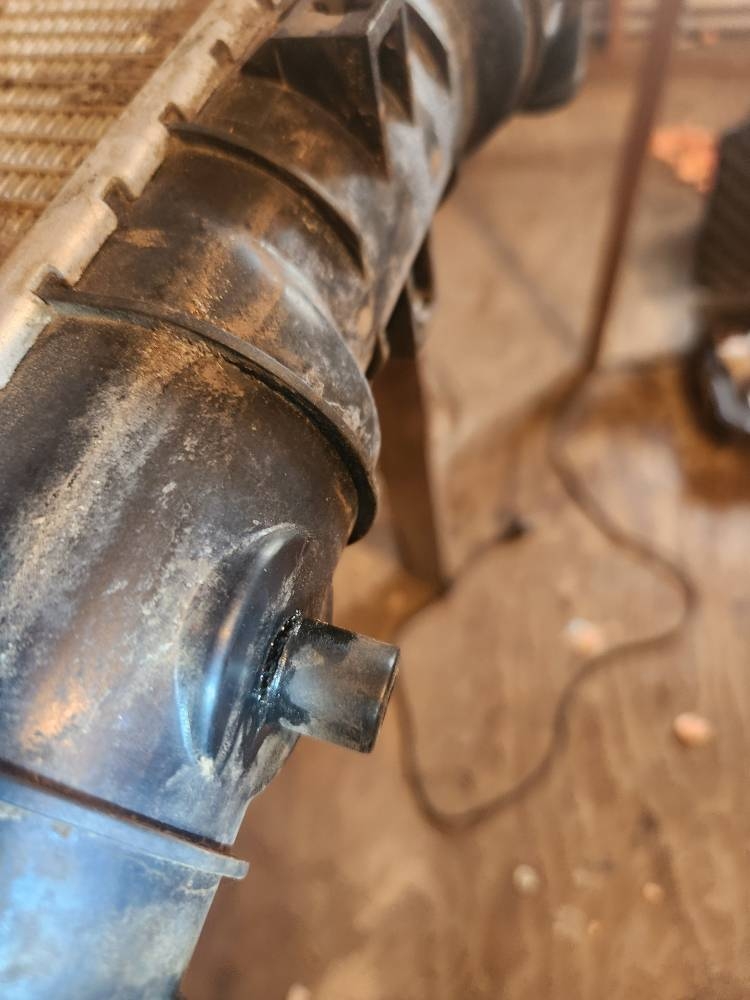

What adhesive, epoxy, plastic weld, ect, would be a good product on the nylon portion of a radiator? It's not a puncture, it got hit, and cracked where a bottom "peg" attaches to the tank.
It's actually odd, funny, ironic? But I was backing up, and the way a rear tire lifted a limb, smacking the bottom right of the rear of the radiator. New radiator is $600, so that's not gonna happen. I actually assumed it was the smaller, lower radiator hose, as I've seen multiple reports of that being a weak point, but in my case, that's not the issue.

Pictures of the damaged area

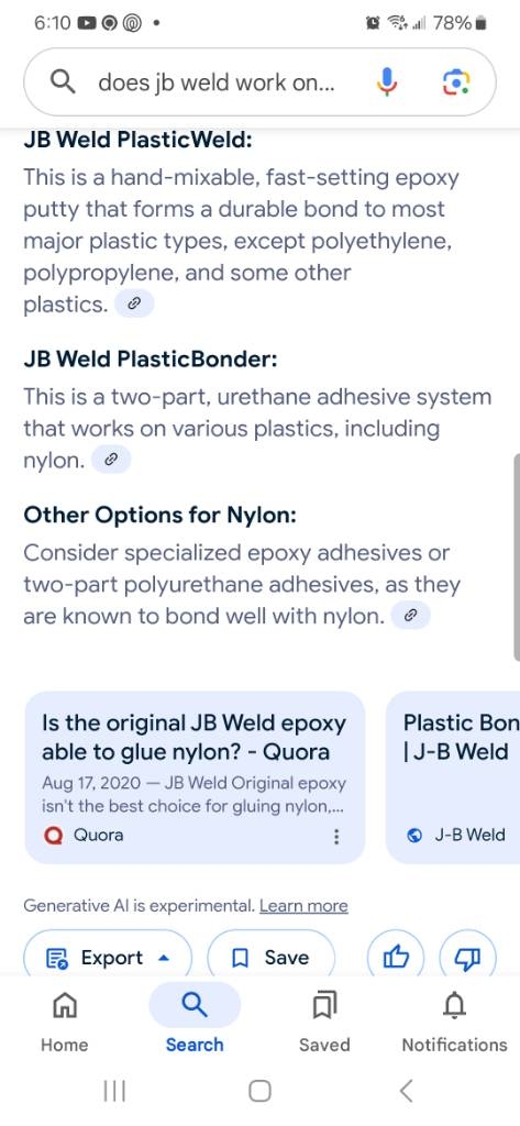

I've seen reports for super glue, cylo-something, but typically super glue doesn't hold up to high temps, also not sure if the liquid part is good, to get down in the crack, or build up; or maybe high temp super glue in the crack, with JB on top, maybe?

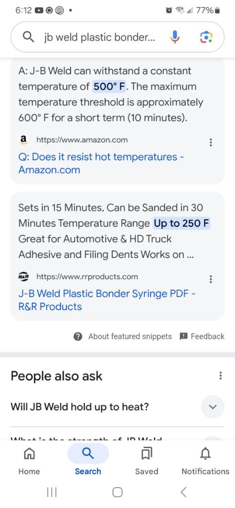

Looks like JB Weld, Plastic Bonder, is likely worth a try. It says it does bond to nylon, and is rated to 250 degrees F.

I am not sure if this is a wise repair.
The plastic peg is a high stress area, hence why it broke from the impact. A complete failure in this area will drain the radiator very quickly. If not noticed it could lead to the engine rapidly overheating. An engine is darned expensive. I would replace the radiator as a failure could be catastrophic. I am risk adverse so I would not do this if it was my tractor.

That's what I think as well - though I am not convinced that tank is nylon. It may be some sort of polypropylene - since that is a type of plastic popular for hot water systems. At a minimum you would want to find out exactly what type of plastic it is, and then probably look at making some reinforcement for that joint using commercial adhesives - not hardware store plastic cements.
Even if it is polypro, hot water in a house isn't nearly as hot as a a radiator has to deal with. And to make it worse, that break isn't a slip joint with lots of surface area at the break, it's a butt joint right in the wrong direction to hold pressure. To stand a chance of working for a while, It needs lots of surface area.
The trouble I have with this repair is that most of the ideas in this thread would work for a little while - good enough to finish a job or maybe a season. But when it fails you don't just lose the coolant, you could lose a diesel engine.
Bottom line is I don't see a decent radiator repair. You might want to look at aftermarket generic replacement radiators. Maybe Google replacement compact tractor radiators.

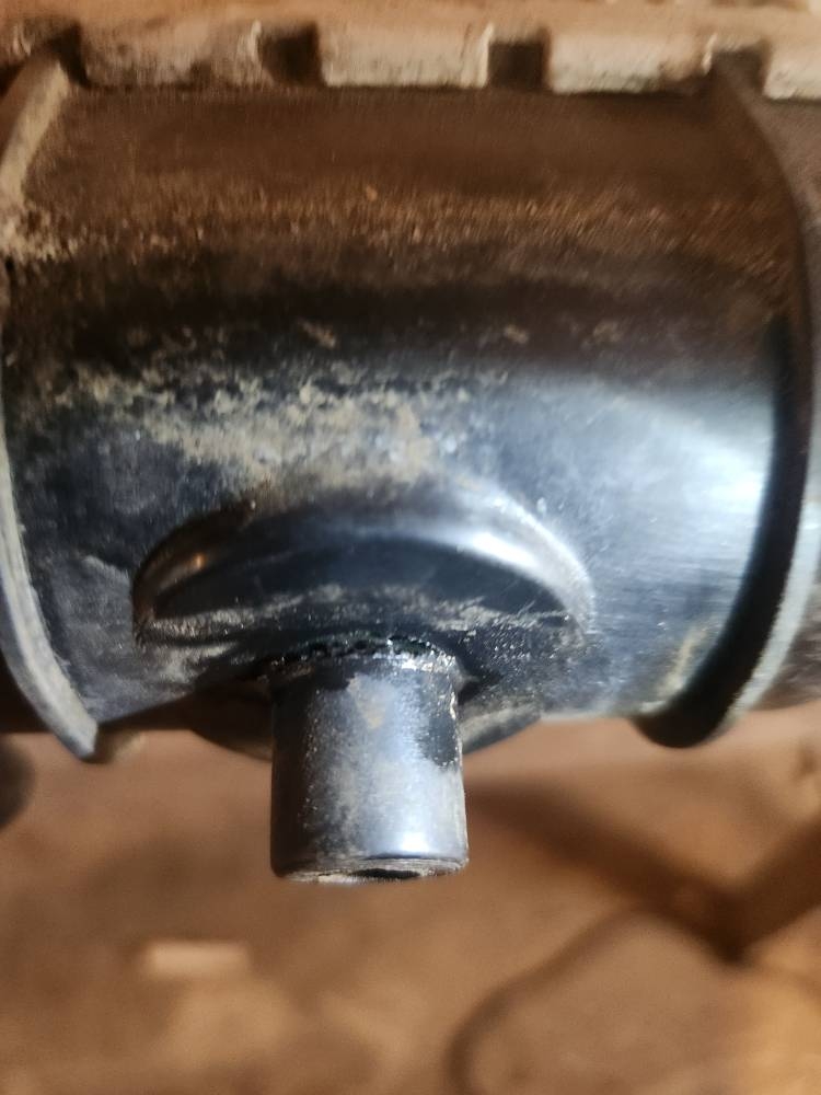

Make sure you rough the surface with a small burr. Texture will help the bond stick. I can't suggest a material. But I would fill that into a gusset bond. Applying JB weld thin doesn't work well.
That is a high stress point. It's almost broke off. I don't know if its thick enough to remove the nipple and tap it with NTP tap and screw in a nipple.
Even if you only had a thread or two all the way around the diameter holding it could be stronger than just filling a crack.
Then fill with epoxy or plastic weld for stiffening as suggested. I can't think of a fitting that would replace the nipple.
Whatever you do after you clamp your hose put a strain relief on your hose so its not getting pulled to the side.
Maybe a guard also.

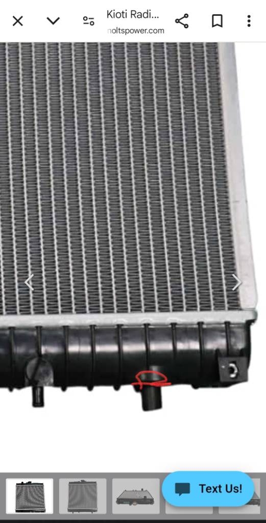

Find out the part number for the radiator and google it. I use the format "xxxxxx Kioti" or "xxxxxx radiator" and usually get good results. If you come up with alternate/updated part numbers, make sure you google those too. Sometimes that gives better results than the original part number. If you can find an after market replacement I'm thinking the price will be around $200. That's my guess. Good luck.
