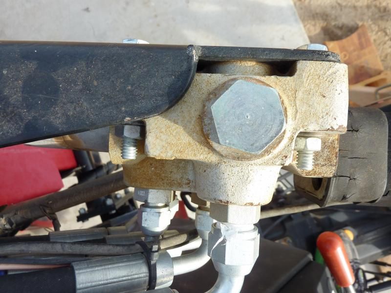

I'm looking for a bit of help. I have searched and found quite a bit of info but want to make sure I get this right.
I would like to add a top and tilt to my Yanmar FX28. I have a loader on it and will post pictures of my existing set up.
this is a picture of my loader valve, I'm thinking a power beyond could go in the top port which is not being used?

How is your flow path? Point to point.
Is it from the pump to the loader then to the 3pt?
If the loader valve is feeding the 3pt now, then you can assume that the loader valve has a PB port.
Do you have six or seven hoses on the loader valve?
If you have PB coming to the 3pt now, then you can interrupt the flow at the 3pt for the remote valves for the T-N-T.

Logically speaking, a loader valve will have 7 ports.
In port = supply in
Tank port = cyl flow out
2 work ports for in and out for each cyl. total of 4

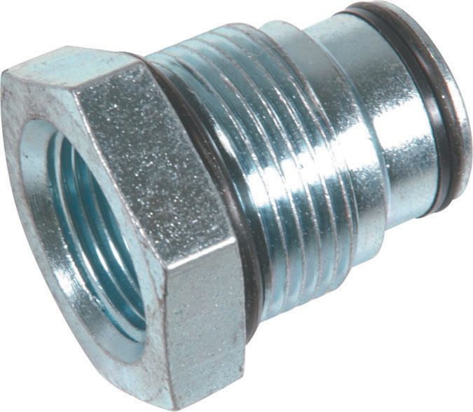

PB port with adapter = flow for the next valve.
It looks like someone got lazy and and connected the tank port back to the hyd block.
Normally the PB connection will feed the hyd block or the 3pt.
Most tank ports go to a tank line and is low pressure.
Most tank ports have a limited psi rating of about 500 psi.
Did you find the manufacturer of the valve?
You could remove the large hex plug and show a picture of the inside.
What you are looking for is a port that will accept something like this adapter to make the port a PB port.

I think that what you are calling an I is actually a T for (tank) and is the out going port. More than likely the top port is a power beyond port. You will probably need some sort of power beyond adapter to be able to make use of that port.

Looks like the valve is from Pace Manufacturing if you zoom up on the one picture. Valve looks very similar to a Brand Hydraulics joystick so the power beyond would be on the top.

JJ keeps asking, so here is the manufacturer of the valve, from your picture.
